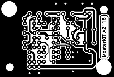

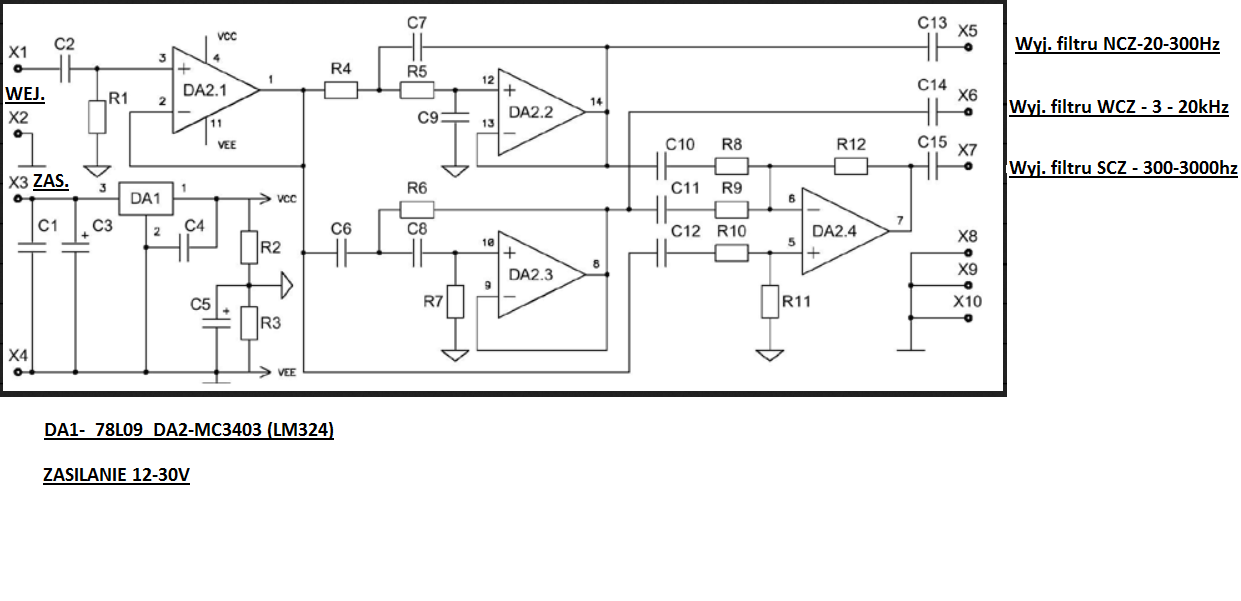

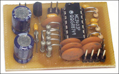

    It may make sense to use filters for separate three power tips. If you are interested in the diagram, I will put out the nominal values of the elements and PCBs. Simple Adjustable Low-Pass Filter: 12V/5V Power, Dual 50k Potentiometer - Diagrams Needed

  • #8 16227351
    jarek_lnx
    Posts: 22737
    Help: 4199
    Rate: 6128
    There are two requirements, the first is not to lead to the loudspeaker signals that can damage it, the second - more important for the listeners, how to connect the bands of different speakers so that they work together, the bands must connect so that there is no "hole" or "hill" and that the phase in the transition zone, it matched.

    Dear colleague! The amplifiers indicated in the diagram are located in 1 housing. Simple Adjustable Low-Pass Filter: 12V/5V Power, Dual 50k Potentiometer - Diagrams Needed

    Colleague, jarek_lnx! Yes, I am to the author of the topic and I recommend an analogous scheme, just simpler, taking into account what my colleague - a beginner.
    Added after 3 [minutes]:
    It's easier for the fact that I put out, there can only be passive filters.
    Added after 4 [minutes]:
    Simple Adjustable Low-Pass Filter: 12V/5V Power, Dual 50k Potentiometer - Diagrams Needed Simple Adjustable Low-Pass Filter: 12V/5V Power, Dual 50k Potentiometer - Diagrams Needed
