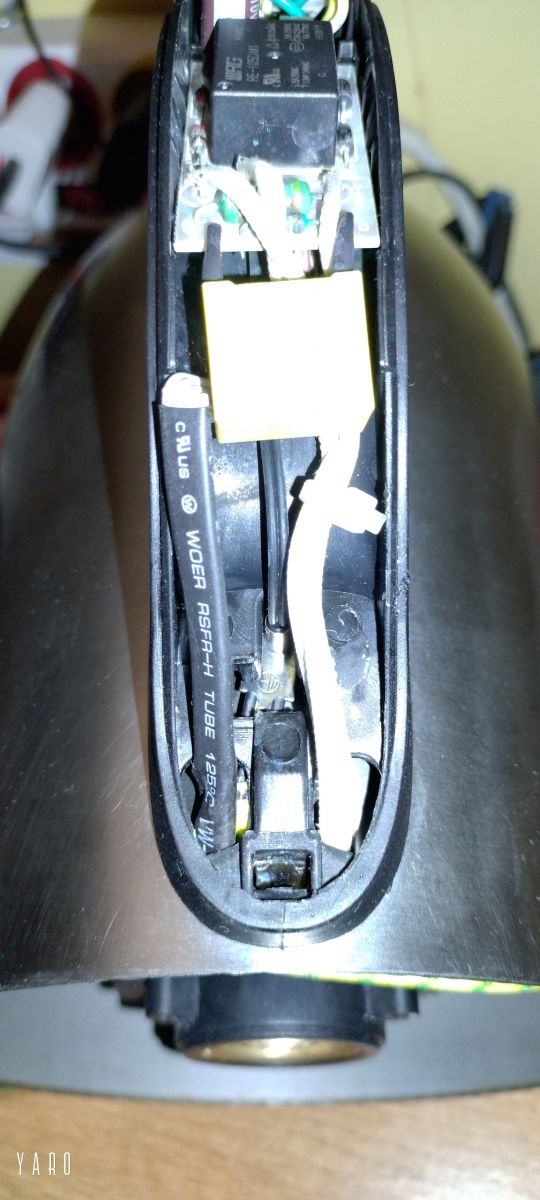

  • #1 16757873
    kulonrobert

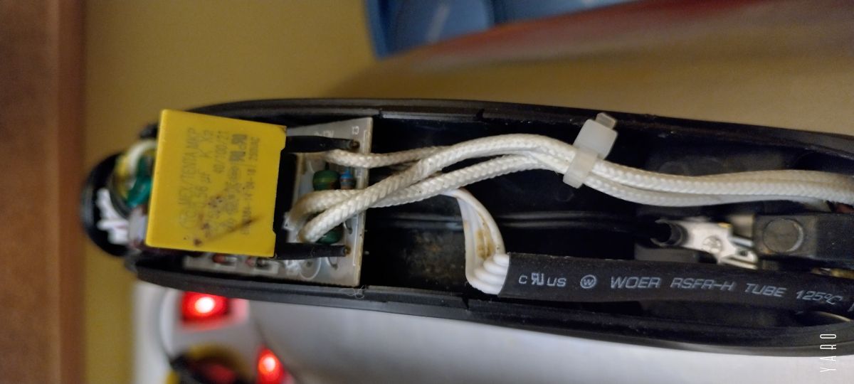

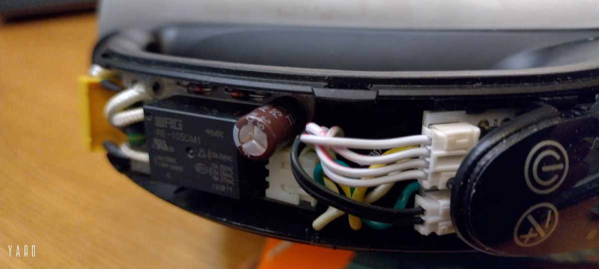

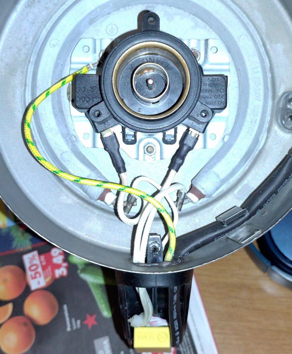

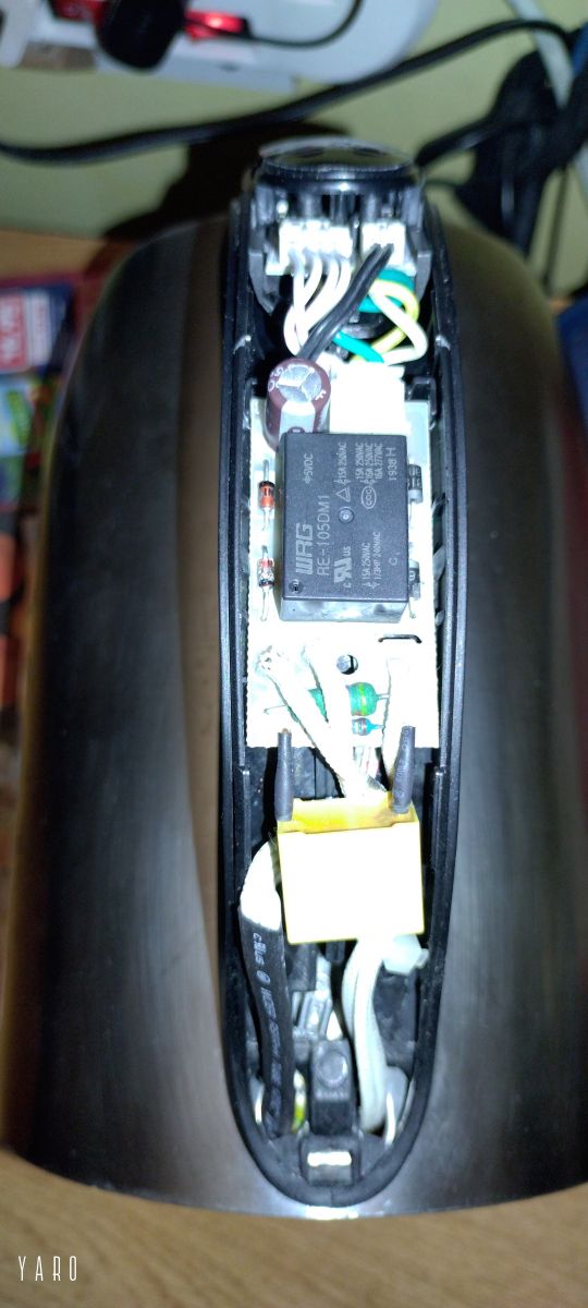

    Hello, I have a little problem with the Hoffen EK-6144-16 electric kettle with temperature control. It squeaks when the kettle is put back on the base or after proper cooking has finished. It stops squeaking only after being pulled from the station - earlier, after boiling the water, it turned off and stood at the station without squeaking. What could be the reason where to start some checks / measurements?

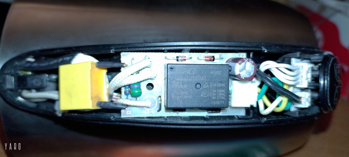

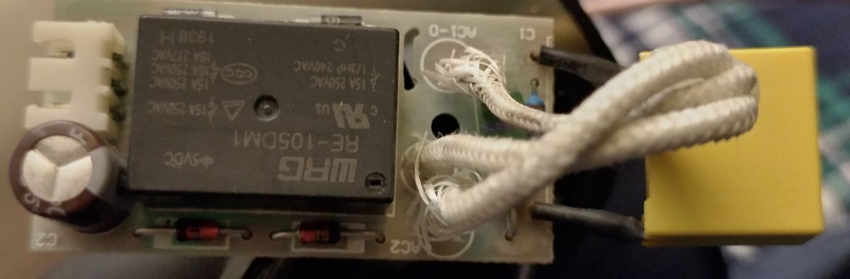

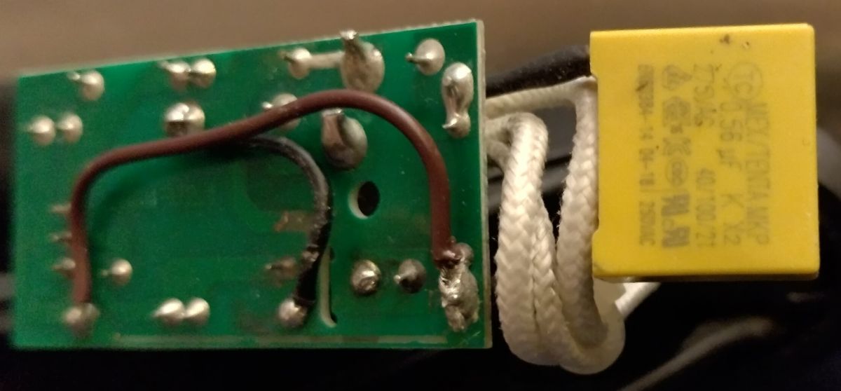

    In my case, the reason for this behavior of the kettle was the loss of capacitance 0.56 uF 275V ~.
    It had only 0.2 uF and after replacing it with a new one, the kettle started to work properly.
    Very often, in devices with power supplies of this type, the cause of incorrect operation is the loss of capacitance in series capacitors.

    I put in another one with a slightly smaller capacity (0.48 uF) and it works.

    Thank you for the hint.
    Also I had only 0.47uF available
    I changed it and it works beautifully. Effective hint.!

    In my store, I also got 0.47 uF and in my case I also used one.
    I found a 0.56 uF capacitor (with dimensions such that it would fit) on TME, but I had to buy a few of them and that's why I used 0.47 uF. Capacitors in such transformerless power supplies must be of good quality and with a voltage of min. 275V ~ or 630V- (preferably at least class X2), because in the event of a breakdown, the entire system powered by it will be destroyed.

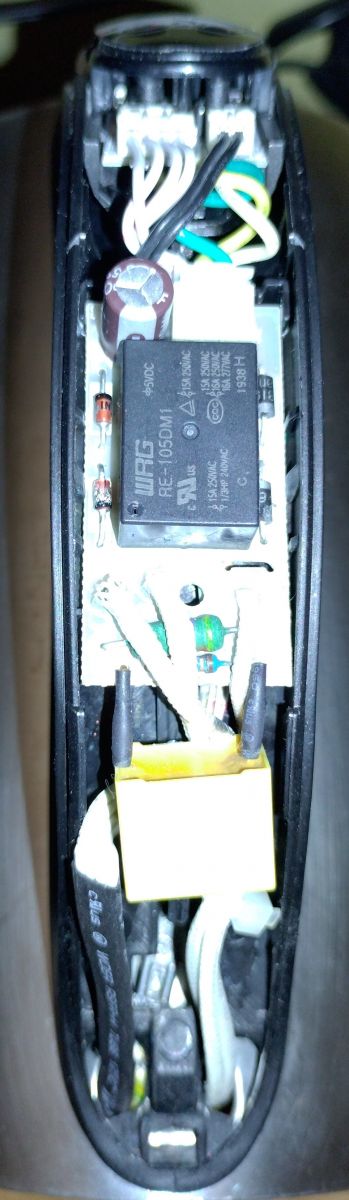

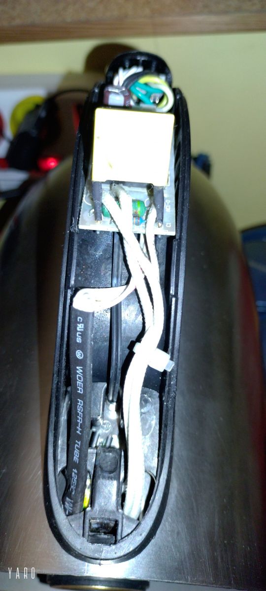

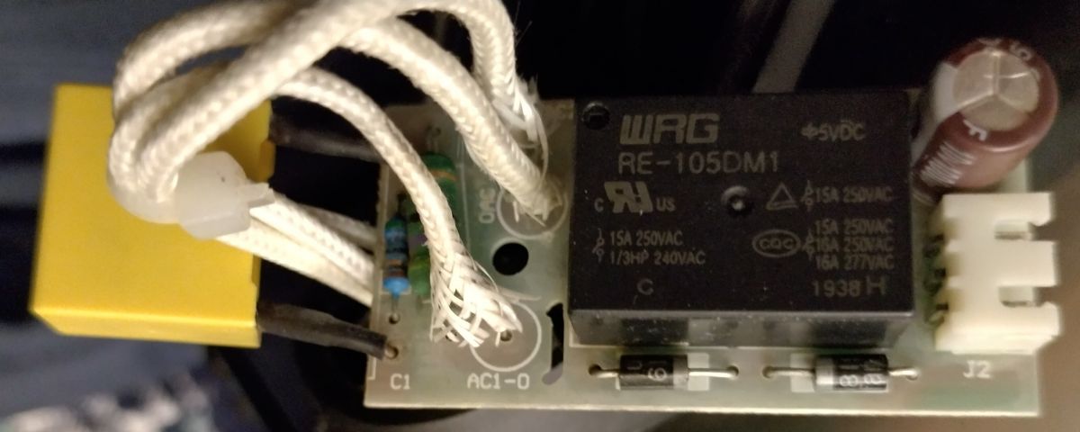

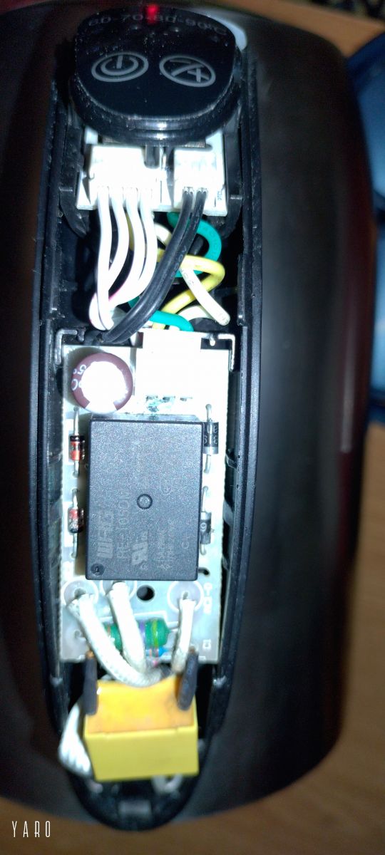

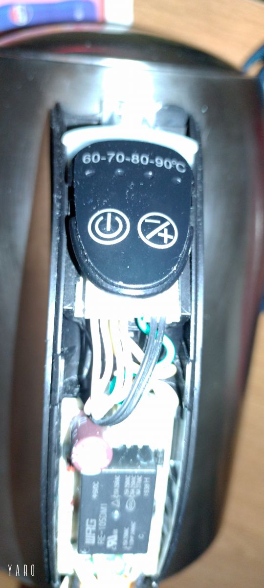

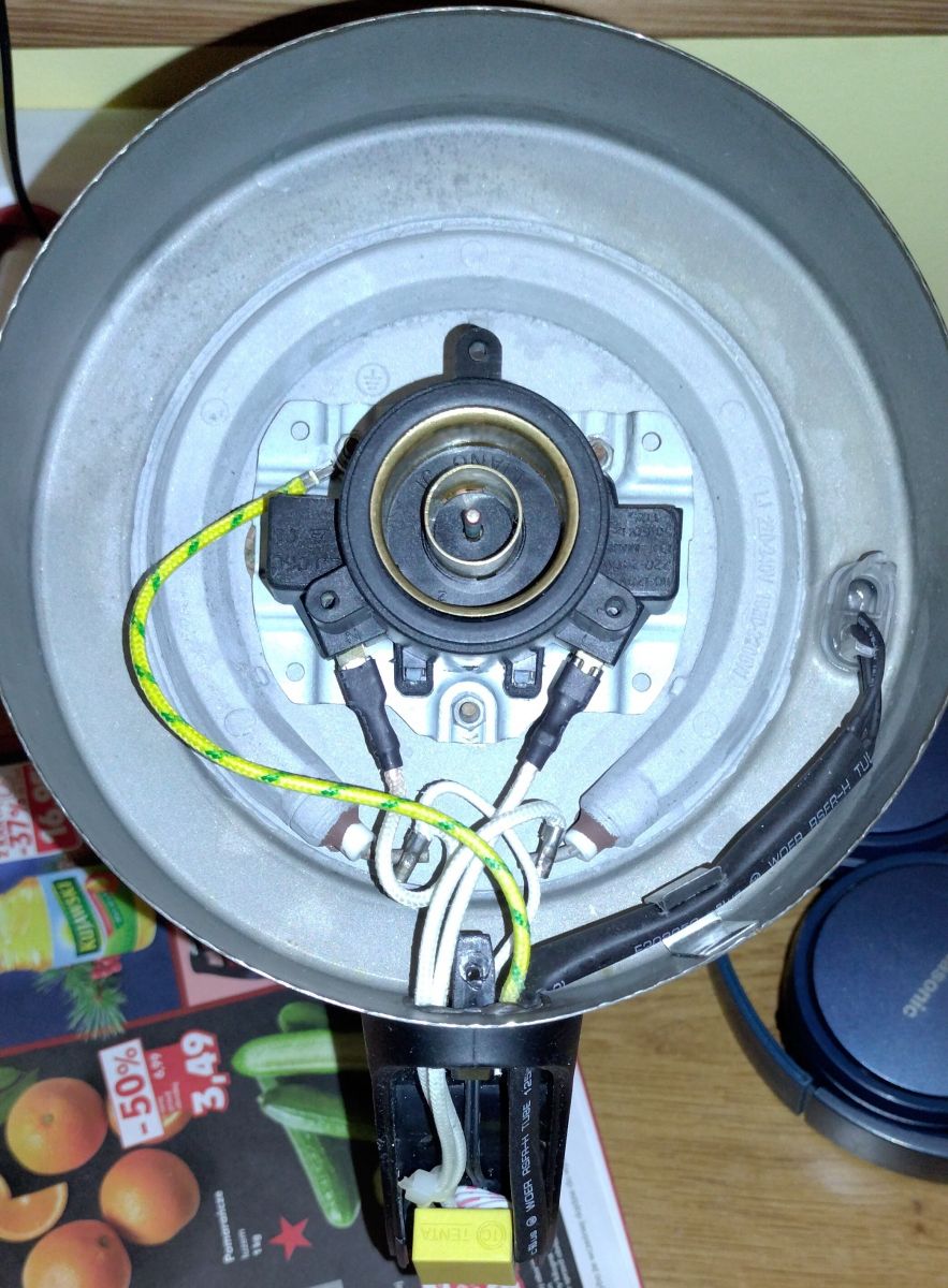

    I am now repairing the AEG kettle. It also squeaks when inserted into the stand and does not start. The capacitors look healthy.
    I'll check them with a meter. Maybe check something else?
    The capacitors are operational. Relay? Thermostat? Which is the thermostat. Or maybe there is no thermostat and everything is controlled by a microprocessor.
    I check the temperature sensor with a meter and it shows nothing. Meter set to ohm.
    After disconnecting the temperature sensor, the kettle reacts the same. It squeaks and nothing else.
    • Hoffen EK-6144-16 - the electric kettle squeaks when put "on the station &a IMG_20181227_180311.jpg (6.84 MB) You must be logged in to download this attachment.
  • #9 17663641
    piotrje2
    Rate: 8

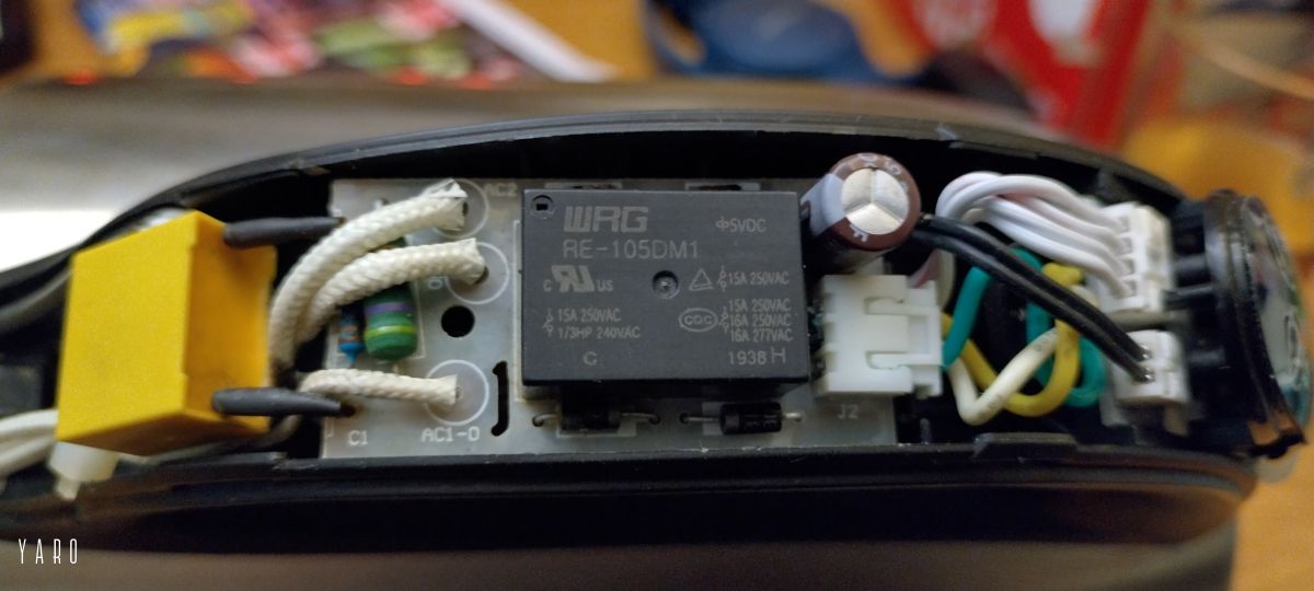

    First, I would check the capacity, or immediately replace the yellow capacitor at the bottom of the photo with a new one.
    In kettles with electronic control (apart from protection against overheating) there is no typical thermostat, and the heater is turned on by a relay or a triac.
  • #10 17663726
    gruniu
    Posts: 929
    Rate: 178
    The capacitor (yellow) is OK. I checked before.

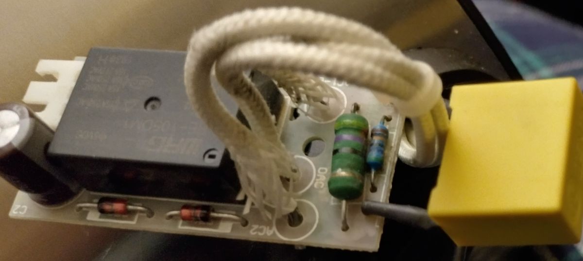

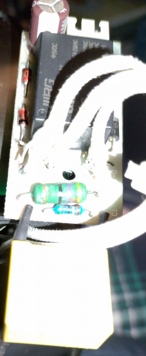

  • #11 18509388

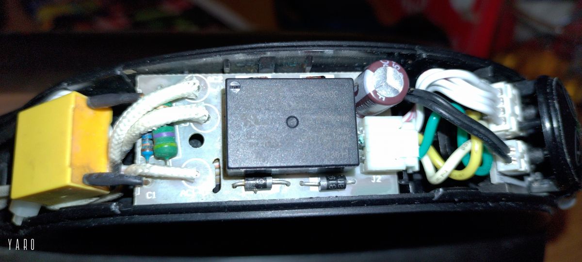

    ahaho3
    Posts: 34

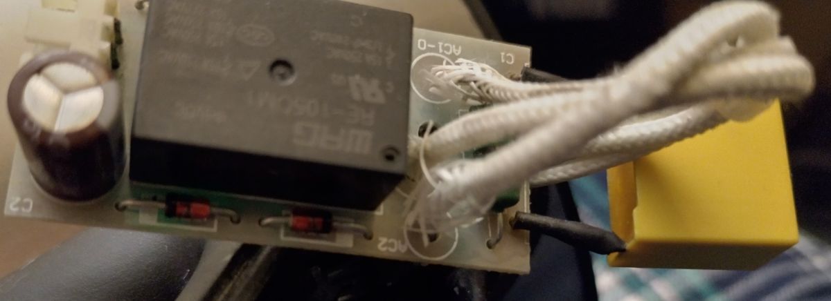

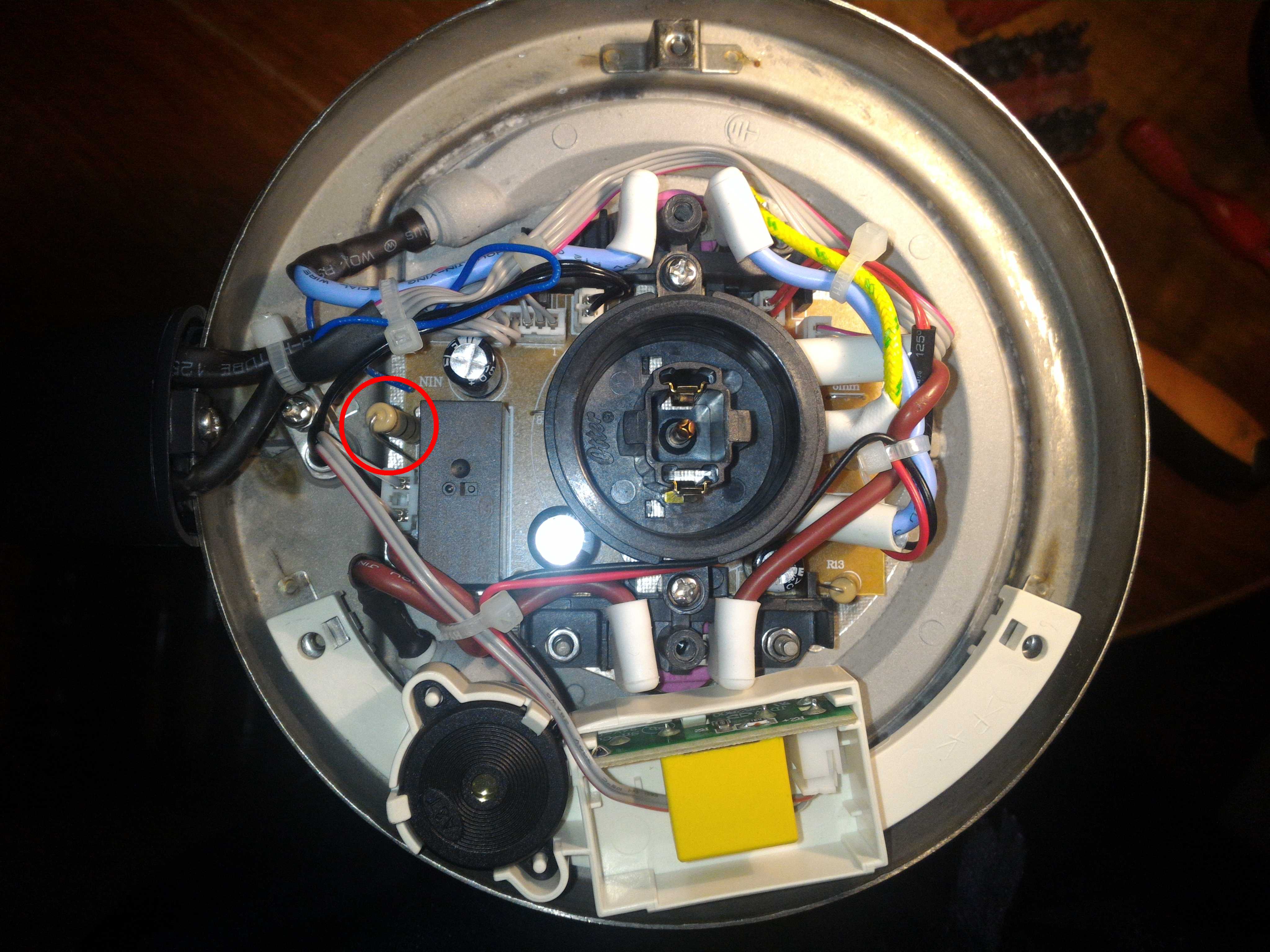

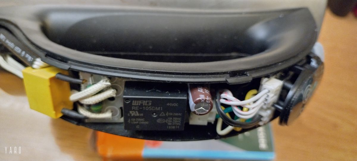

    As a result of the short circuit, I burned the resistor marked in the photo (borrowed from a colleague gruniu) with the circle.
    I am not able to read its resistance (bar markings) because it fell apart
    Markings that I am able to read:
    1 - green (100% sure)
    2 - brown / purple (not sure)
    3 - I don't know
    4 - zloty (100% certainty)
    Maybe you can give me the markings (resistance) because in the original photo (enlarged) I am not 100% sure what I see

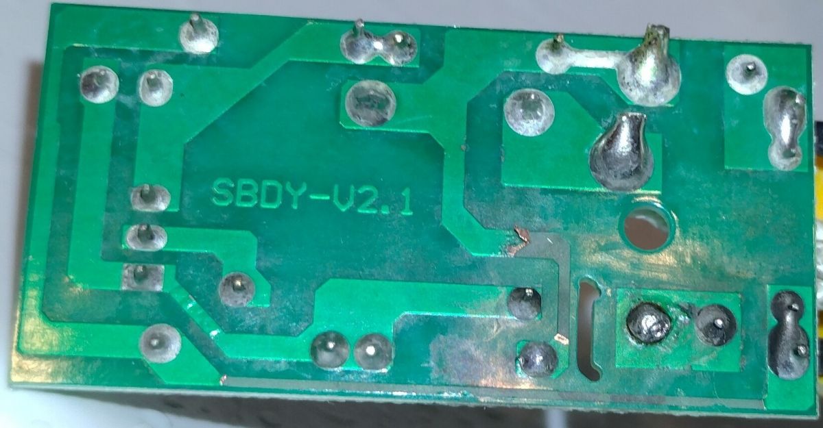

  • #12 21343791
    adamnurek137

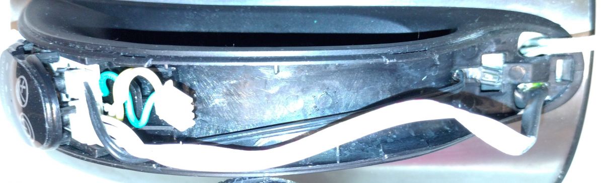

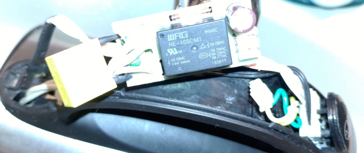

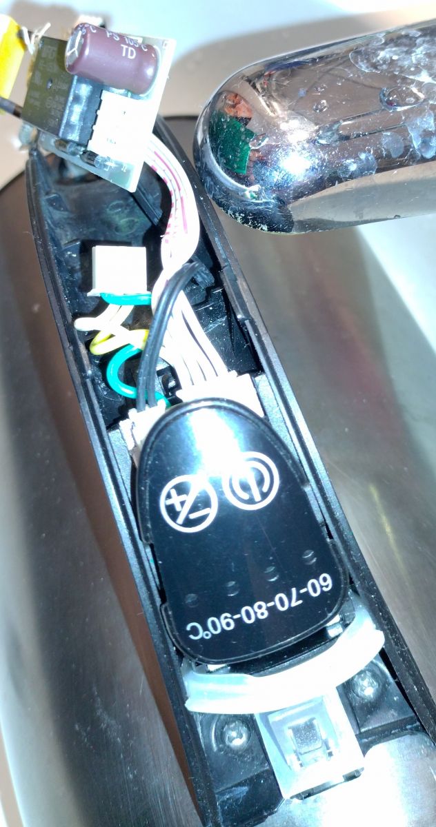

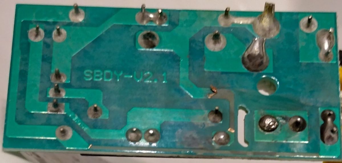

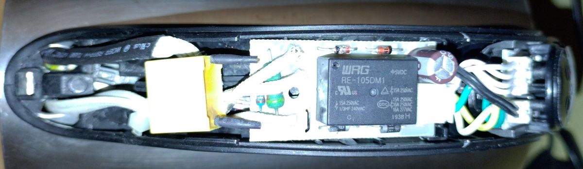

    Base of a metal Hoffek AK3502 electric kettle with a temperature display and buttons. Interior of a metal Hoffek AK3502 kettle, showing part of the inner surface and a mounting component. Close-up of the interior of a Hoffek AK3502 electric kettle showing the button and wires. Image of the inside of an electric kettle showing its components. Close-up of the interior of a Hoffek AK3502 electric kettle showing electronic components. Close-up of the interior of a Hoffek AK3502 electric kettle showing electronic components. Interior of an electric kettle with visible electronic components, including a capacitor and wires. Interior of an electric kettle with visible electronic components. Close-up of electrical components inside a Hoffek AK3502 kettle. Image of a circuit board marked SBDY-V2.1, showing visible damage to the traces. Printed circuit board with damaged traces and marking SBDY-V2.1. Close-up of electrical components inside a Hoffek AK3502 kettle. Image of a circuit board marked SBDY-V2.1, showing visible damage to the traces. Printed circuit board with damaged traces and marking SBDY-V2.1. View of the interior of an electric kettle Hoffek AK3502 with exposed components. View of the interior of a Hoffek AK3502 electric kettle base with damaged components. Inside of a Hoffek AK3502 electric kettle with exposed components. Close-up of the internal components of the Hoffek AK3502 kettle with tracks and wires. View of the interior components of a Hoffek AK3502 electric kettle with exposed electronic parts. Inside of a Hoffek AK3502 electric kettle with exposed components. Close-up of the internal components of the Hoffek AK3502 kettle with tracks and wires. View of the interior components of a Hoffek AK3502 electric kettle with exposed electronic parts. Disassembled Hoffek AK3502 electric kettle showing internal wires and components. Close-up of the internal components of a Hoffek AK3502 kettle, showing a relay and various wires. Close-up of electric kettle components showing wires and a circuit board with electronic elements. Interior of Hoffek AK3502 kettle showing electrical connections and a capacitor. [img-22] Interior of a damaged electric kettle showing electronic components. Close-up of the interior of a damaged Hoffek AK3502 electric kettle showing electronic components. View of the interior of a Hoffek AK3502 kettle with visible electrical components. Internal view of a disassembled Hoffek AK3502 kettle showing electronic components. Interior view of the Hoffek AK3502 kettle with a temperature dial and visible electronic components. Image of an electrical component of a Hoffek AK3502 kettle showing a relay and wires. Interior of the Hoffek AK3502 electric kettle with visible electronics and wiring. Hello, I have such a kettle Hoffek AK3502,
    and does not work, it was making a short circuit stopped working, after disassembly it turned out that the tracks are burned, after soldering the wires , still does not work, I will replace the capacitor will see in a while, below the photos of the components.... The image shows an internal component of a Hoffek AK3502 electric kettle, displaying burned tracks on the circuit board. Image of the circuit board from a Hoffek AK3502 kettle with visible electronic components. Close-up of an electronic circuit board with various components, including capacitors and wires. Close-up of an electric circuit board from a kettle with visible wires, capacitor, and relay. Close-up of an electric circuit board from a kettle with visible wires, capacitor, and relay. Close-up of a circuit board with components from the Hoffek AK3502 kettle. Image of components from a Hoffek AK3502 kettle showing repairs on the circuit board. Image of components from a Hoffek AK3502 kettle showing repairs on the circuit board.
