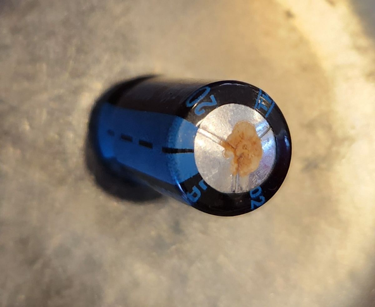

    #7 20466036
    bmegli
    Replacing the capacitor helped me too.
    Symptoms:
    - the central heating pump worked without any problems
    - an attempt to turn on the DHW pump caused "clicking" and restarting the controller.
    Depending on the configuration of the controller, exceeding 90 degrees also caused "snapping" and restarting the controller
    (emergency activation of all pumps, including HUW)
    Photo of the defective capacitor
    Jamming controller (turbo-fireplace regulator) ver. 5.2 Makroterm
