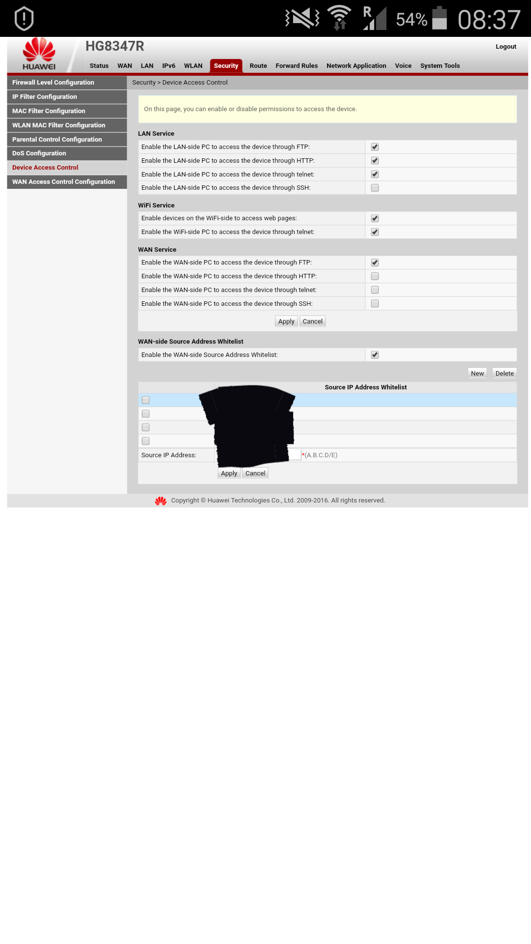

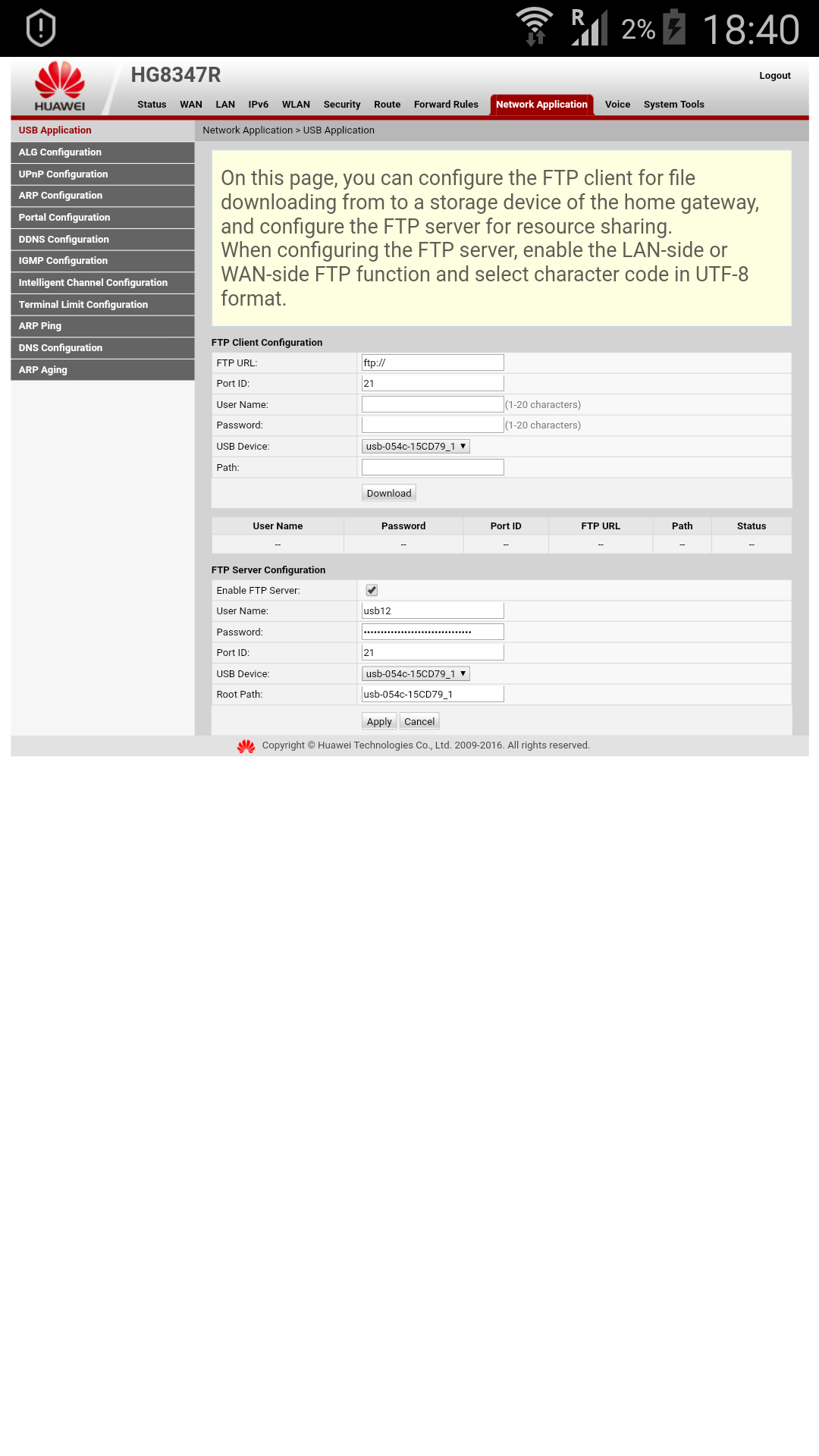

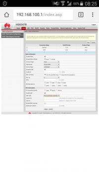

    I want to make a disk available for all devices from a 16GB USB flash drive in the router. Disk in fata32 format, I have a problem in configuring the ftp server in the router, I select the ftp server function, enter the login and password and the pendrive is still not visible on any device (the router detects the pendrive). Either I am doing something wrong or I have not set something in the router yet. So I am asking for advice.

    Enter the IP address of the router with the added port in the browser, e.g. 192x168x0x1: 21

    Practically the same as the server - give the username and password that will be required to connect to the resource, path - click Download will complete itself, ftp: // you can enter the router's IP.

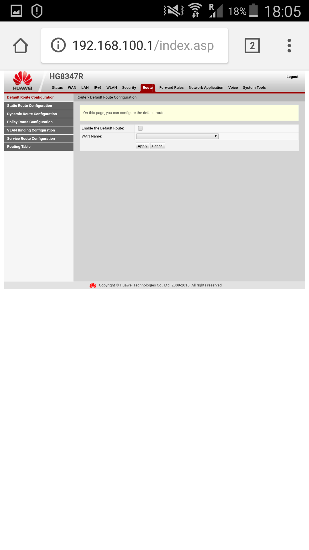

    no answer, I don't know, maybe this port is inactive somehow?

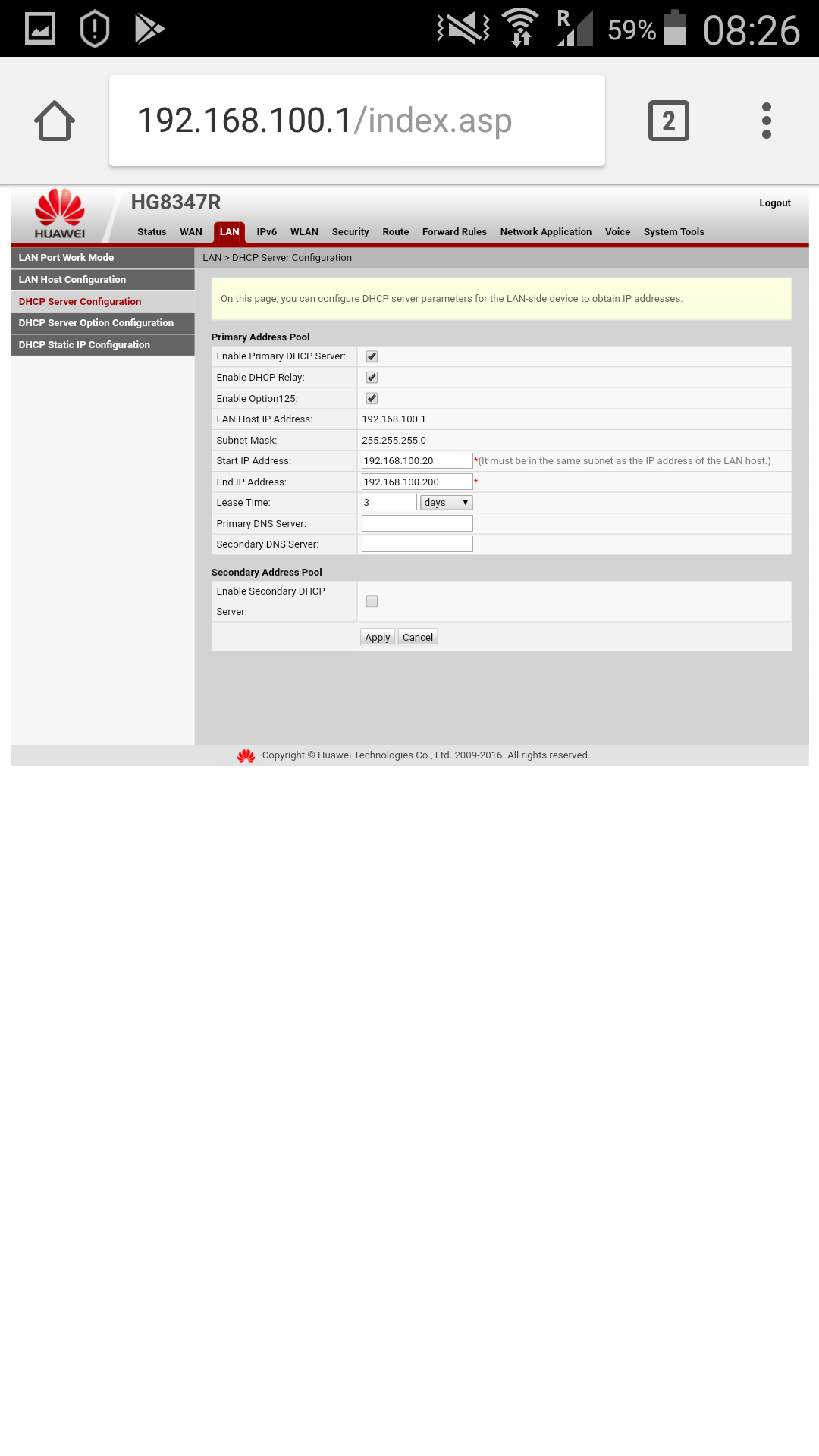

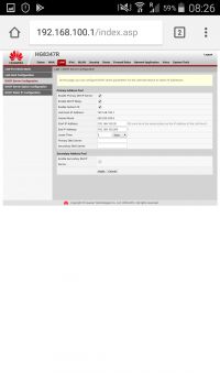

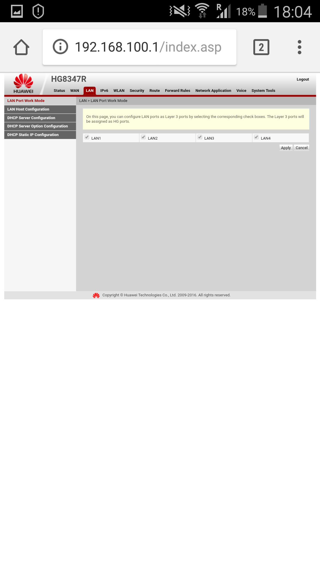

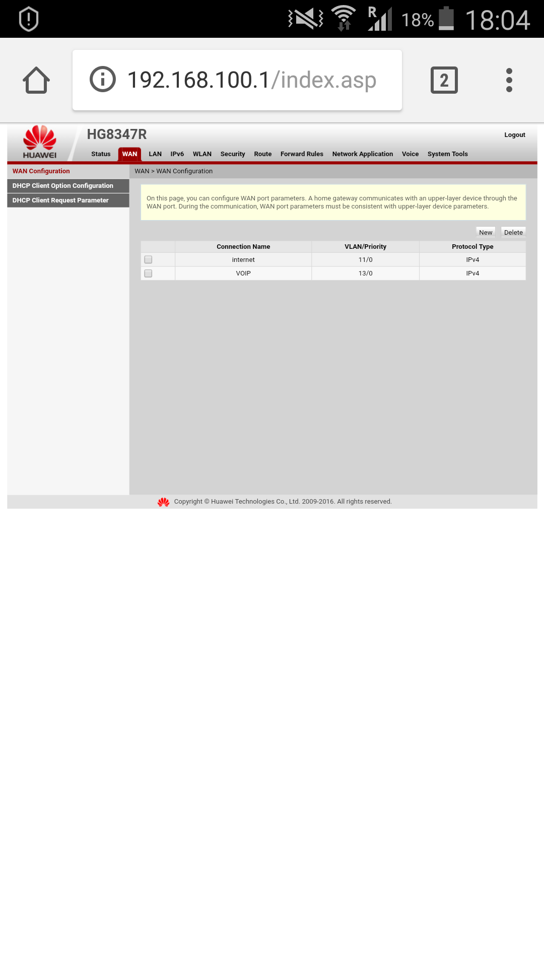

    Enter WAN and after clicking New you don't have FTP option?
    Show what's in LAN - DHSP Server Configuration.

  • #15 16765727
    Danny wx
    Posts: 84
    Rate: 7
    There is no ftp option
    Configuring FTP Server on Huawei HG8347R Router with 16GB FAT32 USB Flash Drive Configuring FTP Server on Huawei HG8347R Router with 16GB FAT32 USB Flash Drive

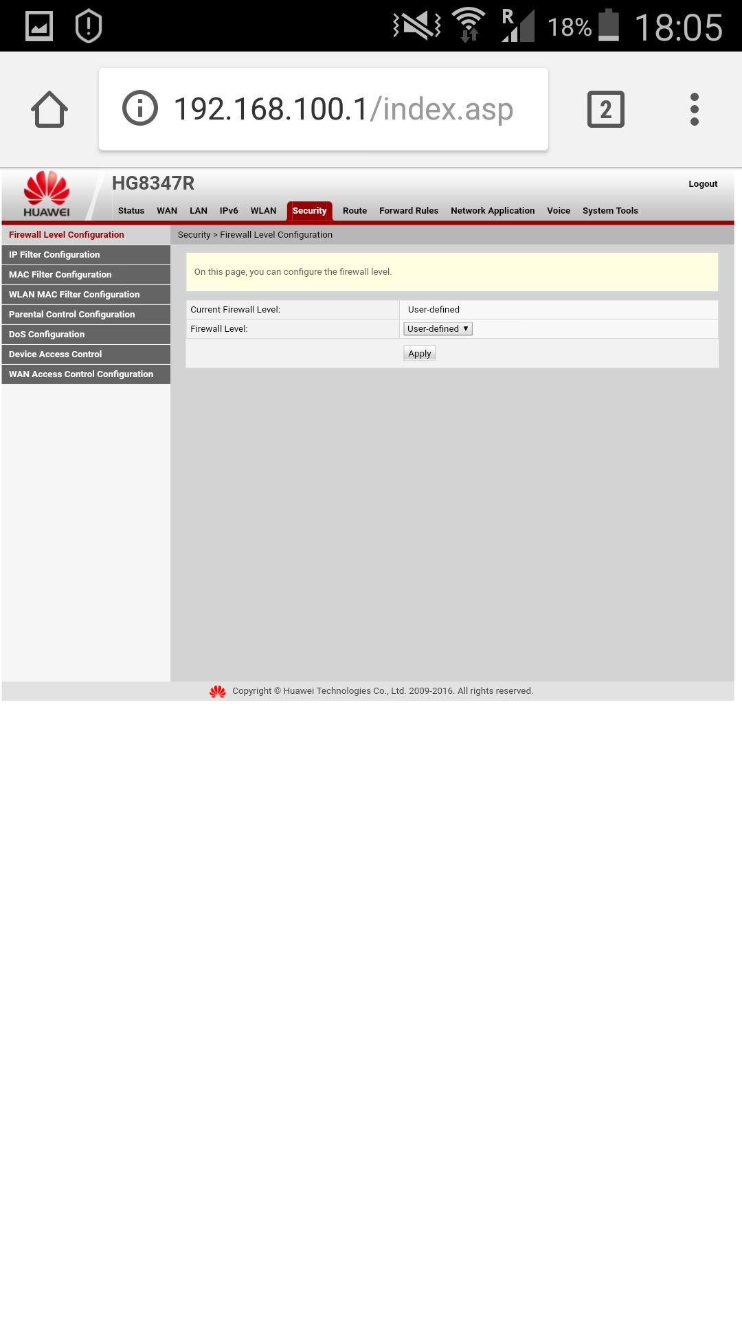

    Added after 19 [minutes]:

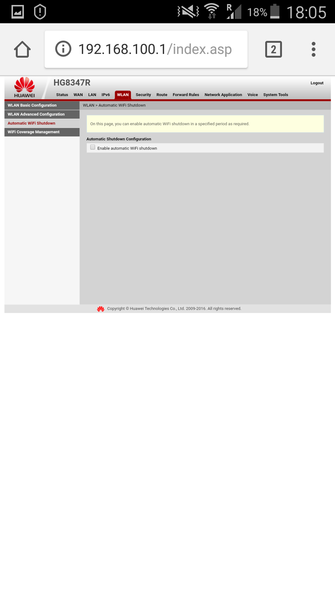

    Cramp I managed ? in the security tab I marked two points in lan and wan on ftp and it works:
