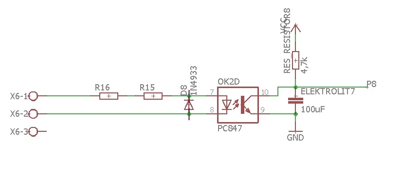

    I would like to build the simplest system that allows measuring AC voltage in the socket, so that I can read it through the ADC converter in the Atmega8 microcontroller. I want the system not to have a transformer. I would also like to have galvanic separation. At the moment, I was able to come up with something like this:
    230VAC voltage measurement with Atmega / Arduino optoisolation
    Resistors R15 and R16 are 2W and have 100kOhm each.
    P8 leads to the ADC input of the microcontroller.
    Is it possible to measure AC voltage with an accuracy of ~ 5V through this system?

    wojtek6000 wrote:
    circuit enabling the measurement of alternating voltage in the socket
    If it's alternating.
    No.
    I don't know why this 100uF capacitor. Charging via a 4k7 resistor will take a long time ...

    Hmm ... what if I gave up optoisolation and left only R15, R16 and diode? It won't be safe for a microcontroller, but will I get the desired effect then?

    You should not give up galvanic isolation. It can also be dangerous for the programmer and the computer, ending with you.
    Galvanic separation using a tiny transformer is strongly recommended here.

    So the solution that allows for a "fairly accurate" measurement of 230V alternating voltage is the system from the attachment? The resistor and capacitor would have to be selected depending on the transformer used.
    No. The circuit from the attachment measures DC voltage and not AC voltage. Why did you give diodes and a capacitor? To measure alternating voltage?
    Use one of the transformer terminals to ground the microcontroller circuit, from the other lead the diode in the direction of conduction to the microcontroller. Behind the diode, give a resistor divider so that it has a voltage drop on it that will not kill your microcontroller (0-5V + surge supply). With this system you will be able to make single-phase alternating voltage measurements. So with a diode you cut off the positive part of the sine. It is then easy to measure the frequency, effective and maximum value.
