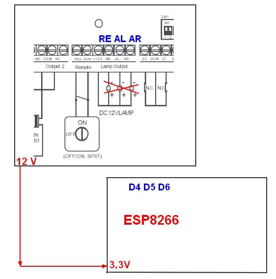

    I'm trying to connect the outputs from the alarm (standby, armed, motion detected) to the ESP8266 (later to HA), but I don't know how to do it due to the different supply voltages. The alarm outputs RE, AL, AR (lights can be connected there) are to be read on ESP inputs D4, D5, D6.
    Alarm has 12v outputs, esp 3.3v how to reconcile this? A divider on resistors alone probably won't be enough, is there any simple way to accommodate this?
    Diagram showing the connection of alarm outputs to ESP8266.
    ESP is fed from the alarm via an inverter.

    Optocouplers can be connected in place of tubes.
  • OC alarm outputs can connect directly to 3.3V inputs

    From the diagram it appears that the outputs from the alarm are OC type. If the inverter and the alarm share a common ground then you can even dispense with opto-isolation or relays Then just pull_up to 3.3V and connect directly to the alarm output.
    There is no 12V on these outputs in the active state they are shorted to ground and in the inactive state they are in high impedance. I have done this more than once.

    The alarm is some age-old model from Conrad.
    Alarm and ESP share a common ground (the alarm feeds into the ESP).
    I was thinking of a pull-up resistor, but I don't quite know how that would behave.
    I measured the voltages on the alarm outputs and normally there is 12V there, and 1.5V when activated. So would 12V go to the ESP input?
    I guess the easiest way to do this would be on optocouplers.
    Without load? Measure that voltage with a load connected (a resistor is sufficient).

    I measured the voltages on the alarm outputs and normally there is 12V there, and 1.5V when activated. So 12V would go to the ESP input?
    How did you measure this voltage? Did you measure between ground and output, or between 12V and output ?
    Of course the output must not be connected to anything then.
