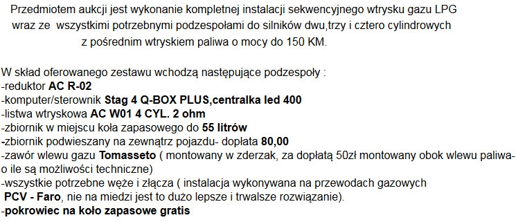

    2008 Mondeo MK4 with 2.0 Duratec gasoline engine, version FLEX-FUEL (reinforced valves).
    I plan to insert an LPG installation into it.
    Will the kit from the list below be a good choice? (Price around PLN 2,000)
    Assessing Suitability of LPG Installation Kit for 2008 Ford Mondeo MK4 2.0 Duratec FLEX-FUEL

    Installation from any auction. The R-02 reducer is up to 136KM. Like something R01.
    I propose separate AC w03 injectors.
    Look for an authorized service center because people have traveled with these promotions more than once because the workshops have closed.
    ...too cheap. A decent installation for this car will cost about PLN 2,500-2800. What you have there is the cheapest kit. It will probably ride somehow, but I would not risk it. As above, do not take the rail, only single injectors, and definitely too inefficient reducer.

    KME TUR absolutely, unless you want to rock. 4x barracuda drilled in the head - flaps !!!! W03 will not fit in with the culture. QBOX basic will save PLN 100. The rest do whatever you like.
    After 100kkm, the exhaust valves will disappear 100%, I do not believe in anything reinforced .....
