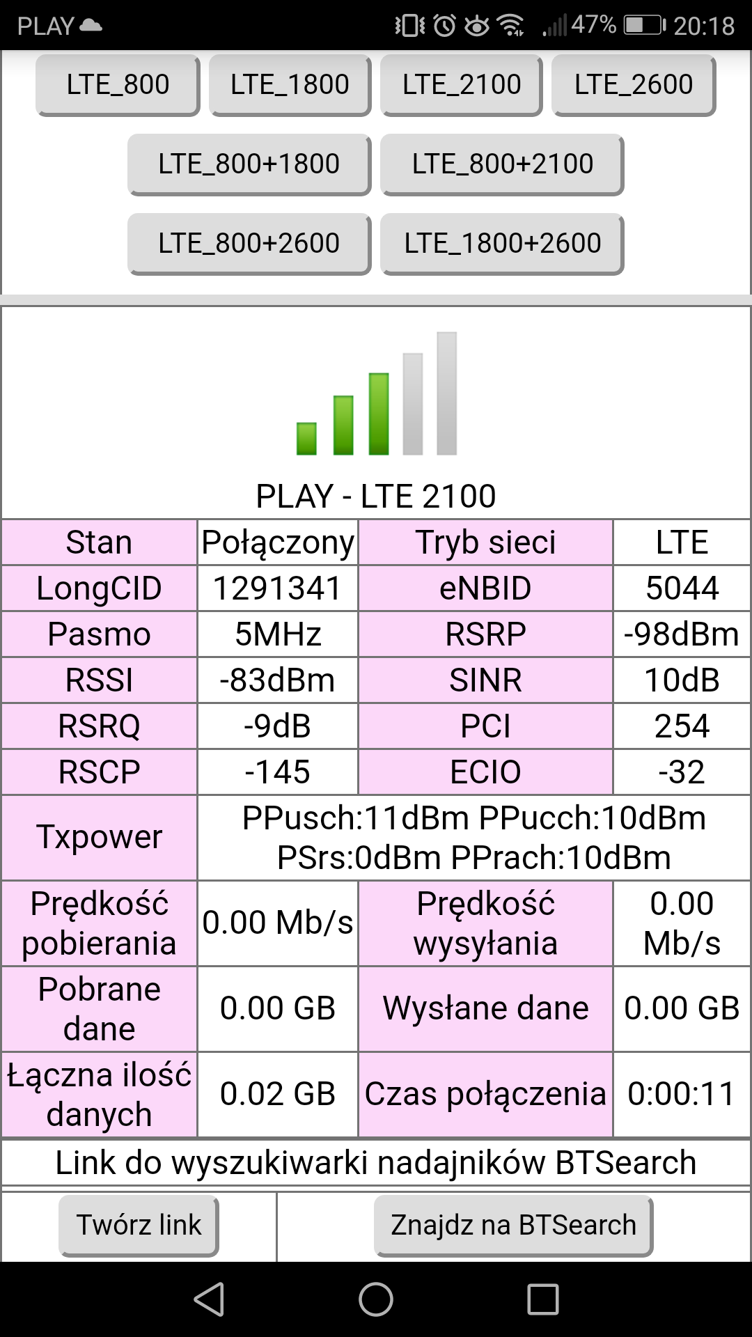

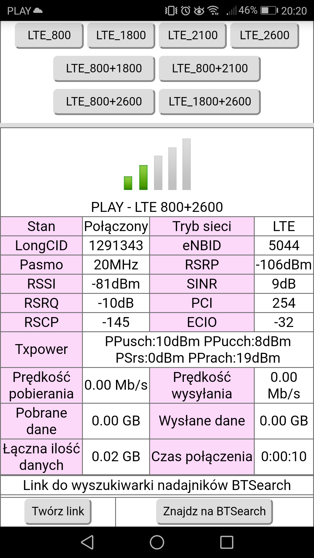

    How is the location in Warsaw? Check if your B525 works with http://www.mediafire.com/file/1yz26m6u8gfl16n/E5186+Toolbox_latest+v0.9.zip or phone app http://www.mediafire.com/file/6164xqf8az6ju81/Huawei_Manager_PL.apk These programs show BTS LTE and CID (ECI) signal parameters. They allow you to force specific LTE bands and LTE-A aggregations on the router. You force LTE2600, LTE2100, LTE1800 and LTE800 in turn, and LTE2600 + 1800, LTE2600 + 800 and LTE1800 + 800 aggregations. You check the signal parameters, CID and speed. The choice of antenna depends on it and set it to the direction of a specific BTS. The cable is as short as possible, no more than 10m. each meter is a signal loss, the largest on LTE2600 which in Play has a 20MHz band in MIMO2x2 and is by definition the fastest.

    Wolan89
    Posts: 35

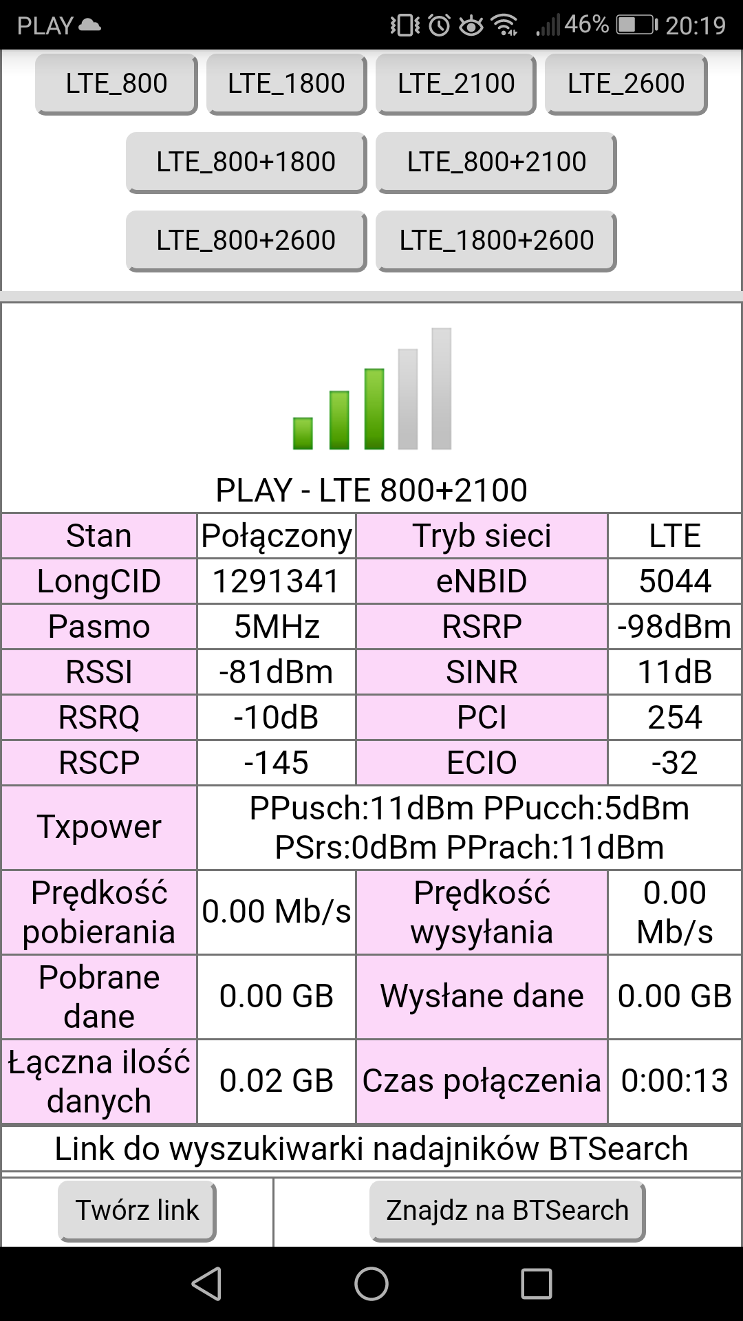

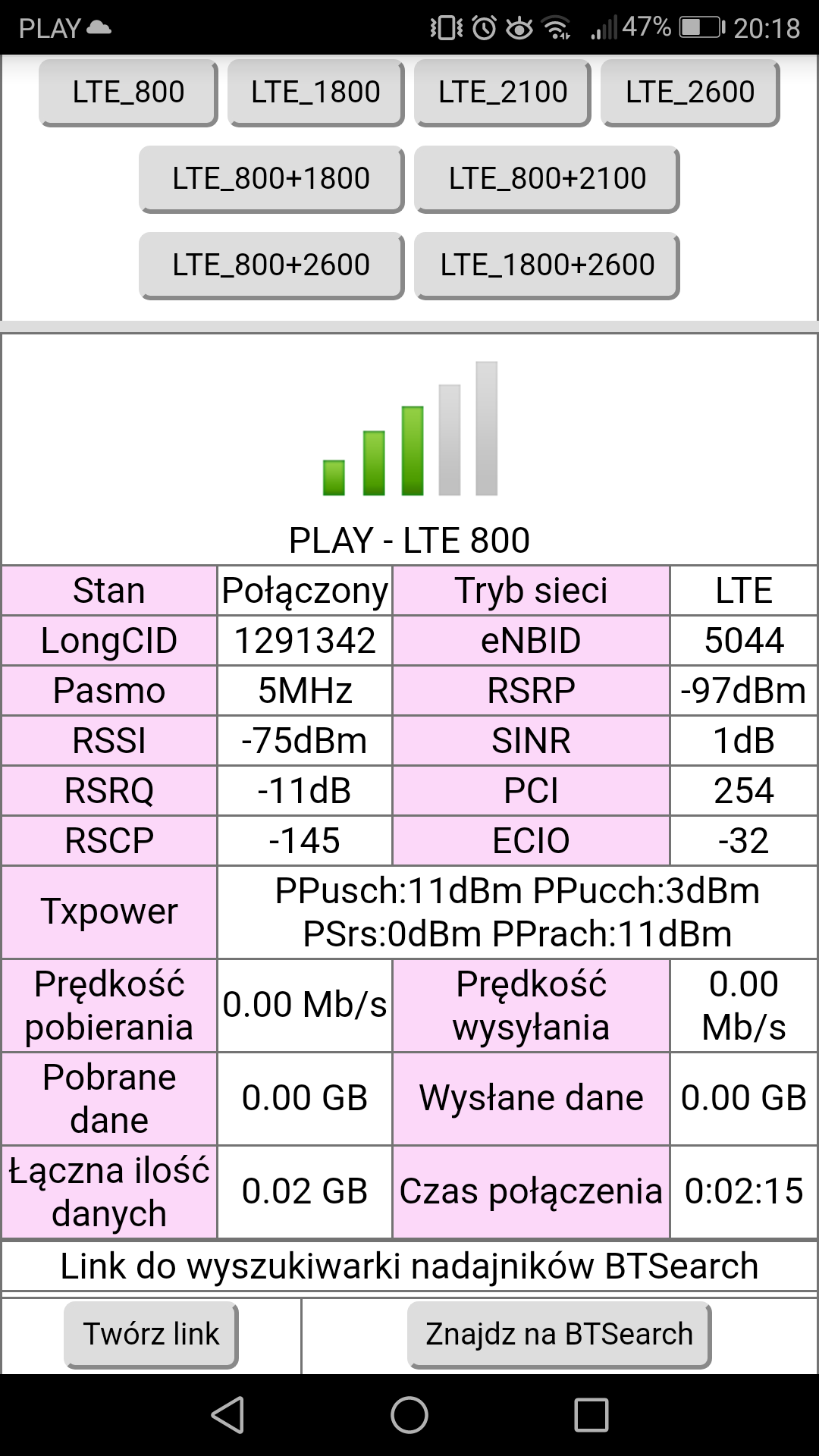

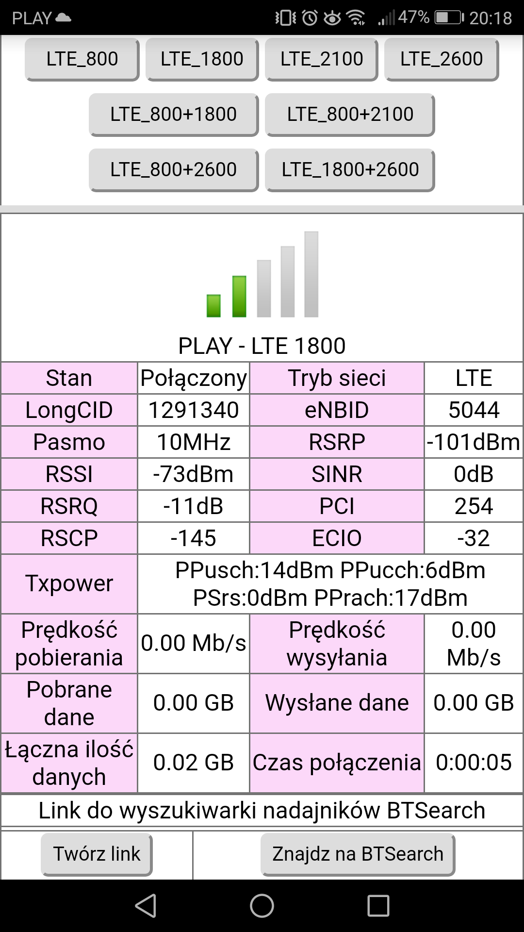

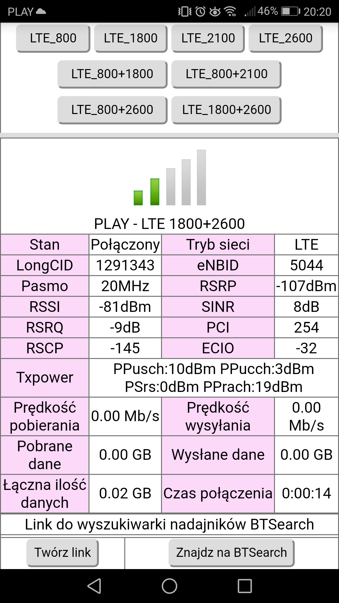

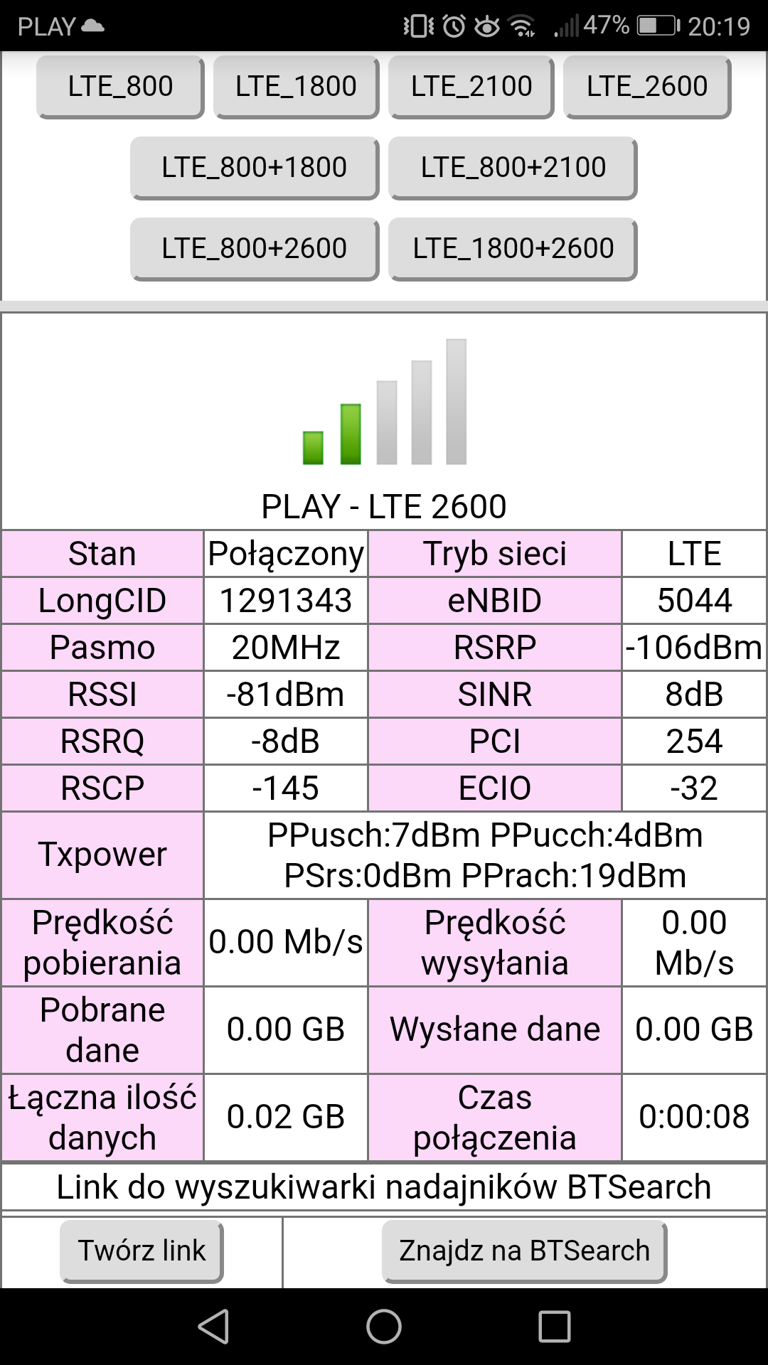

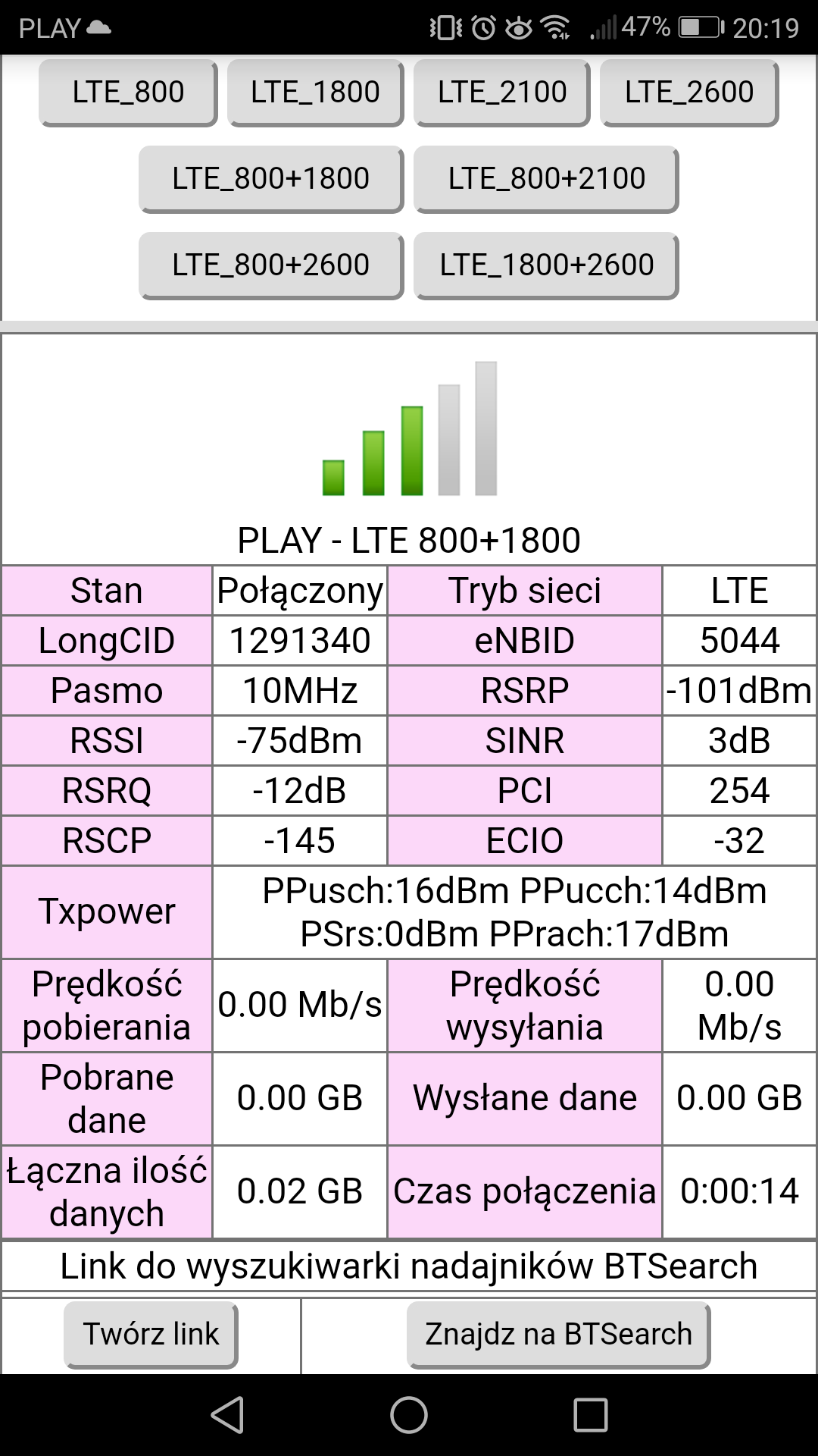

    Hi, I know it's been a while and the topic is dead. My fault doesn't change that.
    I downloaded the application on the phone, made various settings, but unfortunately I can not draw conclusions. I am posting screenshots of what I got and if someone could see it, I would be very grateful. If anything else to post, let me know because I'm green on the topic.
