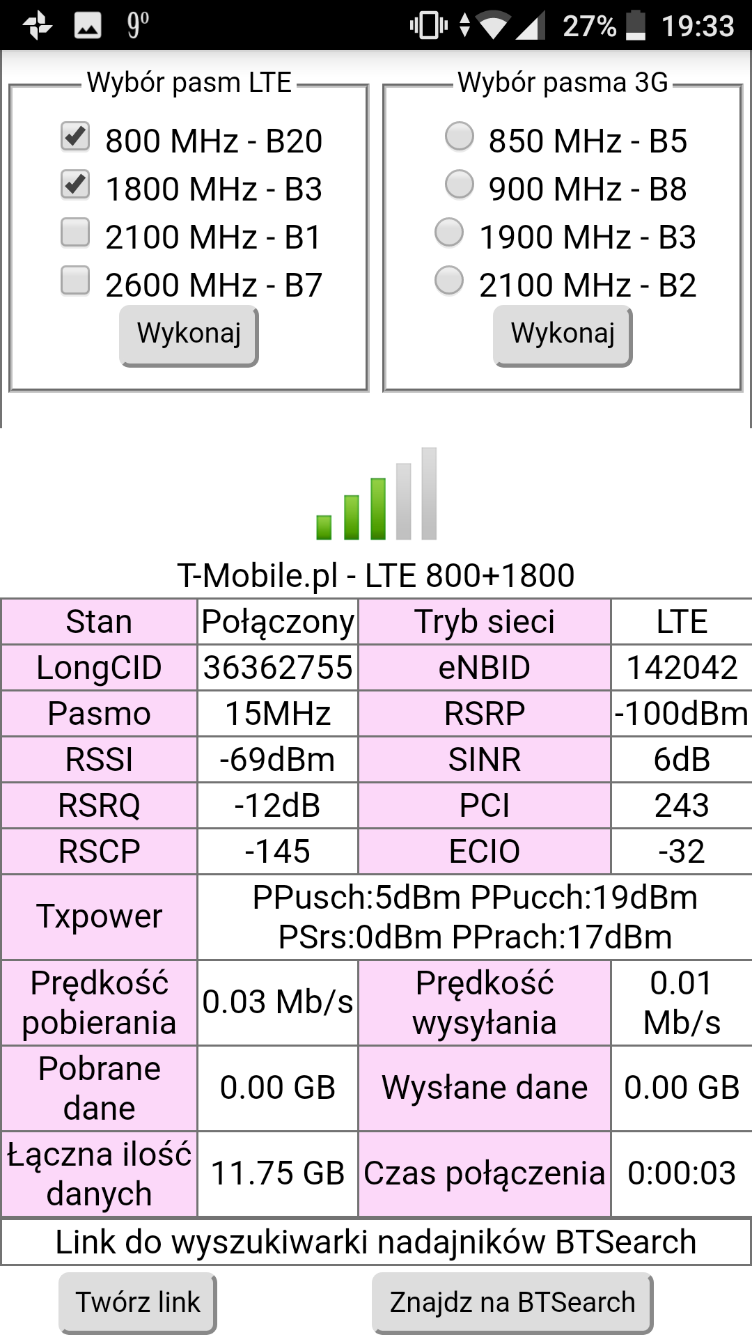

    I need help choosing the antenna for the huawei b525 modem.
    I live in the city of Koszalin, Władysława IV 58C, mainly block of flats. Currently, two dashes are displayed on the router. At the window, the number of bars and the download speed are increased. Can I ask for help when choosing an antenna for my router? The antenna will be attached to the window sill or the inner wall.
    If I have to do some parameter research, please ask for the instructions with which program and what exactly to check? I am green when it comes to wireless Internet.

    And what are the speeds on each of the LTE bands from BTS Staszic 38 / do also test LTE2600 + 1800, LTE2600 + 800 and LTE1800 + 800. on LTE800, the correct signal, LTE1800 sufficient and poor on LTE2600.

    The signal parameters on each band are already known for aggregation too. It's about speed on these bands and aggregations, make speed tests.

    You set the band and fire speedtest and repeat for each band, the results you put on the forum. The speedtest.net mobile application is very convenient.

    Results in the order that the screen below
    800
    1800
    2600
    2600 + 1800
    2600 + 800
    1800 + 800
    • Choosing External LTE Antenna for Huawei B525 Modem: Koszalin City, T-Mobile, Installation Tips Screenshot_20180404-202926.png (145.39 KB) You must be logged in to download this attachment.

    800 range clogged but this is the norm, I see potential in 2600 + 1800 if amplified by a suitable antenna. In general, for 1800 and 2600, the results are good, especially at 2600, despite such a poor signal.

    Recently, they praised the ATK-504 broadband forum and I think that it would work for you
    http://telkob.pl/inkontrahent.php?t=1318&g=291&q=&r=0&rg=0&sg=
    However, it costs yours.
    Up to 1,800 + 2,600 should also check Cybertech, it is slightly cheaper but at 800 it will not work.
    http://www.cybertech.com.pl/p173,antena-dualna-lte-a-4g-17dbi-mimo-1800-2600mhz.html
