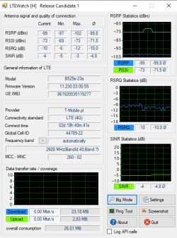

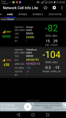

    Now there has been a change, I got an interesting offer from T-Mobile for a company without limits and for free with a Huawei B525s router. I decided to take this offer but for the time being to the test. I will post screenshots LTEWatch, speed tests and Network Cell info below.
    Band 2600:
    Antenna for Huawei B525s LTE Router - T-Mobile: Band 2600, 1800, 800 & Network Cell Info in Warsaw
    Band 1800:
    Band 800:
    Network Cell Info:
    Antenna for Huawei B525s LTE Router - T-Mobile: Band 2600, 1800, 800 & Network Cell Info in Warsaw Antenna for Huawei B525s LTE Router - T-Mobile: Band 2600, 1800, 800 & Network Cell Info in Warsaw
    On the router I have a range of 1 bar so bad. I need an antenna and see how it will strengthen this internet and if it will work better than the Orange cable. Previously, I chose this antenna. Is she still the best choice for these parameters?

    This antenna will be ok
    At 2600 the signal is very weak, at 1800 better but also very weak, at 800 sufficient, but this band is normally jammed. Where did the router stand during testing?
    1800 is Warsaw Skarbek z Gór 57
    800 is Warsaw Malborska 51
    However, if something was wrong with the antenna, you have 14 days to return.

    question quickly, I only had a moment to play this antenna again. When setting the antenna for a specific BTS, it catches me very distant BTS. For example, the BTS on the trek from the mountains is relatively new and I wanted to start tests from it, instead it grabs me BTS Atrium targówek (181453) or IKEA (181823) which are very distant, performance is worse than bad :)
    RSRP still below -102. Tomorrow I will have all day for testing. My question: what do I do wrong that it catches such extremely distant BTS?
