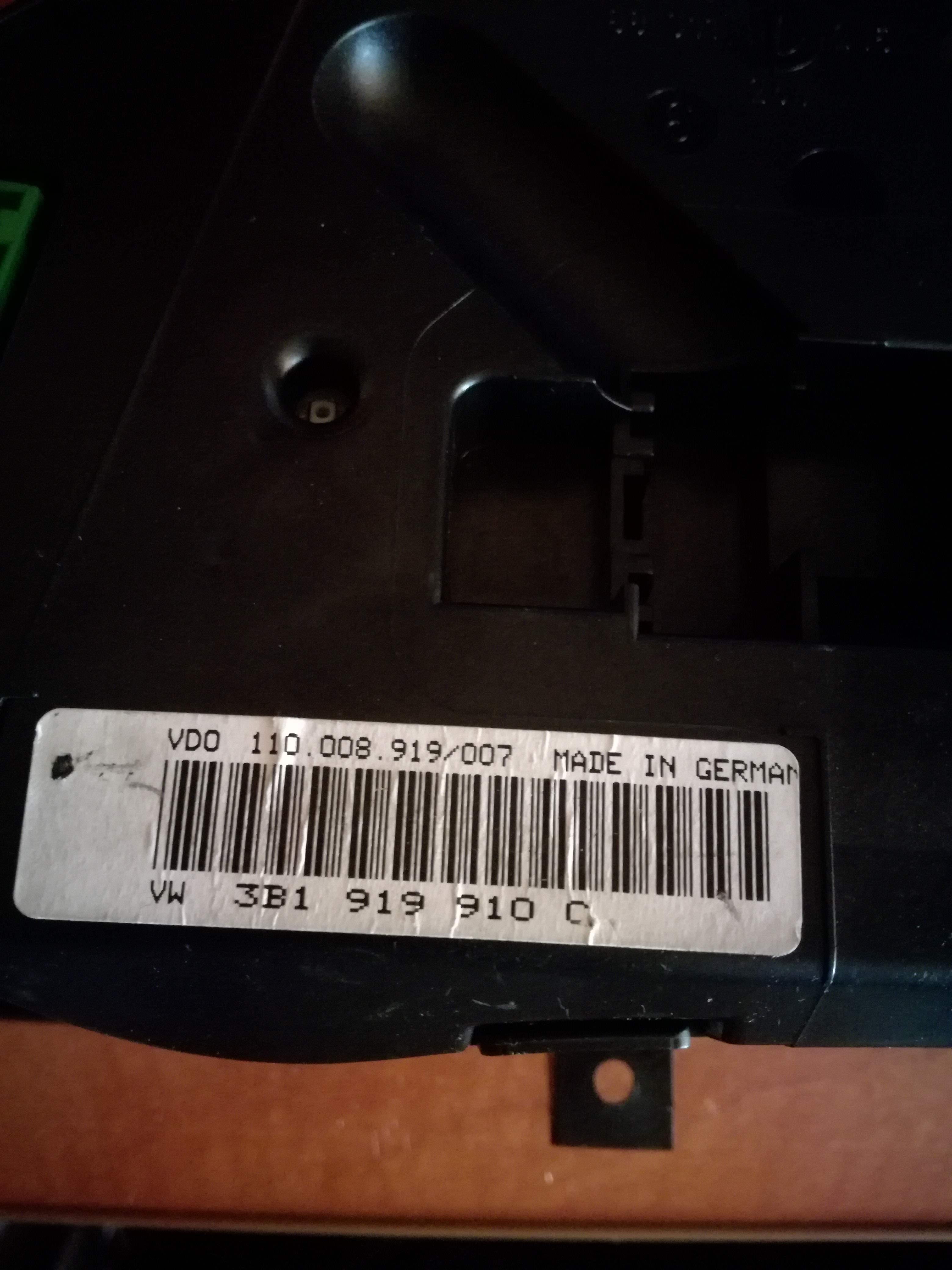

    I bought a meter from B5 fl with 1/2 fis
    Mine has no fis and the counter designation indicates that there is no CAN
    Sub podialrm new counter lights up fis too but message popped up for immobilizer
    Now the question is, if I add the lever to the fis and download the immo, will this 1/2 fis work?
  • #2 16769203
    T5
    Admin of Cars group
    Posts: 12861
    Help: 1004
    Rate: 4182
    It will not work.

  • #4 16770054
    psilos1
    Level 32  
    Posts: 1822
    Help: 203
    Rate: 881
    Enter the number of the old meter ... what engine and model yearly, After connecting and trying to start on the new meter the tachometer works? (Some diesels already had communication with the clock via can) - if so there will be no major problems with the spacer.
  • #5 16774313
    Tomuspiotrus
    Posts: 9
    1.9 TDI afn 99r
    • VW Passat B5 Pre-Lift: Counter Change to FL, Adding Lever, 1/2 FIS & Immobilizer Issues IMG_20170801_195316.jpg (3.28 MB) You must be logged in to download this attachment.
  • #6 16775556
    psilos1
    Level 32  
    Posts: 1822
    Help: 203
    Rate: 881
    Check if the tachometer will start on the new CAN clocks ...
  • #7 16775726
    adam7009
    Posts: 5609
    Help: 656
    Rate: 1635
    there will be no tachometer, abs and pillows will be constantly lit .... etc ..
    There were also immo 2 clocks with canem in which a lot of coding could be embraced ...
    To the author-you can also get clocks with full face without can -3B0919880B
    You add the lever and you have a fis

  • #13 16777167
    Tomuspiotrus
    Posts: 9
    I bought a counter with fl without a fisa today, when I come to download the immo and see what will happen
  • #14 16777287
    psilos1
    Level 32  
    Posts: 1822
    Help: 203
    Rate: 881
    Put on a new counter and try to start - immo will lock after 1-2 seconds but the tachometer should start
  • #15 16777455
    adam7009
    Posts: 5609
    Help: 656
    Rate: 1635
    he can replace the meter on the fired and everything will be clear
    AUTO-ELELEKTRONIK AB
    Linowiec, Lisewo, 86-230 | Tel.: 697XXXXXX (Show)
  • #16 16777651
    Tomuspiotrus
    Posts: 9
    As I connected the one with the fog from anogel, I turned the key, all the lights went out only from the wear of the pads because I do not have it and the message about immo.
    I tried to start it and it went out immediately
