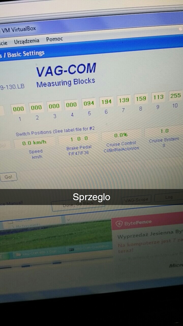

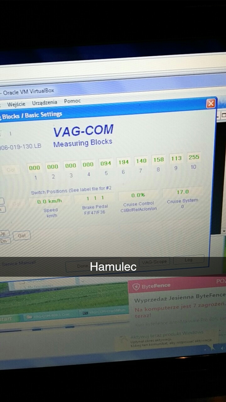

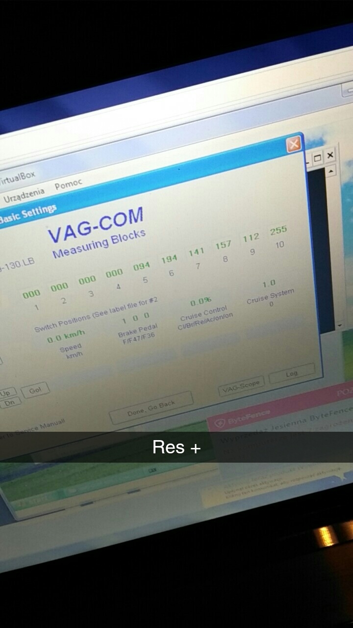

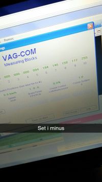

    Hello! Since I bought the car, the cruise control does not work, I would like to finally repair it. I connected to the vag, read on the forum what more or less needs to be done and now I don't know what to do next. I present the photo of VAG below. I will add that it started 2 times and from what I remember, I wanted to change the gear and it kept the speed, should it not turn off then?
    Pictures taken after pressing what is written in the screen

    rosak
    Car dashboards specialist
    Posts: 1789
    Help: 142
    Rate: 559
    Pull out the module and see what's wrong with it.

    Could you explain what it would be like to check what's wrong with him? Exactly what to do, etc.

    You write that the problem is intermittent, so check the connections, contacts, see if there is corrosion etc.

    The solution to the problem was to replace the clutch sensor (PLN 20)
