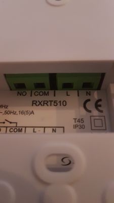

    arturo172
    Hello, I have a question how to connect the Salus 091FLRFv2 controller has two inputs No and Com plus power, to ecogold 25 where in the strip Termet ECOCONDENS GOLD PLUS + ROUND with Wi-Fi - Open-Therm - connected incorrec Termet ECOCONDENS GOLD PLUS + ROUND with Wi-Fi - Open-Therm - connected incorrec
  • #25 18187035

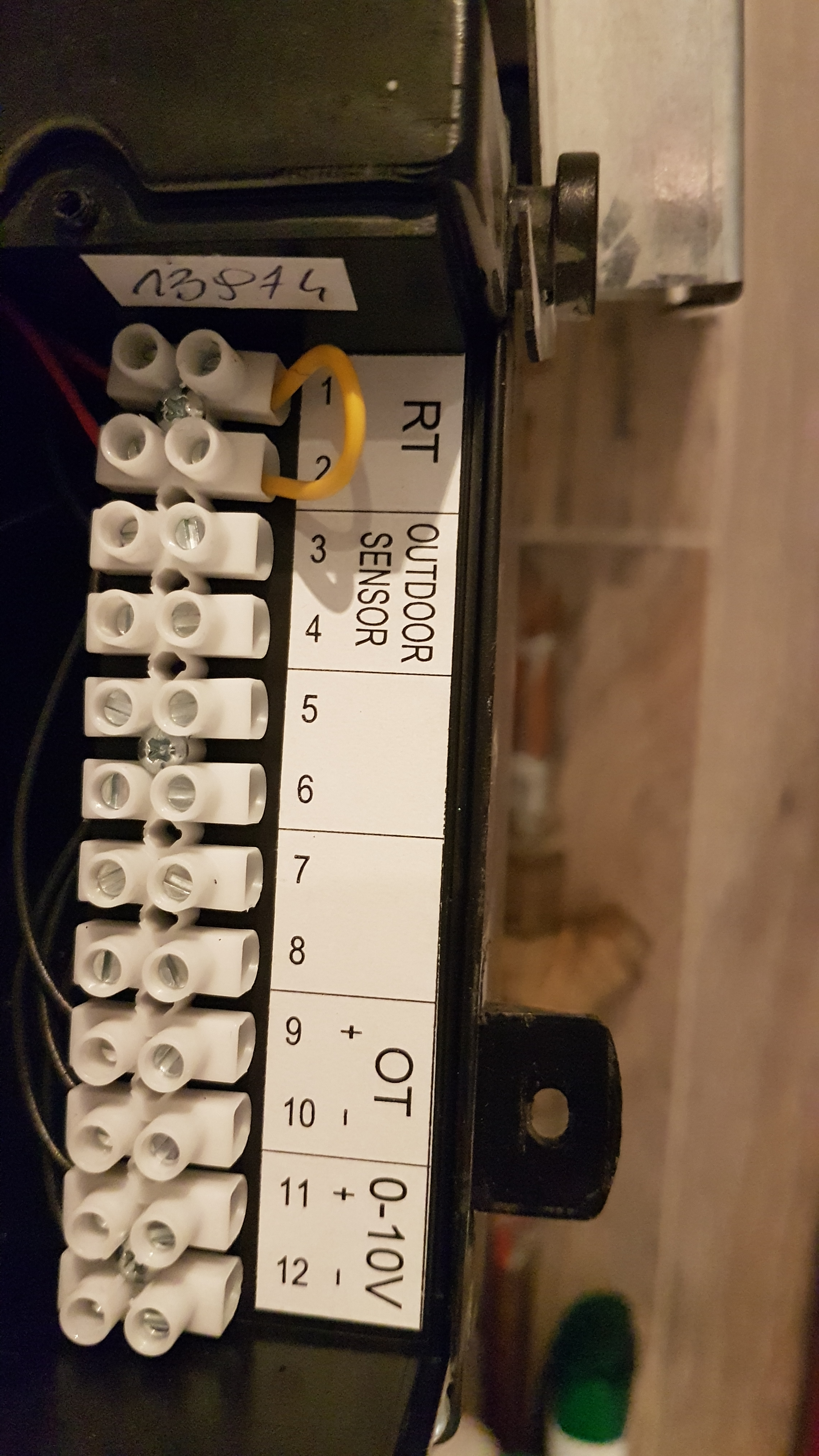

    #27 18232260
    krzys-iek
    Level 20  
    Posts: 668
    Help: 9
    Rate: 83
    My friend
    I do not know what this driver is, but the OT in termeta is a non-polarized connector to be connected to the opentherm driver. So you have nothing to do, how is it supposed to work? In addition, the short-circuited RT, i.e. the boiler is controlled only from the panel, based on the return and supply temperature.
    I do not know RXRT510 but you did not show A / B or OT here. You can see that this Salus driver is a normal ON / OFF (It's a bit lame as Termet has OT but it will work ...).
    NO / COM connects with RT in termeta (by removing jumper). Something old, this termeta plate, I have 5-8 connectors filled, some tank timer and something else.
    I tested the Salus RT520 and the opentherm works. The only disadvantages (considerable) is that the power supply from AA is obligatory (!) Although it could be powered by OT. Weak DHW program - no time control, only it will constantly monitor the set temperature from the menu (you already have the same on the boiler controller).
    RT520 has no weather forecast ... When a sensor (thermistor) is connected to 3-4, the icon on the thermometer starts flashing. It means that the weather device is supported by the OT driver. And that stupid Salus doesn't have it. You have to switch P26 to 3 in the service menu (the weather controller stays in the boiler).
    L and N are probably 230V power supply and it is weak in my opinion (the thermostat probably heats up because the power supply must break down to some 5V).
    Termet works without any problems, so with:
