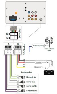

    Hello, I have car radios XOMAX XM-2DTSBN6214 and I am looking for a diagram of connecting individual wires in the ISO iso which goes into the radio. I have a cube for this radio but the wires are mixed up because it short circuits me. I am looking for a detailed connection of the iso cable to the XOMAX XM-2DTSBN62 I am looking for a detailed connection of the iso cable to the XOMAX XM-2DTSBN62

    The colors are standard:
    ISO standard:
    It is worse if someone has shifted the cables in the plug from the radio side ...

    I bought the XOMAX XM-DTSB1010 cube (photo 2) which supposedly fits different models of the XOMAX company. But unfortunately it does short circuit after connecting. Together with a colleague we came to the conclusion that the distribution of cables in the plug that goes into the radio is different. As you can see in the description, everything is correct when it comes to plug A and B, but there is a problem with the radio plug, something is swapped.
    Short circuit? Which fuse is "flying out" for you?
    It remains to examine the connections inside the radio, if you have not already burned something. You can find the mass with an ohmmeter even without opening the radio.
    And from the ISO cube side do you have connections for black to A8, yellow to A4, red to A7?
  • #5 16772638
    krzys1221
    Posts: 7
    At first, the fuse under the dash 20A burned, then I tried again and burned the fuse located in the 15A radio. As for the connection you are writing about (And from the ISO cube side do you have connections for black wire to A8, yellow to A4, red to A7?) that's how I got it. I checked cable by cable when it comes to connecting the cube coming out of the car - iso Xomax cube. From what I looked at German sites radios differ in the arrangement of the individual connectors on the radio. I also found such a cube (the only photo) that fits my radio and after zooming in you can see a different arrangement of wires, but that's all I could find.

    krzys1221 wrote:
    But I'm not sure if something happened for the radio. As far as I know, I put a fuse in the radio to secure the radio.
    Yeah, especially when you gave + 12V to one of the speaker outputs and where there is + 12V to come, there was a lot ...
