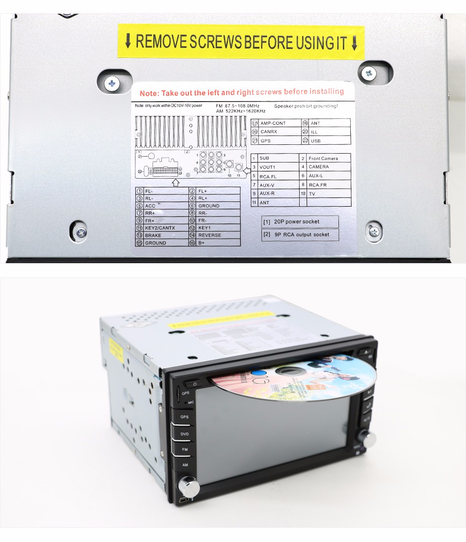

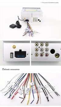

    I bought a Chinese radio and I would like to take it for its connection.
    I'm not very good at these blocks so I started by looking through the internet but I did not find my problem.
    All descriptions start from the moment when the cables "come out" of the cables fastened in the ISO bar. For me, the case looks as below (no ISO block):
    Chinese Radio Connection: Wiring without ISO Block for ALFA Romeo 147 2006
    I would like to advise you, should these cables be fastened to the ankle? I looked at Allegro, where you can buy cubes, but with cables ... What's next?
    The car he wants to connect to is an ALFA Romeo 147 2006.

    So yes. I'm sure you're going to break everything with your ankle, iso. This will make it easier for you to disconnect the radio in the future. In cubes, you have all wires marked with colors in the same way as on the radio. Sometimes in these "Chinese" it happens that you have to exchange the red cables with yellow, because, for example, after removing the key, the memory of the station disappears.

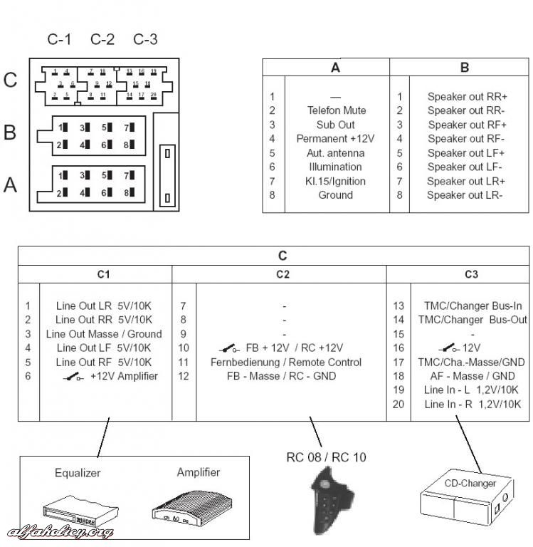

    I also found a description of some alpha radio on the ankle of iso. Compare this with the ankle in the car.

    Here I have a schematic of cables:
    I could ask you for a link, what should I buy?

    I understand the connection scheme well?
    Radio power cube from which cables come out ISO cube cables two cubes from ISO set two cubes from car installation?
    That is, it remains to choose the right PINs on the ankle.

    On the car you have a factory installed iso cube or is there any other cube?
  • #9 16190609
    dam1934
    It's an ISO cube.

    So it must be like this: radio -> cables from the cube from the radio -> cube iso female -> cube iso male installed in the car. It's best to check if you have 12V ACC (after ignition) and 12V batt (fixed 12V) before connecting everything.
