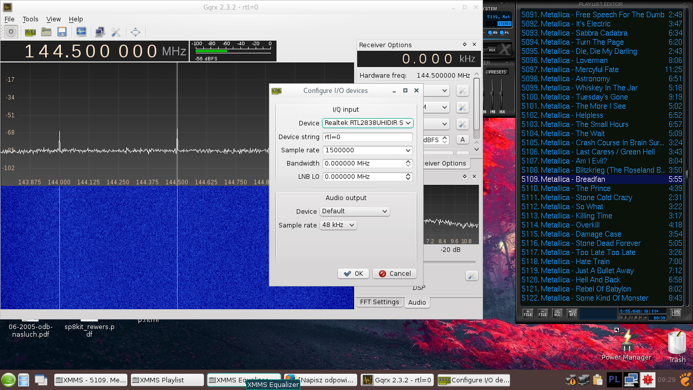

    And the dump for me looks like this.
    • Linux SDR Software: Kali, Mint Mate, Cinnamon Compatibility, Supported Chipsets Zrzut ekranu z 2016-02-19 18:06:48.png (260.45 KB) You must be logged in to download this attachment.
  • #30 15453920
    gugigugi
    Posts: 8
    In the "Configure I / O devices" configuration window you have to select your device in "devices".
    It appears not in the list when expanded, but try scrolling up and down.
    There is no selected device of your device in the screenshot provided by you, so it cannot work.
    Set "Sample rate" to 1500,000 (I set 1800,000) as my colleague neo386 has.
    At a smaller width, it sometimes chokes quite strangely.
    Of course I hope after all this you include "DSP start" the first icon on the left.
    The second thing is the antenna, a piece (about 1.5 m) of cable should be enough to receive the FM radio, it will not be crazy, but it is enough to test it.
    Only when you pick up some FM radio (set to FM mono), you can continue to figure it out.
    One more thing, try also switching the receiver to another USB, it supposedly helps.
    When everything works, you will try what and how with the settings, first radioFM, then you will go to the Gain tab, etc.
