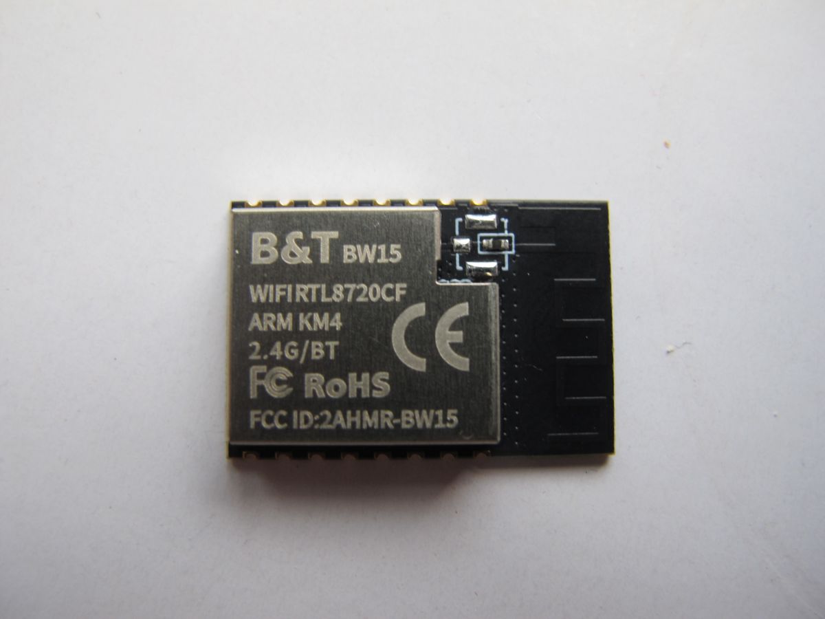

    insmod wrote:
    Do you have a WBR3 module
    nope, but I started research as soon as you said ;)
    was looking at a BW15.

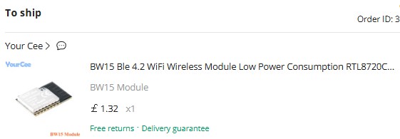

    Added after 3 [hours] 23 [minutes]:
    went for a module
    Screenshot of an order for a BW15 Ble 4.2 WiFi Wireless Module with low power consumption, priced at £1.32.

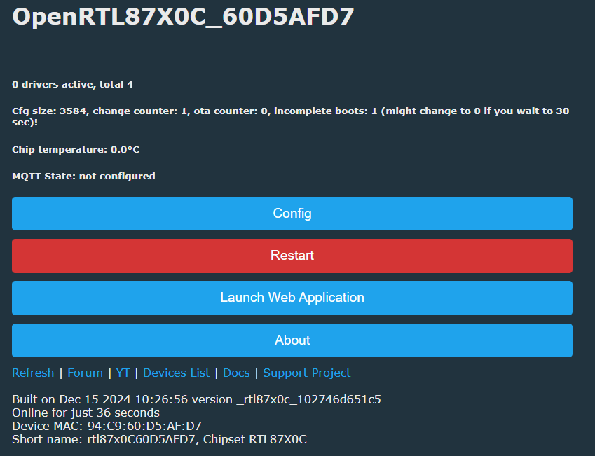

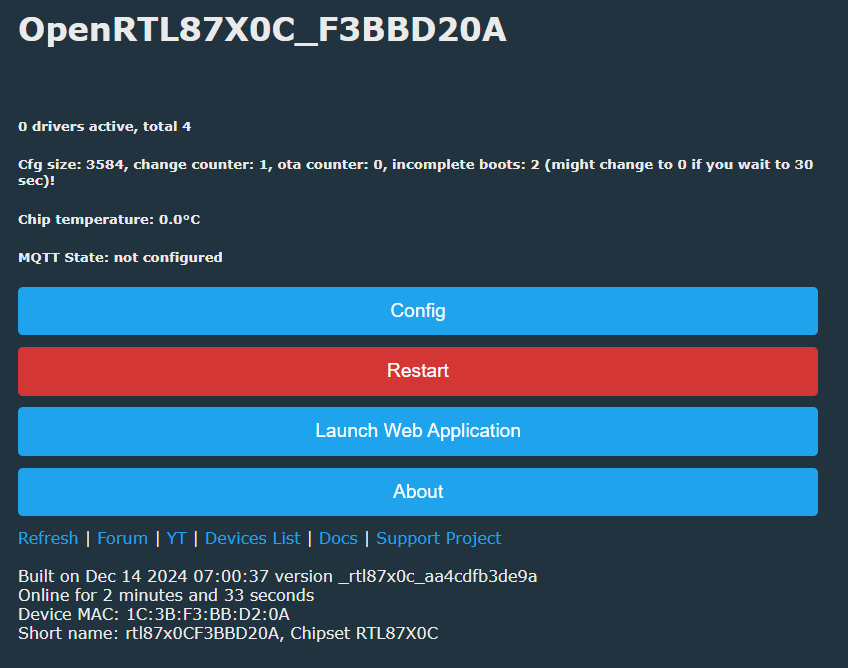

    https://github.com/NonPIayerCharacter/OpenBK7231T_App/tree/_rtl87x0c
    What should work: wifi, config, wdt, pins, lfs, ota(hacky, but works), uart (only default one, didn't bother with uart1/2 yet).
    Based on top of https://github.com/openshwprojects/OpenBK7231T_App/pull/1462
    Need someone with a wbr3 tuyamcu device to test it.
    Heap problem remains.
    • OpenBK7231T_App__rtl87x0c_aa4cdfb3de9a_OpenRTL87X0C.zip (851.11 KB) You must be logged in to download this attachment.

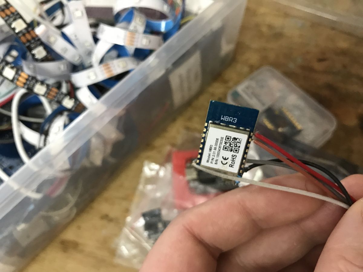

    I may have one, I've did some experiments in the past:
    WBR3 module with wires held in hand against a background of a box with LED strips.

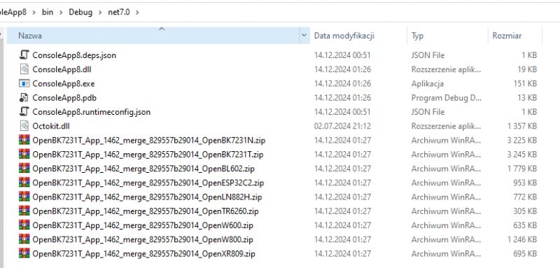

    I need few moments, and I'll check precisely which modules of this series I have and try to flash them.

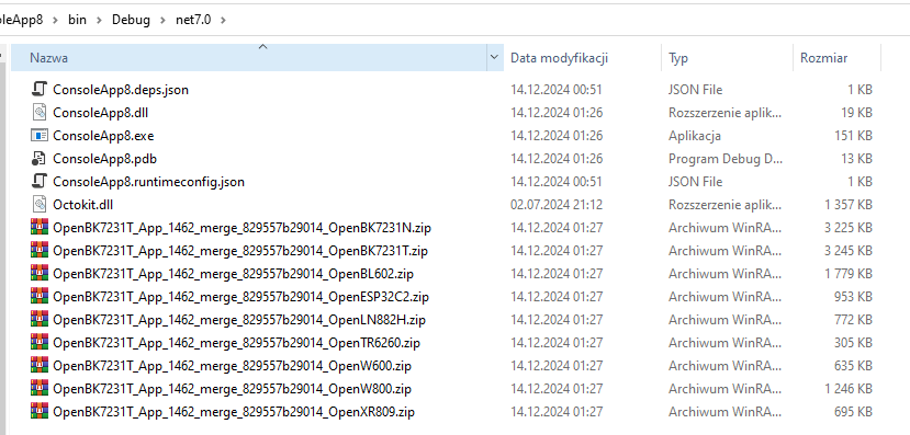

    PS: @insmod , I am working on an utility, that you might find useful. I want to do something like "Auto refresh and flash new" like in PICKIT2 flasher. Basically, you will be able to select a PR from drop down list and utility will wait for PR update and automatically flash the new binaries when they show up on Github. At the moment I have made a proof of concept binaries download from Github:
    Screenshot of a folder containing application files and ZIP archives.
    If I may ask, are you using Windows?

  • RTL8710C boot log shows OpenBeken starts successfully

    OpenRTL87X0C user interface with configuration and restart buttons

    PS: I've started working on a OTA tool. It will be both GUI and commandline. The idea is to just specify the PR link (or commit) and a device (or list of devices) and tool will automatically flash them to binaries from given PR/commit: https://www.elektroda.com/rtvforum/topic4093378.html

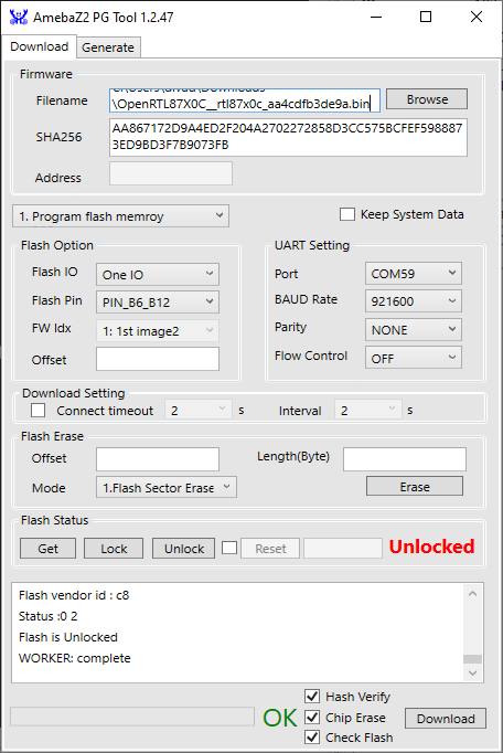

    >>21347074
    same, but even after flashing with PG Tool
    usually OK on next boot tho
    Screenshot of AmebaZ2 PG Tool 1.2.47 showing boot load errors and flashing settings.

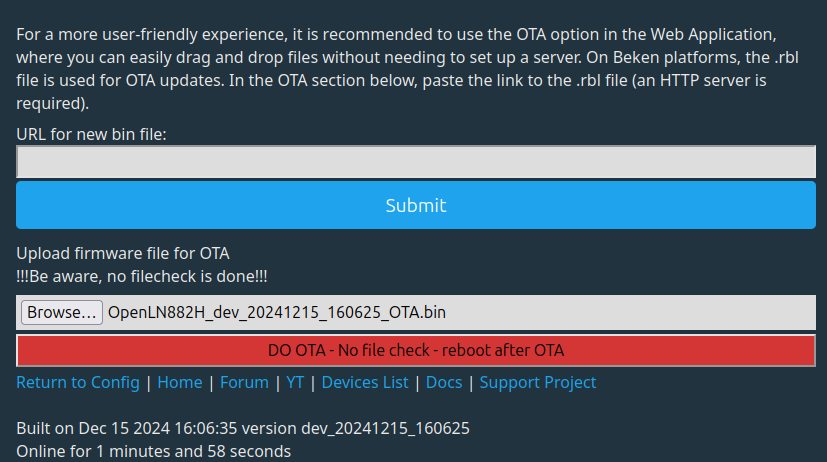

    #22 21349569
    max4elektroda
    Posts: 758
    Help: 49
    Rate: 189
    max4elektroda wrote:
    I had the same idea when inspecting the code for the LN882H issues, but no time yet.
    You can find the basic idea as a "proof of concept" in PR#1466.
    It's only basically tested with LN882H for now, so use with caution...
    Screenshot of a user interface for OTA firmware update. Screenshot of a web application interface for OTA updates with a message about no file selected.

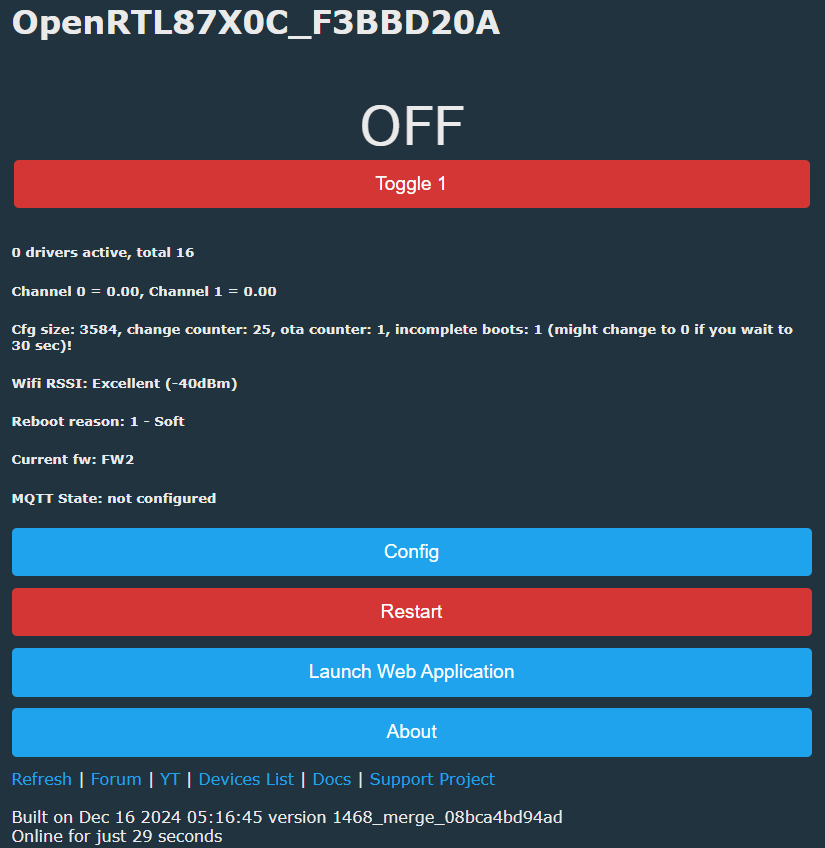

    OTA fine from _rtl87x0c_102746d651c5 to 1468_merge_08bca4bd94ad. no chip temp and rbt reason
    Screenshot of the user interface of OpenRTL87X0C_F3BBD20A displaying system status information.

  • Compile-time filename prefix check for OTA images
    #28 21355787
    Posts: 14755
    Rate: 12881
    EDIT: Ignore it, OTA discussion is now there: https://www.elektroda.com/rtvforum/topic4094306.html
    Spoiler:
    As far as I remember, BK7231 code does checks for the RBL image, but they do not check the N or T flavour. So the only "dangerous" combination is putting T RBL on N or vice versa.
    So we need the tiniest possible check, for example, do an universal check for filename start, see if it matches, idk, current platform #define, then I can merge it.
    Like:
    httpprintf(request,"if(file.name.startsWith(\"%s\") {", SOME_DEFINE_HERE)
    If you put expected filename prefix at compile time, it will still be lightweight but it will check well for current platform

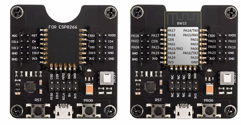

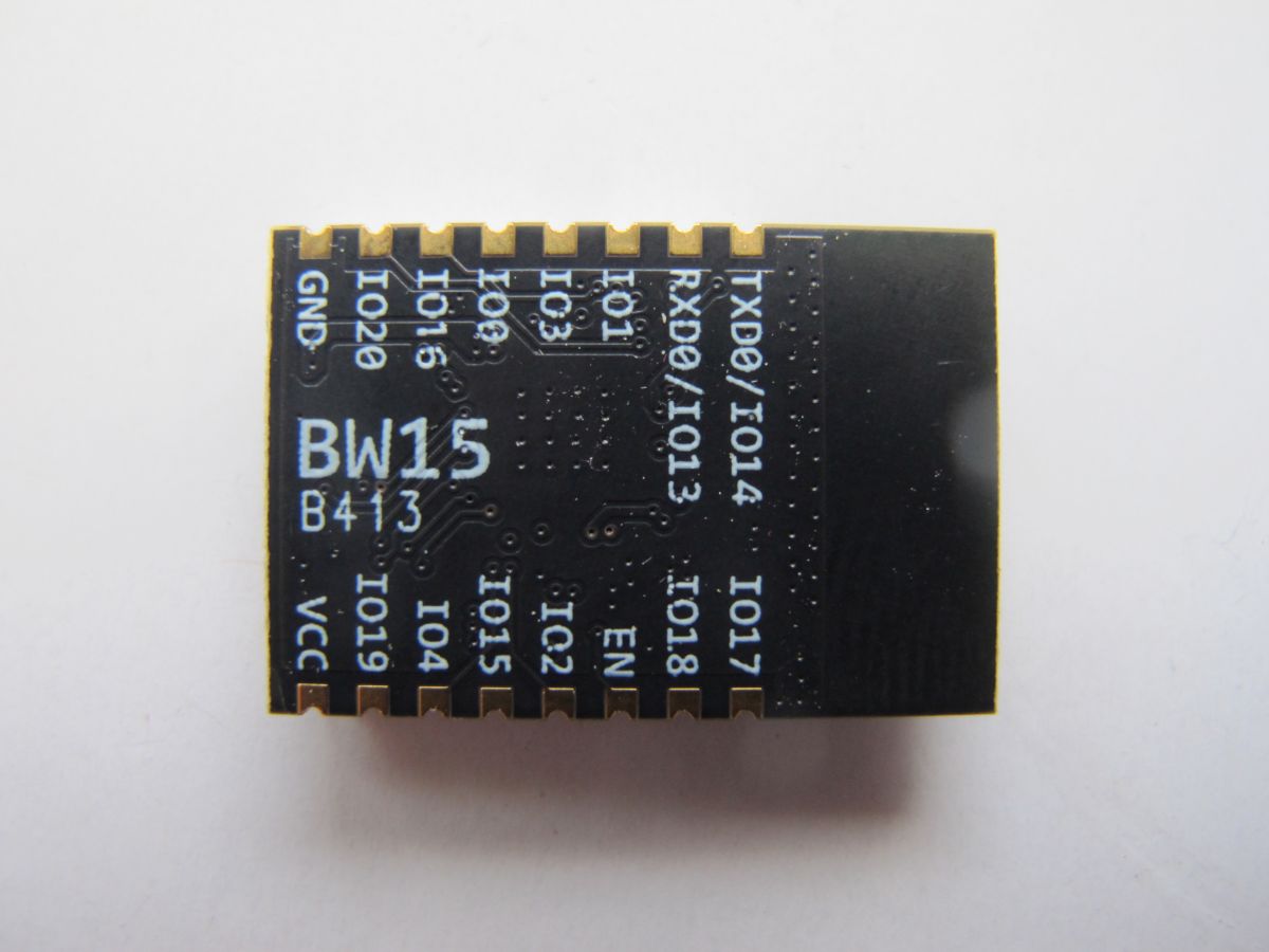

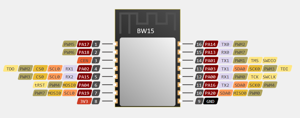

    BW15 bits
    boot log from PA16/TX2
    Illustration of BW15 module with pin labels.
    Close-up of two electronic modules with labeled pins.
    Not sure what the firmware that came with the module is at this point. It doesn't broadcast an AP.
    flashing with PA15/PA16 and PA00 to 3.3v
