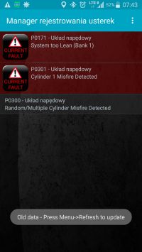

    Hello. Can anyone help in the initial diagnosis of the fault? As in the subject, we have Toyota Yaris 1.0, 2003 with LPG installation (the problem occurs on gasoline and gas). It displays two errors P0171 and P0301. The engine is very weak, works unevenly as if it did not work on one cylinder or had a different ignition. Of course, today I'm going to the mechanic but I want to know what to expect so that it does not turn out that the mechanic will tell me that you need to replace half the car. I am asking for a diagnosis.

    1. Too poor mixture. Possible causes - fuel maps run out - LPG system incorrectly adjusted, gasoline pressure too low or other equipment malfunction, lambda probe worn.
    2. Falling out ignition. Possible causes - too poor mixture, worn or damaged ignition system, loss of compression as a result of accelerated head wear - Yaris is not easy to tune LPG (variable valve timing, lack of hydraulic valve clearance adjustment).

    And the fault has been removed. It turned out that the candle was damaged. I had Denso K20TT candles installed. These were mounted during the LPG installation and I always replaced the same ones. I mentioned these three months ago
    After changing the candle, I deleted the errors. After driving a dozen or so kilometers, the errors do not pop up and the engine runs like a watch :)
