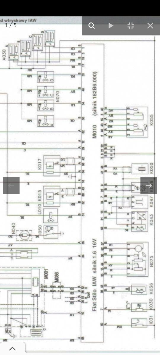

    I have a request for help in the correct analysis of the throttle control principle. Namely, in the attached diagram, I marked the throttle. Please, maybe someone will try to explain how the throttle opening reading is performed? is this reading duplicated?
    I am asking for answers in the subject.

    Added after 4 [minutes]:
    Something missed me.
    The throttle is N075
    The gas pedal is K055

    Reading with a doubled potentiometer similar to the gas pedal.

    Ok. Is anyone able to specify what the throttle range should be? From how many to how many Ohm? I wonder why these throttles are so expensive and emergency? Or maybe it would be enough to redesign this solution? The case concerns throttles in Fiat Stilo 1.6 16V

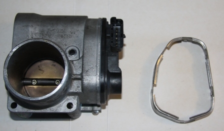

    Buddy, it's not that simple. These dampers are integrated with a potentiometer that is there in the form of a tape - rather not a replaceable element.

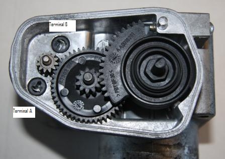

    If anyone posted a photo of what the electronics of the disassembled throttle looks like, probably someone would suggest how to convert it at a cheap cost. Perhaps you can add an external potentiometer.
    There are also such modifications from a potentiometer to a magnetic sensor.
    I found such a photo on the network and it would rather be possible to get an external potentiometer there, properly securing it.

    The breakdown of these throttles is not the fault of the potentiometer, to a large extent.
    Then what is the main culprit?

    In the third photo, under the badge, there is the crux of the matter ... scratching post and elastic resistance ribbon around, I didn't tear it by force so I don't know how it is connected to the pins - probably pressed in somehow.
    These potentiometers have inverted shoes that scratch the shell instead of sliding over the resistance mass. Do we know how a properly installed skid looks like or look in google? Otherwise, instead of sliding the bent finger, we slide the same finger, but a fingernail.
    Perhaps it is about the high accuracy of the measurements, or the bulb conspiracy. The new throttle also bought is the same made.
    There is an ice scraper instead of a slide.
    I doubt anyone else would find the same resistance tape with the same values.
    It turns out that the Fiat will break down after 200-300kkm = it's better to buy new thinking for those poor people from the west.
    Mine has 250kkm - recently 4,000 to keep it running. A whole series flew week after week. A German would cry with happiness that he got rid of, and we fix ...

    Here I found resistances on the pins as if someone wanted to check. Link
