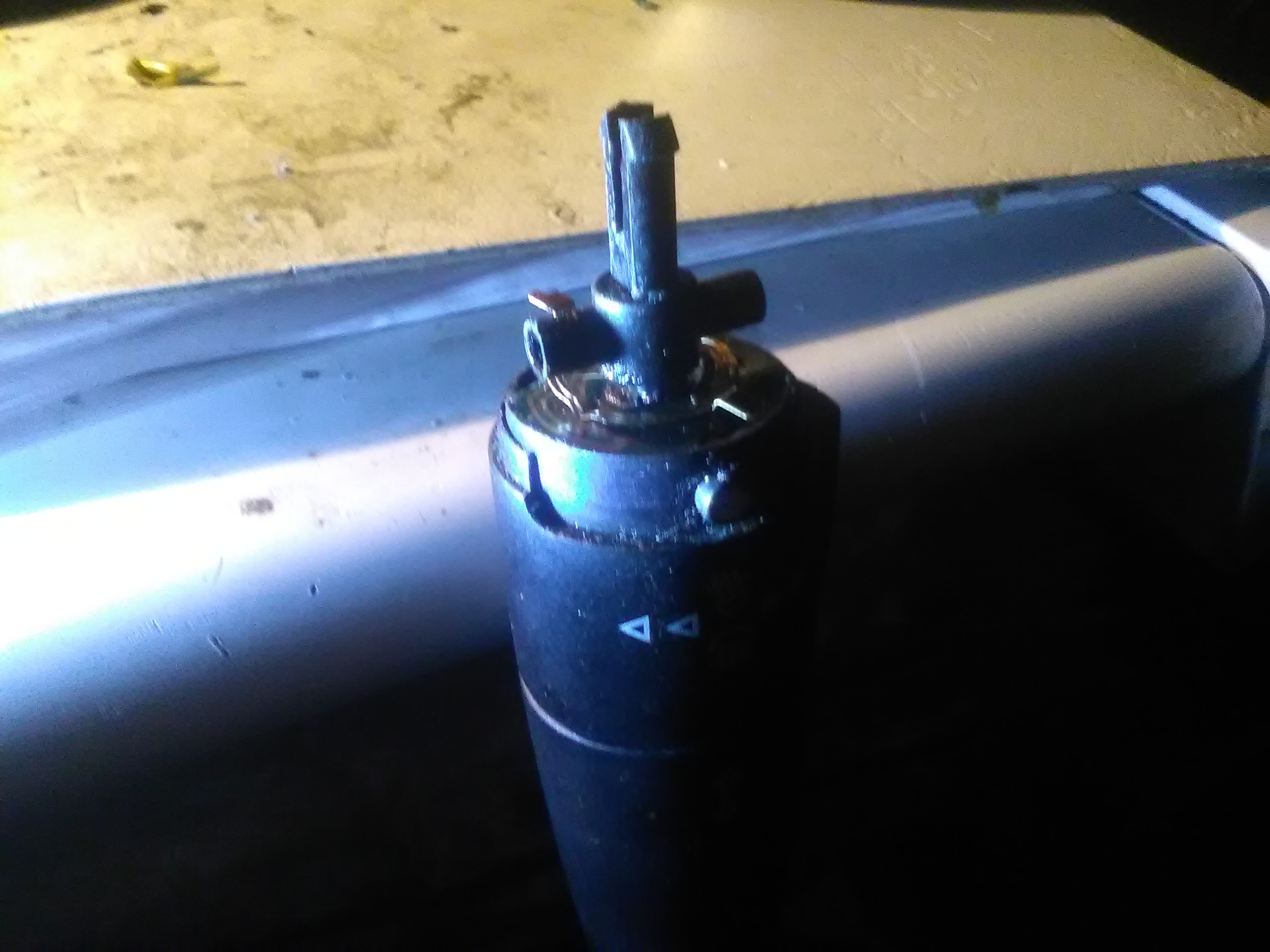

    Hello. The defect, as in the topic. Checked fuses. After switching the low beam switch, everything lights. The automatic also option. The position switch, no lights and number plate lighting. What is the power path from the switch to the lights. The car is a friend and will review it broke.

    There is nothing on the first position. Is it possible to bypass this switch. Yes, to manually turn on the positional ones. I have a book repair the peugot, but in English. And with this language, I have a hard time.

    Unfortunately, but the harvester needs to be replaced.

    Check from the diagnostic computer whether the BSI "sees the parking lights on and in the actuator test mode, the parking lights can be turned on. If it is possible, the Com 2000 is damaged, i.e. the combined switch.

    It can be converted into an ordinary additional switch, I do not remember if it is similar to the 206 but the transistor controlling the positions in the BSI is available on the Allegro.

    Peugeot 307 2004 2.0 - No Position Lights: Troubleshooting Fuses, Low Beam & Number Plate Lighting Peugeot 307 2004 2.0 - No Position Lights: Troubleshooting Fuses, Low Beam & Number Plate Lighting Thanks for the information. Can someone explain to me what BSI is. The car is not mine, but a friend. I have a diagnostic cable for VW. And the French is a fairy tale. . you have to look for another switch. Peugeot 307 2004 2.0 - No Position Lights: Troubleshooting Fuses, Low Beam & Number Plate Lighting

    Replacing the stalk switch eliminated the defect, I consider the topic closed.
