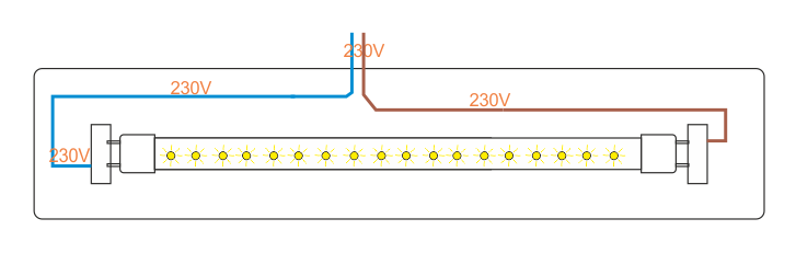

    I have a "fluorescent lamp" LED (the equivalent of a fluorescent tube) and I would like to connect the power supply only on one side, i.e. on Figure 1. Can it be done with any LED lamp? Until now, I had a connection, i.e. fig. 2.

    You must check the path of the fluorescent tube with the meter, whether the upper left pin has a physical connection with the upper right.

    Hello. If the luminaires of the fluorescent lamps are connected together, then only the option of drawing No. 2.

    See how it is described on the fluorescent lamp, where L, and where N. But they are such that they have power on one side.
