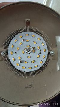

    Recently I got a free-standing led lamp, it has two "bulbs", one is lit and the other is not. I checked all the cables, there is a transition so the problem lies in the very lead, under what name to look for this module and how much would it cost?
    SMD LED Disk (plus disk diameter and number of LEDs) - I don't know the price.

  • #4 16572199

    In TME they have single diodes, it is enough to diagnose which has a break in replacing burned pieces, the cost of one is about 2-4 PLN

    How would I replace them? ordinary soldering iron or what?

    You can desolder hot soldering can be flask but be careful because they have a heat sink underneath

    So how do I buy a matching diode? I don't know if the correct LED will be displayed after entering the SMD LED.

    Napier then you need to check the power supply, then replace the diodes; LEDs - check resistor, supply voltage from 5V and check 1 pc.

    Christophorus wrote:
    Look at the LED above the wires. The one next to the + sign. It has a small dark spot. It is probably damaged. Replacing this diode can bring the bulb back to life.
    It is rather a flux splinter from soldering the wires. When the diode burns, the damage is not so close to the edge.
