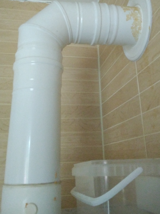

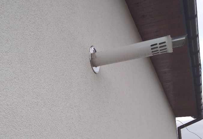

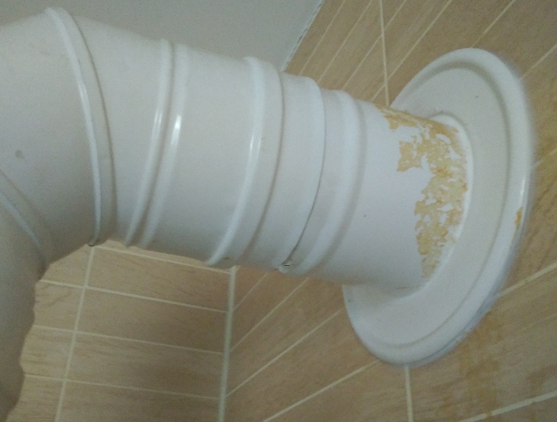

    I noticed a few days ago that drops of water appeared on the elbow of the air intake pipe. It is not dependent on the weather. This usually happens when the stove heats the tap water in large quantities (e.g. when using the shower). What could be the reason for this?
    The DeDietrich MCR 3 stove is in the bathroom and the whole chimney is about 2 m (0.5 m vertical exit from the furnace, elbow, 1.5 m horizontal pipe with a slope of about 2-3% towards the furnace passing through the wall. Since installation (2 years ago) nothing like this happened.

    The most condensate from flue gases is produced in the DHW boiler mode, because it works at full power.
    The leak indicates that the internal flue pipe is leaking. Probably wrong installation and the seal has collapsed. The condensate gets into the intake pipe space.

    I undressed and that's how it was. Thanks a lot. I will replace the gasket myself.
