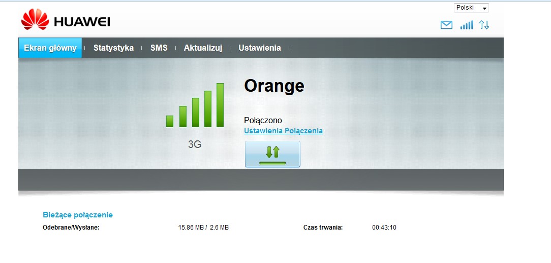

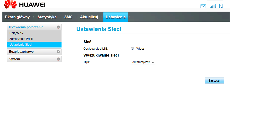

    A friend gave me the Huawei E3372 modem. After logging in there is a 3G connection with Orange. Modem software version: 22.200.05.00.159 Speeds around 0.5 to 3.5 Mbps The network settings only have:
    Network Settings
    Network
    LTE network support: On
    Network Search
    Automatic mode
    Is there any way to set higher internet speeds?

    Is the modem HiLink or normal? Like Hilink, download it link , log in as to the configuration panel and give screenshots. Provide location. TL-WR740 is useless.

    I'm supposed to check if it's Hilink? I log in through 192.168.8.1

    HiLink you have. Download the application and set only LTE, because you have a strong 3G signal and LTE is missing. Give me a screenshot.

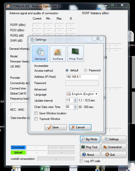

    Enter the login details on page 192.168.8.1 and next to the frquency band you have such a plus, and there select the bands 800/1800/2600 in turn. Give screenshots.

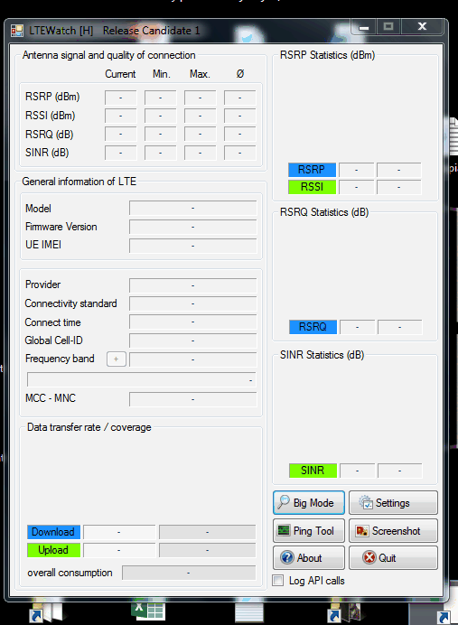

    Can't see the modem, all tabs are empty

    You are doing something wrong, try again, this modem works with this program. If you have changed the standard admin / admin password, you must enter it in LTEwatchH, change from default to password and enter the password under IP.

    I don't know what's going on, the browser logs in without a password, unfortunately LTEwatchH can't see the modem. Huawei E5186 Toolbox connects to the modem but I cannot change the band
