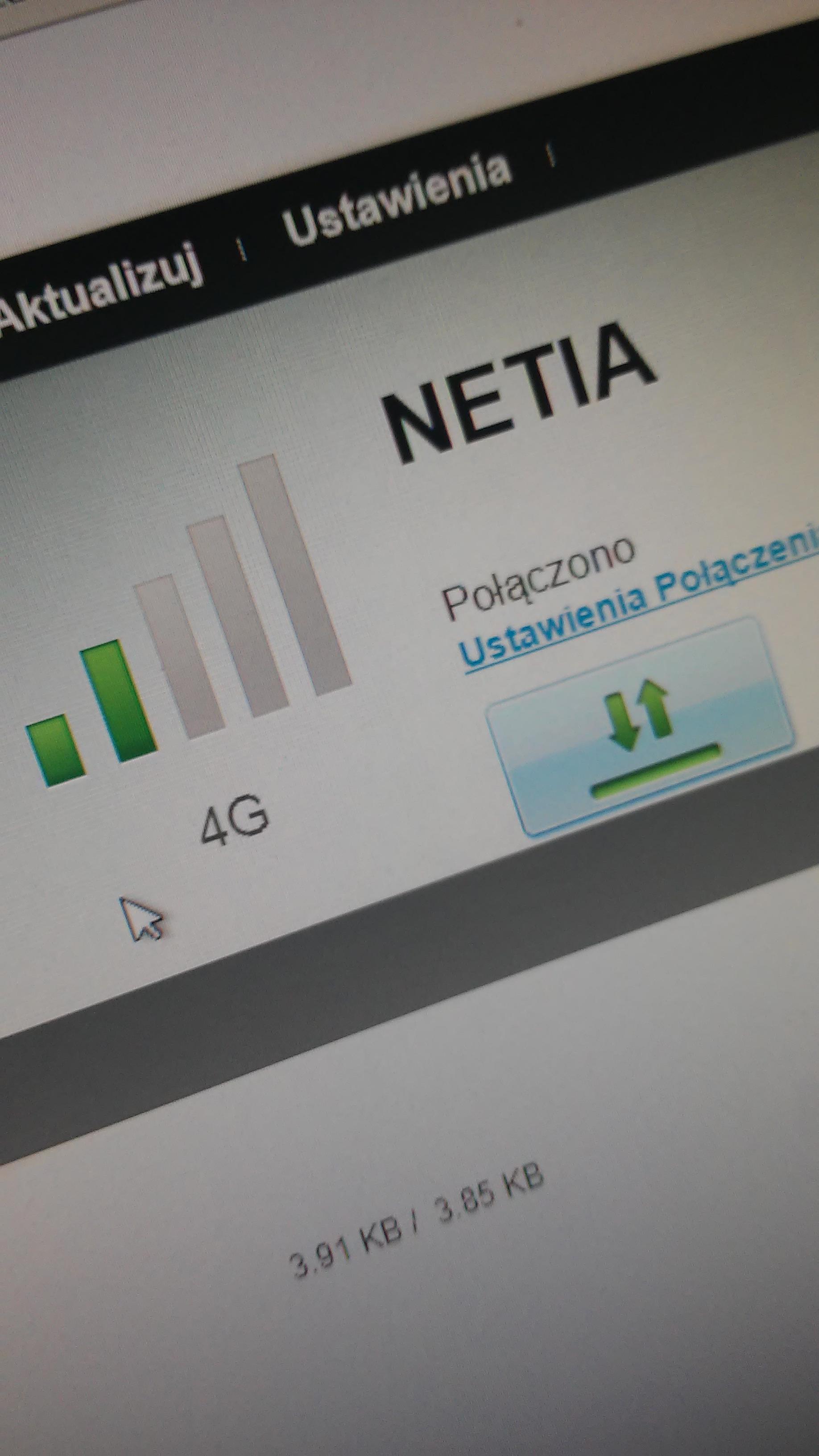

    Added after 3 [minutes]:
    The range is

    Disable the PIN code on the SIM card using the phone, then the router / modem will not ask for it. And the LTE coverage is weak even in these lines. Signal parameters have their own measures http://jackiewiczowie.blogspot.com/2014/10/parametry-sygnau-lte.html and they are important, not lines. And because it is LTE Play, it is not known which LTE band of this operator you use. The closest BTS Play is Kamionki, it runs the fastest LTE2600, LTE2100, LTE1800 and LTE800 and aggregation of these LTE-A bands. The same in Poznań at Głuszyna 135 and in Wry. Your equipment is bad without LTE-A. But it's possible that this E3372 if it's HiLink works with LTEwatchH or Toolbox 0.9 https://www.dropbox.com/s/x3f5jxw89rjk0i9/E5186%20Toolbox_latest.zip?dl=0. Then you insert the modem directly into the computer, log in to them at 192.168.8.1 and in turn force LTE2600, LTE1800, LTE2100 and LTE800 bands. The programs show BTS data and signal parameters. you check the speeds on each band and choose the best. If the signal parameters are weak, you buy an external antenna for the selected band. You have 3km to BTSs and, contrary to what you think, the signal is weak and the speeds are probably weak. antenna at such distances necessary, unless you do not care that the internet works optimally.
