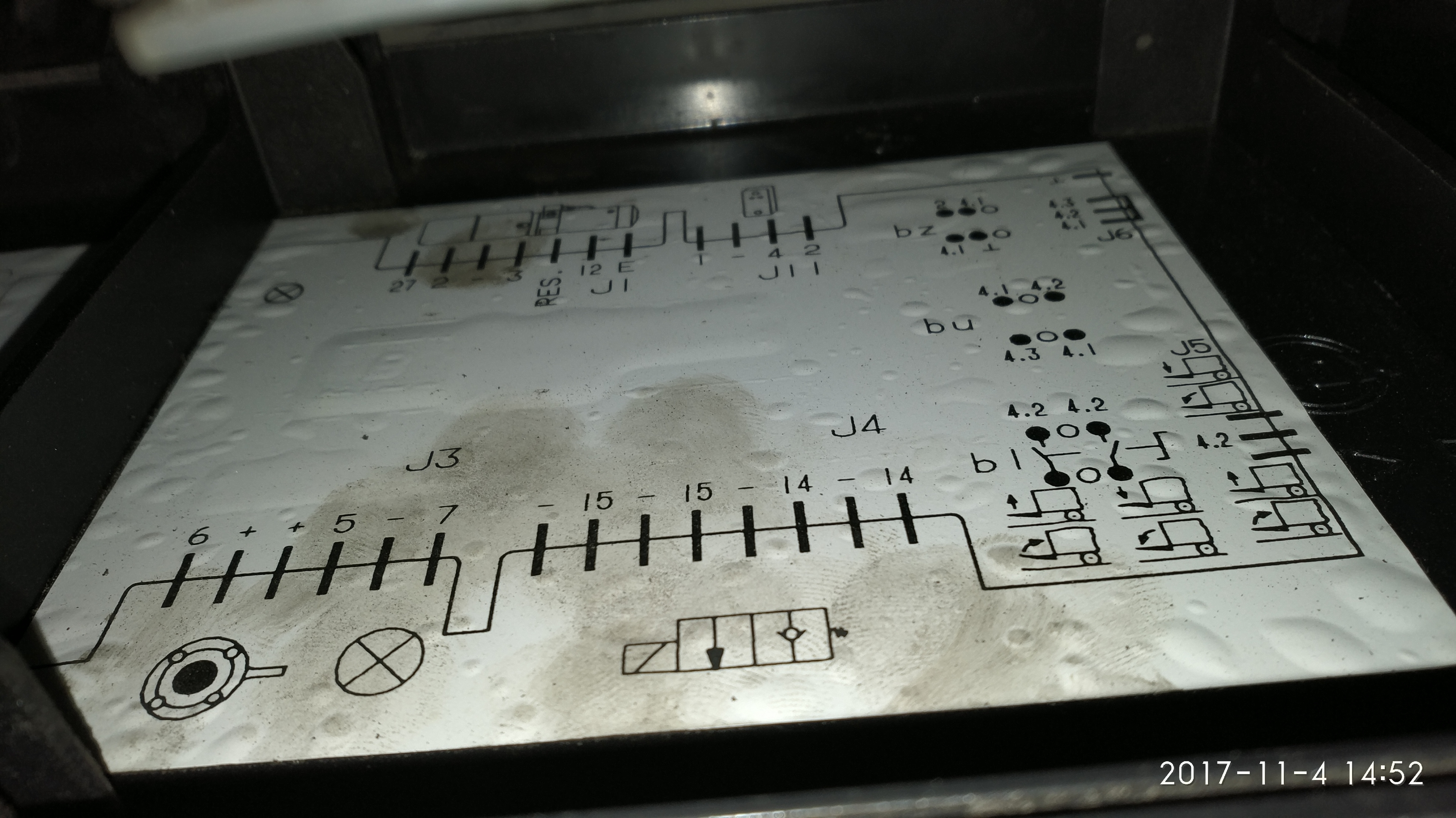

    Maybe someone knows how to connect the control pendant to such an elevator. I have already connected in several BARs and DAUTELs without major problems. Here, however, I cannot comprehend. The most ordinary cassette, 2 buttons (up / down), i.e. 2 minuses (from the respective functions) and a common plus.
    So far I have discovered that the J4 connector is responsible for gravity functions (not requiring the pump to work), i.e. opening and lowering (pins 15 and 14, respectively) I do not know why they are twice, but the lowering / opening works after bridging the above-mentioned PINs with a plus, I plugged in in the PIN marked 4 in the J11 connector.
    Unfortunately, I can not find a lift up, and I do not want to randomly bridge what I can do, because something is cool ;)
    The diagram shows the J31 connector with the cassette symbol, but there is no voltage on any of the pins (in the previous lifts, there was always one plus and 4 minus for the individual functions of the lift in the previous elevators).
    I also checked with the meter the connection of the pins from this J31 connector with the previously mentioned 15 and 14 from the J4 connector and they are not connected.
    Or someone, based on the diagram from the photo (only I have this), what is to be connected with what to make the elevator go up and down (lowering is done, but maybe there is a simpler way).

    saganov
    Posts: 20
    Problem solved, topic to be closed, but I will give the answer, it may be useful to someone.
    J33 connector (yes, j33 and not j31, with the control pendant symbol). Contacts 1 and 2, Tilt functions (open / close) 4 lower, 5 lift. Plus anywhere.
    Best regards.
