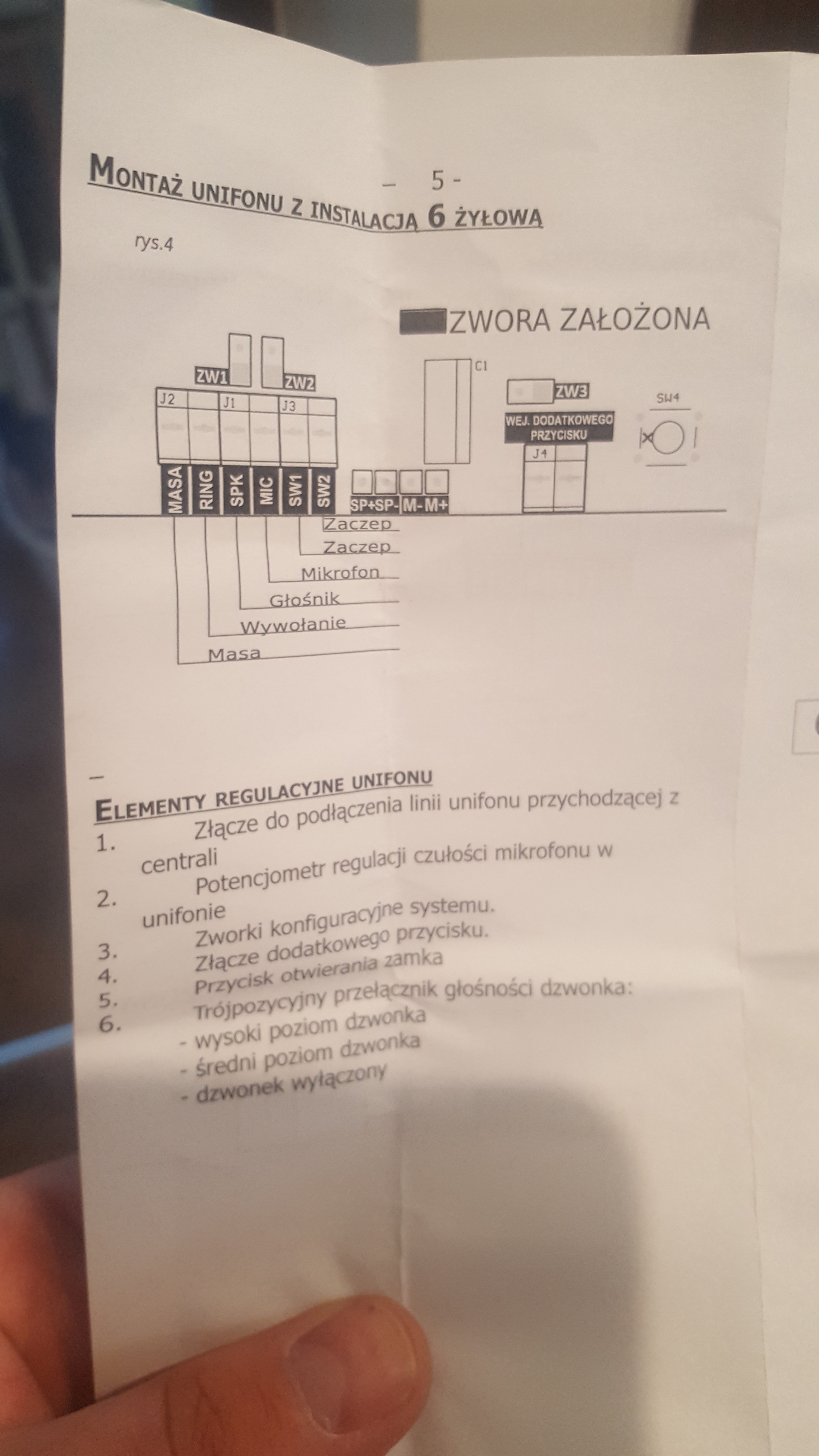

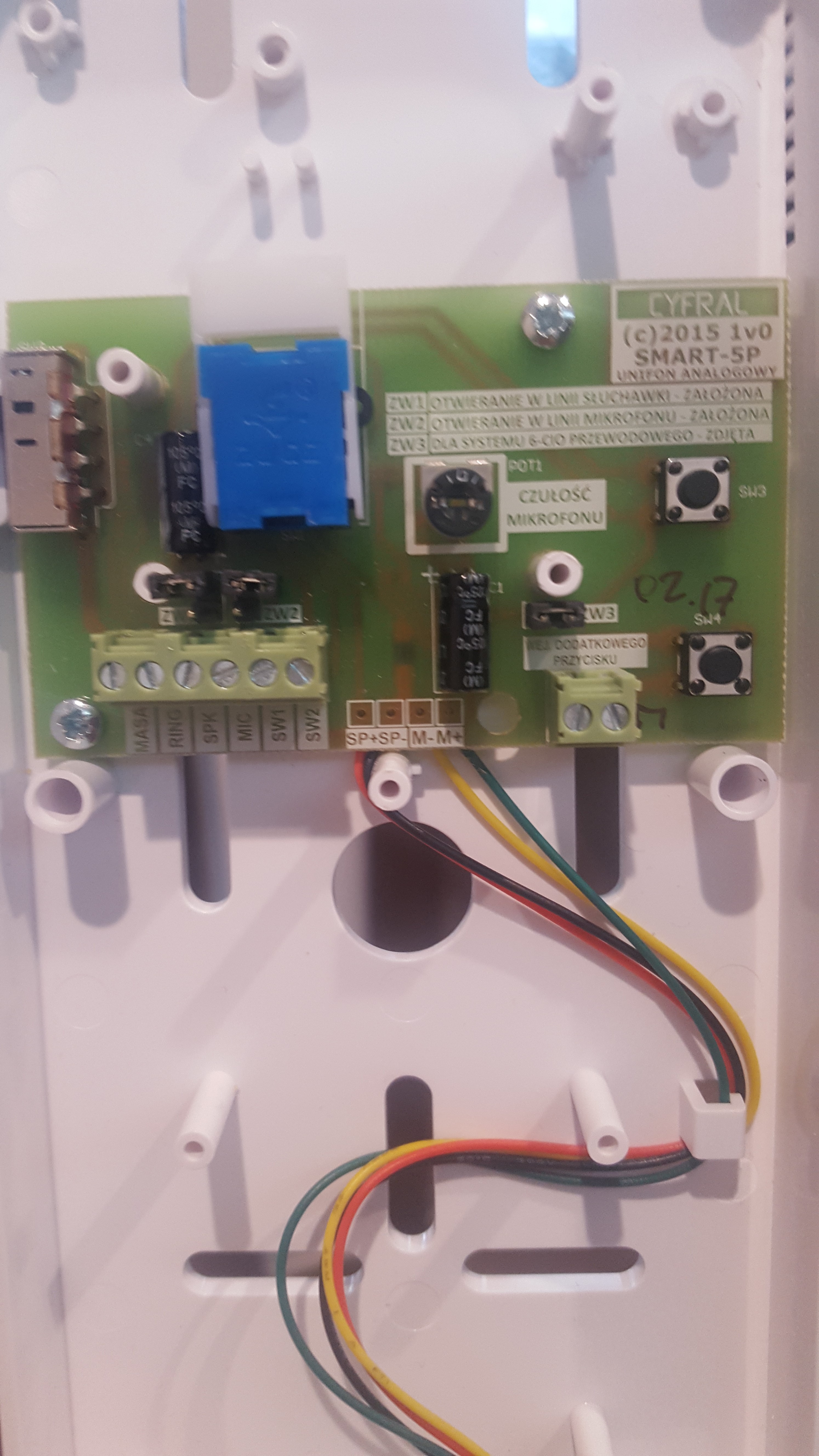

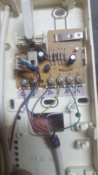

    Hello, I need help in connecting the intercom digital 5 I searched the forum are several similar themes but not exactly the same, I have different cable colors already connected in several ways but ni huhu does not work everything only partially or opening or handset etc. in the attachment pictures of the old and the diagram please if anyone knows how to connect it, and whether this jumper zw3 is to be put on or write otherwise on the intercom on the instructions, thank you in advance Connecting Intercom Digital 5: Cable Colors, Jumper ZW3, and Sequential Steps for Setup Connecting Intercom Digital 5: Cable Colors, Jumper ZW3, and Sequential Steps for Setup Connecting Intercom Digital 5: Cable Colors, Jumper ZW3, and Sequential Steps for Setup

    I have never connected a digital 5p but from what you see after the description of the pcb PCB jumpers1,2,3 must be removed (to be verified on the installation)
    note: everything applies to the situation in which the exchanged urmet uniphone is connected in the original way, as it worked throughout the whole period of operation

    Your old Urmet has 6 cables from the system connected. So probably the installation is 6 wires. However, in this case a bridge between 6 and 10 should be cut (and this is not the case). At this point, the installation is like 5 wires, because 6 (mass) and 10 (hook) are shorted together. If it worked for you without any problems, then do the same in the new Digital.

    in this case it is a bit of a trap, like 5 and 6 veins are shorted together and only together e e starts and meanwhile one of the terminals gets ground through the jumper, it is enough for the fitter to replace white with green, which would normally not matter with 6 wires and we have " wife "with whom no experienced ins. can get lost

    I am fresh after installation everything works ok no problems, however you had to pull jumper No. 3 without the door opening open
