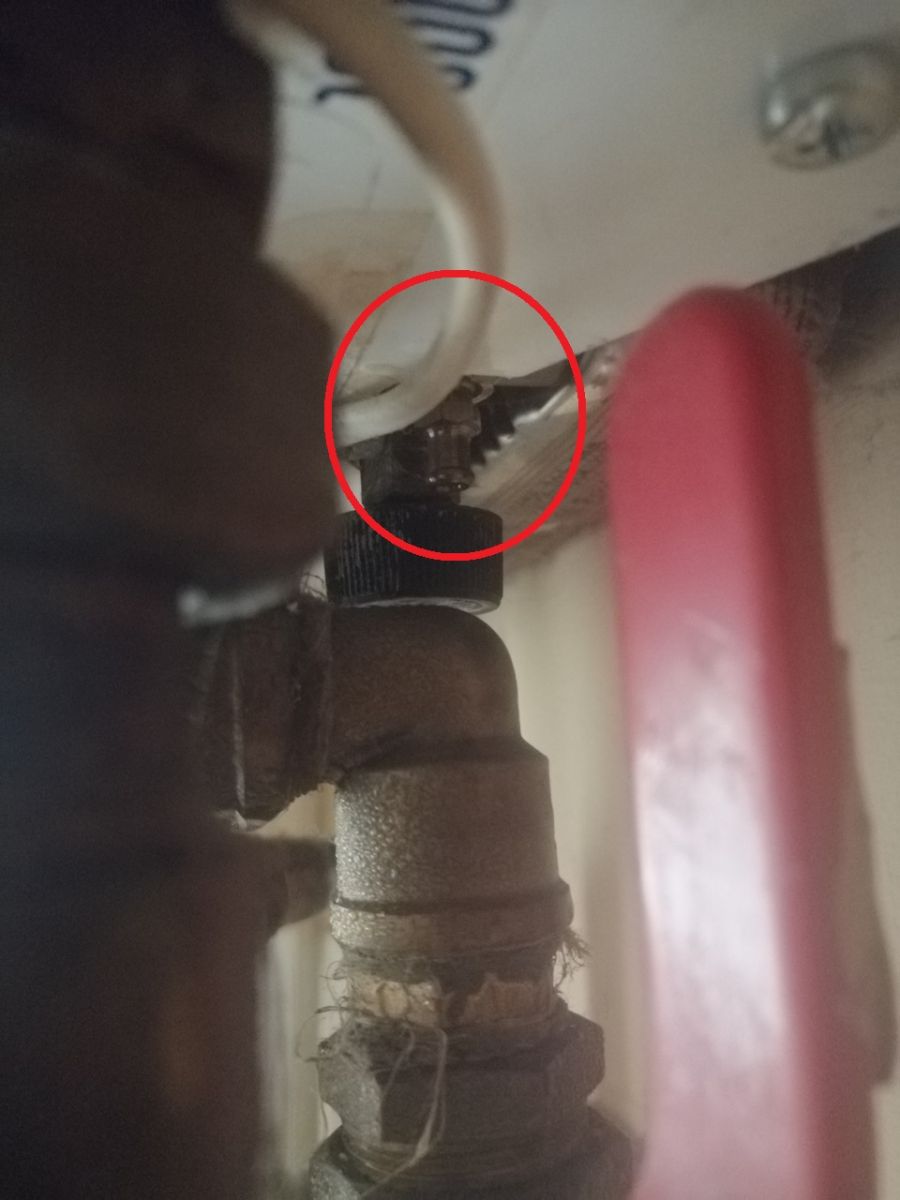

    Please help me find a valve that allows water to be installed.
    I currently have 0.7 bar on a cold stove. You would have to raise to 1.3-1.5
    Is this black?

    Yes. It is an inlet valve.

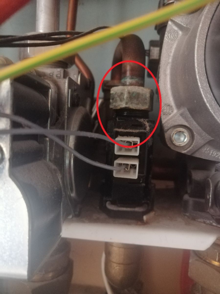

    Gentlemen, I will refresh the topic, I have a Minimax Elegance stove and I have never had problems with admitting water, but wanting to do it today and after determining exactly this black cork, literally nothing happens, there was always the sound of allowed water, and now silence, also on the manometer growing. What and how in this case?
    PS
    At the pipe, which is allowed water, I noticed leaking water on the sensor (or what is it)
    Finding Suitable Valve for Termet MiniMax Dynamic Turbo Installation: 0.7 to 1.3-1.5 Bar
    The second thing is, can I manually let in the water with this "valve" using a hose? it is next to the inlet valve
    Finding Suitable Valve for Termet MiniMax Dynamic Turbo Installation: 0.7 to 1.3-1.5 Bar [/ Img]

    After talking to the service I was informed that the valve must be broken or a stone has settled. How can you clean it?

    Unfortunately, replace the valve.

    These types of valves are not cleaned. Only exchange comes into play.
    If you have the opportunity, let water in just another place on the installation. In an emergency, if you have shut-off valves on the radiator, you just close them, then in place of the plug at the bottom screw the KFE 1/2 inch valve and allow as much as you need. In any case, think about replacing this valve in the oven.

    And you can describe more precisely how to relieve pressure, I'm a little green in this topic. And what I marked in the first photo is leaking from this place and I do not know if it is not replaceable (with these electric wires from under the cap)

    In the last photo you marked the connector. It's a breather and you unscrew it with a ten key until water begins to flow out of it. Just put the hose on it.
    As for the impudence you ask, take a wrench and tighten this nut. If it still leaks, there is a gasket inside (probably plain green paper), just replace it.
