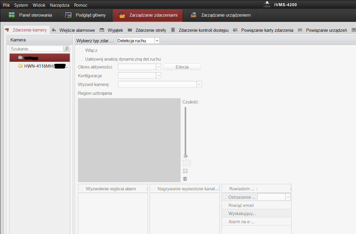

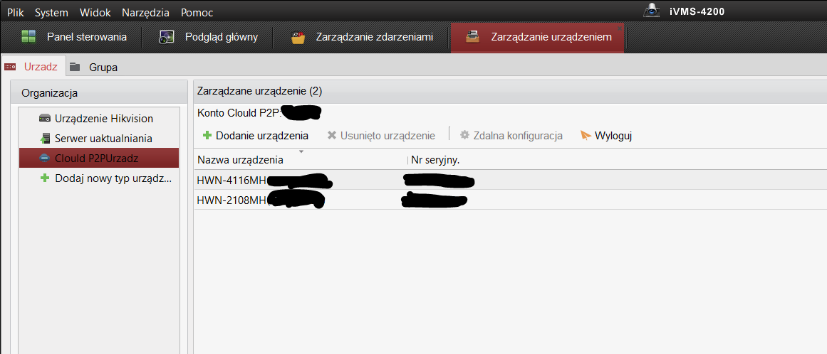

    #17 18416616
    ziemson24
    Hello, I would like to use the topic and develop it a bit.
    Recently, I installed the Hikvision camera system with the HWN-4116MH recorder and I have a question whether it is possible to configure the camera settings remotely, i.e. motion detection from the level of iVMS software from a different network than the one in which the recorder works.
    I am logged in to the cloud (photo) and I have live view from all cameras, but when I enter "Event management" iVMS doesn't see any camera, only an empty recorder folder.
    Is it possible to change the motion detection settings from the iVMS level on a PC from another network and so that these settings will be saved in the recorder after "turning off" the computer?
    Thank you in advance for your help

    @ Ziemson24
    Did you do something?
    For me, even on the local network, this folder is empty.
