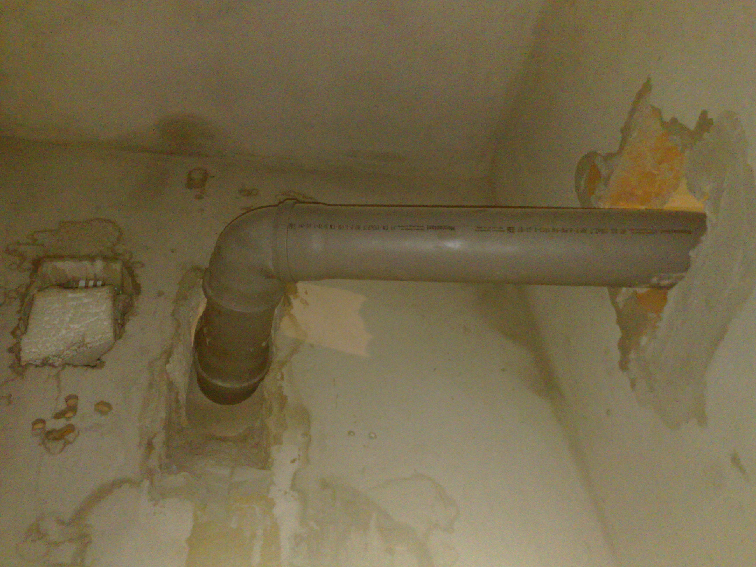

    I have a problem with the chimney sweep.
    At one of the boiler rooms, the chimney sweep made a flue for a 100kW condensing boiler (GB162-100) on behalf of the user
    The boiler outlet is onto a fi110 chimney
    The chimney sweep used a pipe fi100
    The resulting gap was stuck with silicone.
    Chimney Sweep Issue: GB162-100 Condensing Boiler, Fi110 Chimney, Fi100 Pipe, Silicon Sealed GapWhatsApp I...5 (1).jpeg (88.24 kB)You must be logged in to download this attachment. Chimney Sweep Issue: GB162-100 Condensing Boiler, Fi110 Chimney, Fi100 Pipe, Silicon Sealed GapWhatsApp I...5 (5).jpeg (93.22 kB)You must be logged in to download this attachment.
    To make it more interesting, the chimney is made of a pipe without seals. Such as in a chimney for an atmospheric boiler.
    I reviewed the Journal of Laws and did not find a clear ground to challenge this chimney.
    I really want him to improve his job.
    I fought in this boiler room for several years with a PVC chimney
    When they finally found the money and called a chimney sweep to fix it, he did it ...
    From the rain under Plantage :(
    Is there a record in any standard what criteria must be met by the boiler chimney
    condensing. Pressure chimney with wet exhaust gases.
    Where to look for it?

    There is probably a record that says that the chimney cannot have a smaller cross-section than the one coming out of the boiler.
    You must look for in EU directives. Our laws and norms do not go with the times.
    Alternatively, hit Buderus.
    #3 16814158
    irus.m
    Heating systems specialist
    Posts: 1248
    Help: 122
    Rate: 453
    Requirements for the conditions that must be met by flue systems are in the boiler specification and installation conditions. In such a system there is considerable overpressure and must be sealed with gaskets. Condensate flows into it.
    Chimney sweep, say that there is such a thing as reducing the diameter.
    What was happening?
  • #5 16814635
    piracik
    Posts: 4060
    Help: 557
    Rate: 1976
    It was illegal. But when it came to tightness it was definitely better :)
    The chimney was made of gray sewage pipe.

    If the chimney length does not exceed 5 m, the diameter condition is met for this boiler (installation instructions GB 162-100). Gaskets should be due to excess pressure and condensate. In general, the regulations direct the manufacturer's recommendations.
    Sewer pipes are not allowed. They are special made of plastic. However, Buderus reserves that: "It is forbidden to use systems in Poland
    flue gases made of plastics
    artificial (Journal of Laws No. 75/2002) "

    The boiler manual also does not clearly specify what the chimney should be.
    The length is over 11m so even for 110 it is too long.
    I wonder what they'll say in Buderus
