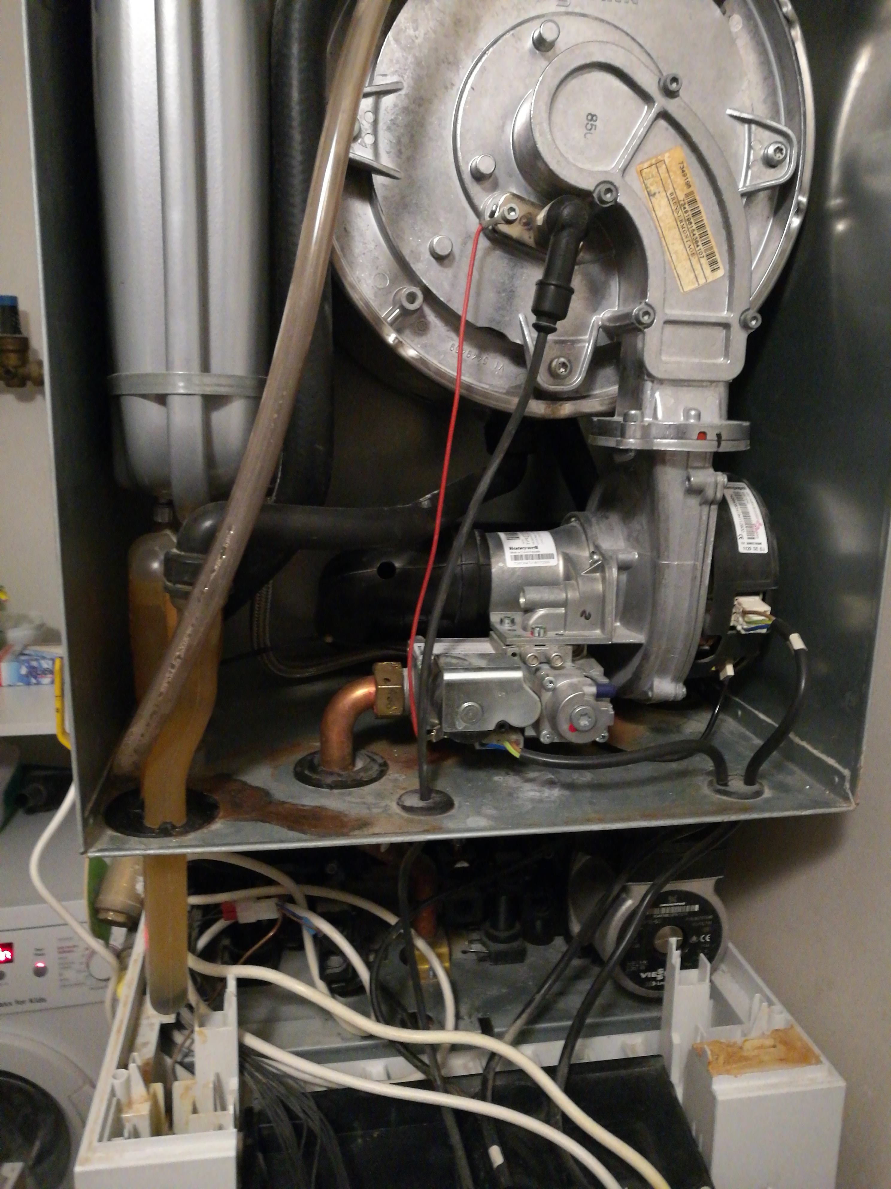

  • #34 16817980
    Sa1rus
    Posts: 24
    Rate: 24
    If it is the one behind the panel, I do not see any regulation anywhere
    • Stove Reaching 70-80 Degrees, But Radiators Remain Cold: Heating Issues 1510492550665114767356.jpg (2.67 MB) You must be logged in to download this attachment.

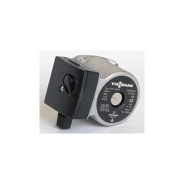

    It may not be.
    The switch looks like in the photo below. That black toggle on the electrical box.

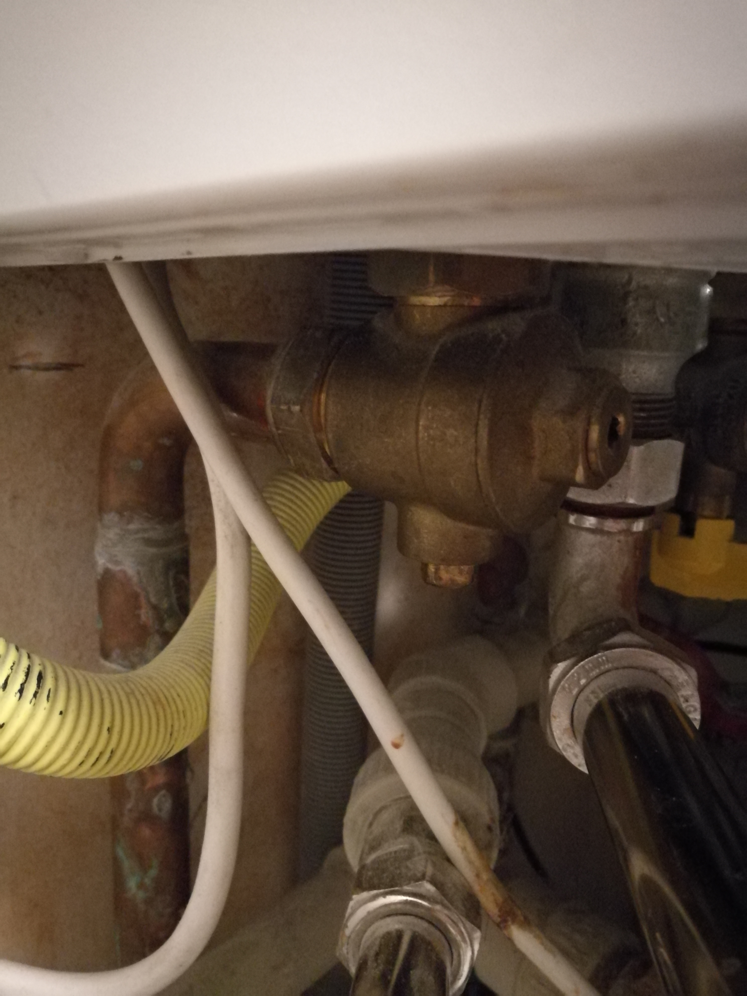

  • #36 16818024
    Sa1rus
    Posts: 24
    Rate: 24
    Well, there is no regulation, when it comes to this coil, when there was a service technician, he drained the water into a bucket And there was some black muck in the coil, earlier there was a problem with these noises from the stove (but the stove was heating) as you wrote, but how to overflow ukal, so far it is quiet, but it does not heat, maybe he forgot to unscrew the valves, he did not unscrew one, maybe and the service technicians also not, how can they look? Are these these?
    • Stove Reaching 70-80 Degrees, But Radiators Remain Cold: Heating Issues IMG_20171112_142018.jpg (2.14 MB) You must be logged in to download this attachment.
  • #37 16818040
    piracik
    Posts: 4060
    Help: 557
    Rate: 1977
    This one is open. The other side is the same. The notch on the valve is to be along the pipe. Check this square from below with a notch.
    Look for the second valve somewhere under the filter and check if it's open.
    I wouldn't trust a service technician to clean this filter.
    Personally, I very often come across a dry condenser in the pump. As a rule, if it is below 70% of its capacity, problems with the flow begin.
