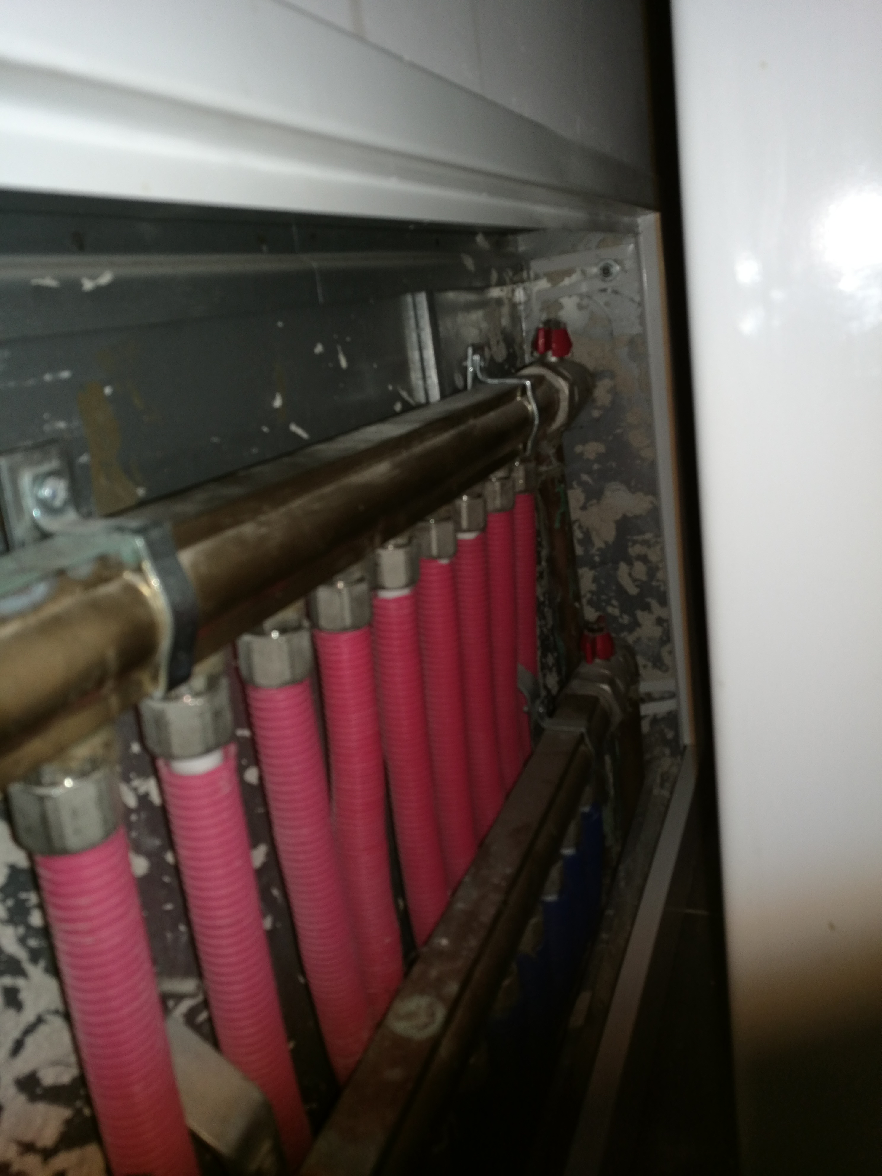

  • #14 16817466
    Sa1rus
    Posts: 24
    Rate: 24
    The radiators were left untouched (previously there was no problem), the valves were unscrewed, and how to check if the pump works without unscrewing it?
    Photo of the installation
    Stove Reaching 70-80 Degrees, But Radiators Remain Cold: Heating Issues

  • #26 16817889
    Sa1rus
    Posts: 24
    Rate: 24
    piracik wrote:
    Unfortunately, the photos do not show the manifolds mentioned.
    The pump that you can see is a circulation pump installed rather on DHW and has no effect on central heating.
    • Stove Reaching 70-80 Degrees, But Radiators Remain Cold: Heating Issues IMG_20171112_134645.jpg (3.56 MB) You must be logged in to download this attachment.
    • Stove Reaching 70-80 Degrees, But Radiators Remain Cold: Heating Issues IMG_20171112_134744.jpg (2.21 MB) You must be logged in to download this attachment.
    • Stove Reaching 70-80 Degrees, But Radiators Remain Cold: Heating Issues IMG_20171112_133707.jpg (2.25 MB) You must be logged in to download this attachment.
    • Stove Reaching 70-80 Degrees, But Radiators Remain Cold: Heating Issues IMG_20171112_133702.jpg (3.53 MB) You must be logged in to download this attachment.
  • #27 16817897
    piracik
    Posts: 4060
    Help: 557
    Rate: 1977
    Look for a filter on the return from the system to the boiler. But not on the pump tube.
    If the filter is clean, replace the condenser in the pump, but the one in the boiler.
    There are also service valves under the boiler. The question is whether they are open. The one on the left looks open.
  • #28 16817914

    Are you talking about the green one under the cauldron?
  • #30 16817928
    Sa1rus
    Posts: 24
    Rate: 24
    Is it on the return the one in the picture where you can see the pump?
