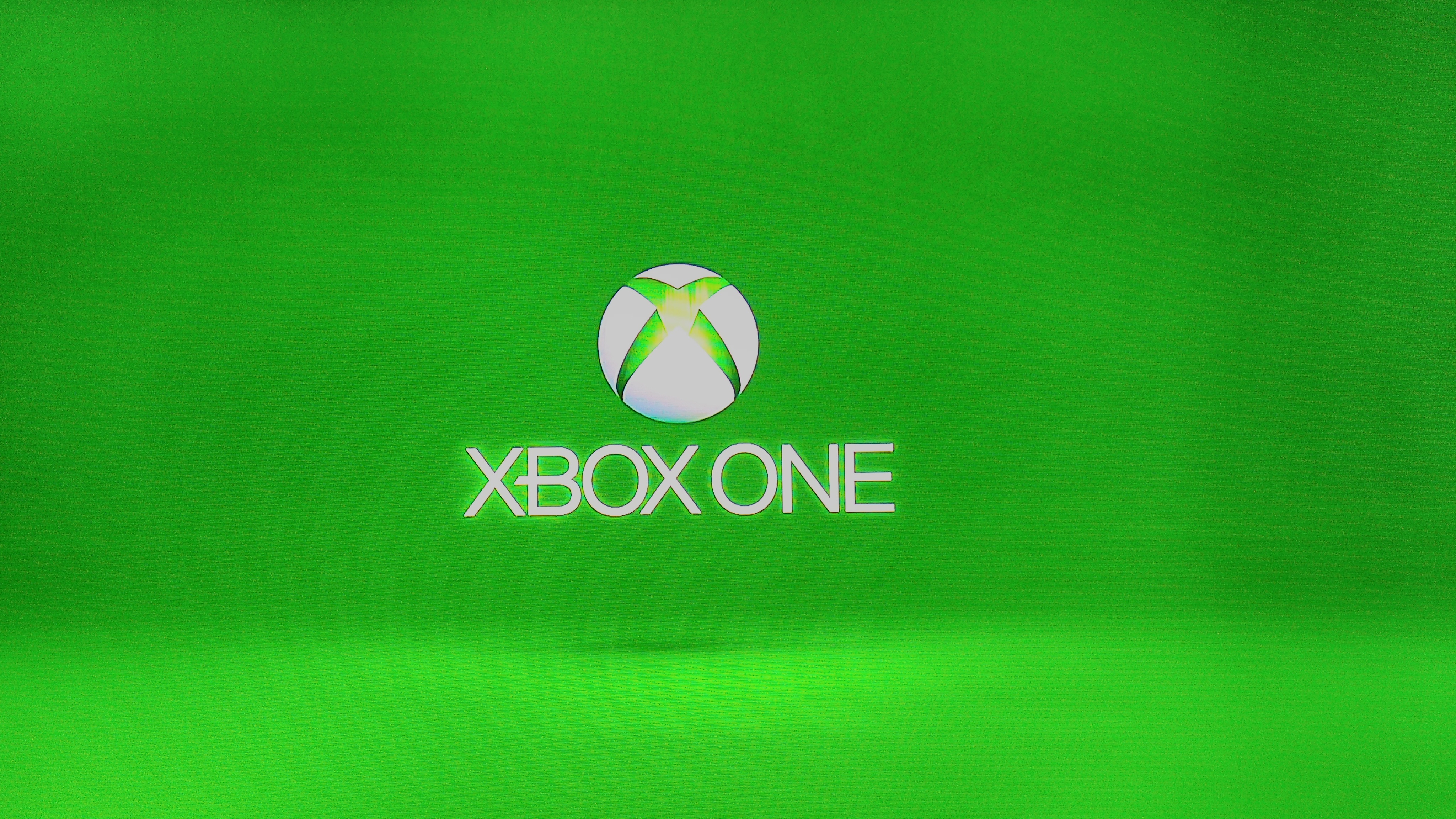

What could cause a first-generation Xbox One to get stuck on the green Xbox logo screen at startup, and how can I fix it?
Most likely the console failed during a silent update or after a power/write interruption, which can corrupt the boot/cache state and leave it hanging on the green logo screen [#16989685] First, let the console freeze, unplug the power cord for about 30 seconds, and try a cold restart [#16989685] If that does not help, perform an offline system update from a USB flash drive and use safe mode: prepare a USB drive of at least 4 GB formatted as NTFS, copy the $SystemUpdate folder to the root, turn the console fully off, then hold BIND + EJECT while pressing the Xbox button until you hear two power tones [#16990427] If you are on a wired network, disconnect the network cable before doing this; Wi‑Fi does not matter until the system is loaded [#16990427][#16990489] If the update still fails, try the OSU2 package first and then OSU1 [#16990427]

    After starting the console, a green screen with the xbox logo appears as in the picture in the attachment and it still does not start.
    Please tell me what the reason could be. :cry:

    Probably after the "silent update" there was a power outage or other write problem, the console might as well not clear the cache and therefore hangs on boot, there are several options.
    First, start the console, wait for it to hang up and unplug the power cord for about half a minute.
    Please try to restart.
    What kind of console is this? is the first generation Xbox One or the Xbox One S or X?
    If the power reset doesn't help, you will probably need to do an offline update using pendrive (I hope you have) and safe mode.

    How can I update offline?
    xbox one of the first generation it is
    Sorry, that is what I'm asking, but I'm dark about these console bricks. I am asking because my son has just hung up.

    Prepare a pendrive formatted with the NTFS system with at least 4 GB of space.
    Disconnect the network cable if you are using a wired network connection.
    Turn off the console, and then unplug the power cord to make sure that the console is completely turned off.
    Wait 30 seconds, and then reconnect the power cord.
    Press and hold the BIND button (on the left side of the console) and the EJECT button (on the front of the console), and then press the Xbox button on the console.
    Hold down the BIND and EJECT buttons for 10-15 seconds.
    You should hear two power-up tones successive seconds apart. You can release the BINDING and EJECT buttons after the second power-on signal.
    You should see the "troubleshooter" screen when you turn on the console power
    AND) If you don't see the Xbox startup troubleshooter screen, follow Steps 1 and 2
    B) If you see the Xbox startup troubleshooter screen, only follow part 2 of the instructions.

    And if I use wifi in the console, I will definitely have to disconnect the wifi, right?
    #6 16990489
    roxio
    Posts: 642
    Help: 108
    Rate: 213
    not. basically, until the system is loaded, wifi does not work.

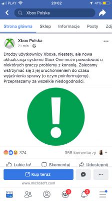

    I have a question, my console has crashed after starting the Microsoft Store update, now after starting I have a black screen when I press the launch button on the pad to display the sidebar, there is only it and nothing can be done I restored the console to factory settings and then I do not know what to do Is the console for the service or maybe it is possible to manually save the photos below nothing, just nothing reacts, even logging in to the account is impossible, please help

    Probably padly servers - I have the same, and the support page does not go into support.xbox.com/en-ww/

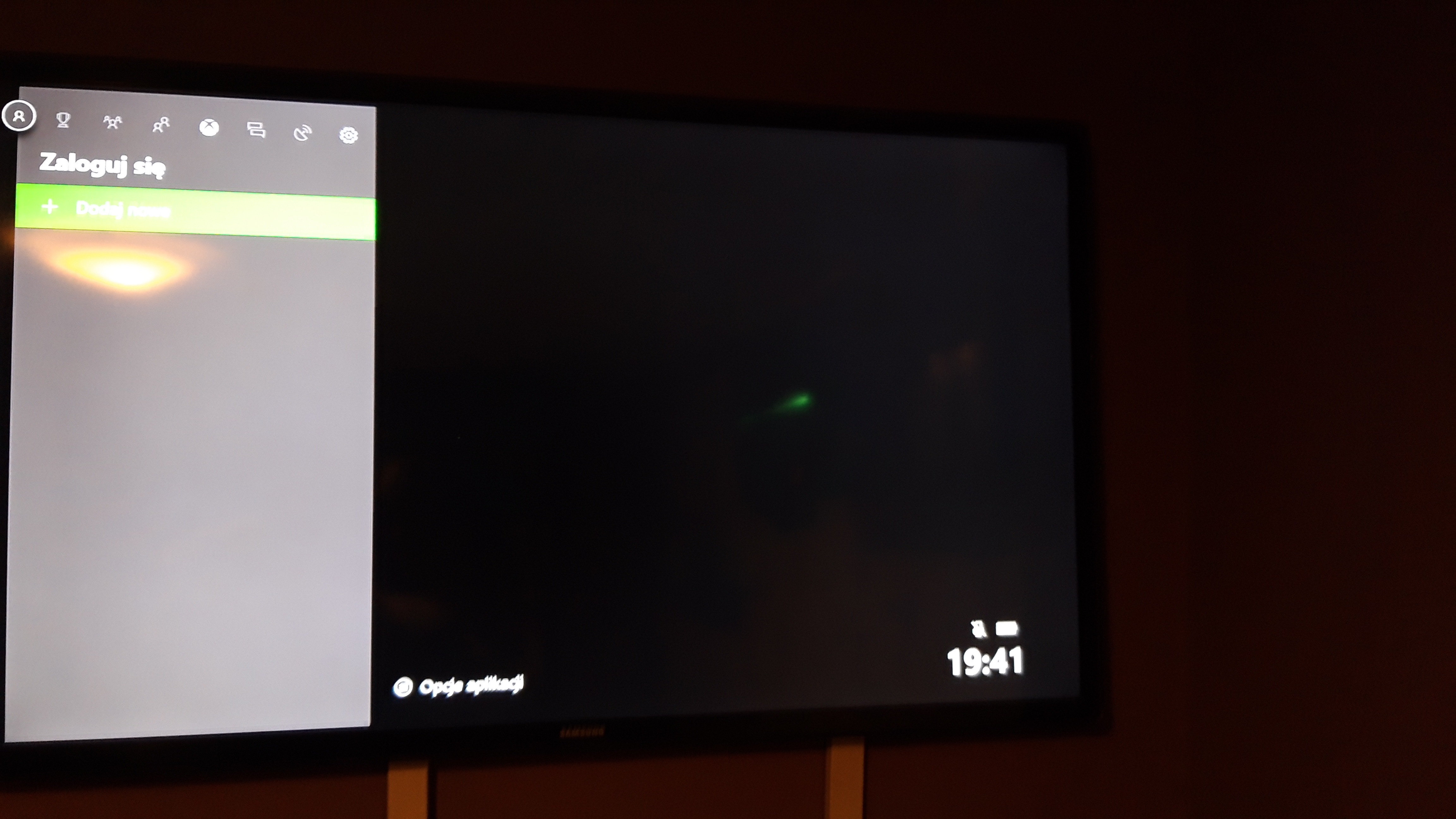

    The same problem just came up. the console hangs after the startup screen and there is only a bar on the left with which you can do nothing. I guess it's some kind of upgrade problem on a larger scale. After disconnecting the console from the network, it works normally

    [quote = "BlackSteed" Works normally after disconnecting the console from the network [/ quote]
    Confirmed info, same
  • #20 17743155
    BlackSteed
    Then I'll leave it until tomorrow, maybe it'll fix itself ;)
