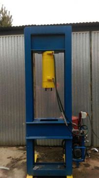

How many M16 bolts are needed to mount a press table that may be loaded by a 70-ton hydraulic actuator?
For this kind of press table, the replies say the load is not just pure shear; bending also matters, so the bolt layout and whether the bolt works in single or double shear are important [#16826946] One answer gives an M16 class 10.9 bolt shear capacity in the threaded section of 62.80 kN and says you need 6 screws, 3 on each side [#16825236] Another reply says that if one bolt goes through and is sheared in two places, 6 screws are enough, but if not, you need 12 screws [#16825396]

    I made a hydraulic press. The actuator can push 70 tons. I wonder how many bolts should the M16 8.8 bolt table be mounted on. Currently, the table is on four screws (one for each corner of the table). How much can one M16 8.8 bolt withstand (I cannot mount the rod, there must be bolts)? Photo illustrative device.

    @sanfran. I bought such screws. There was no longer any stronger. As you can see, I have two types. Is anyone able to answer my question above?

    The shear capacity of an M16 class 10.9 bolt in the threaded section is 62.80 kN. You need these 6 screws, 3 on each side.

    If I count correctly, one M16 bolt with characteristic 10.9 has a shear strength of 120kN.
    Assuming that the tensile strength is 1000 N / mm2 - 1000000000Pa (one billion Pascals), the active surface area is 200 mm2 (0.0002 m2) and the factor is 0.6.
    Since the area of the threaded part may be slightly smaller, and you need to add a safety margin, I would suggest multiplying the result by 0.6, which will give us about 70kN per bolt.
    Please check my arguments.

    I am very grateful to you! Need 6 screws in total? Because I've already drilled a total of 12 3 for each of the four table legs

    Depends on whether one bolt goes "through" and is sheared in two places? If so, you need 6 screws. If not, then you need twelve screws.

    Therefore, in the formula from post reference # 2 there is a factor of 0.6.
    To compensate for the difference between the spindle and the thread, I also chose a factor of 0.6 - as you can see, my technical college news has not yet aired until the end.

    the table fits quite closely to the frame, so I don't know. Will these 12 screws last?
