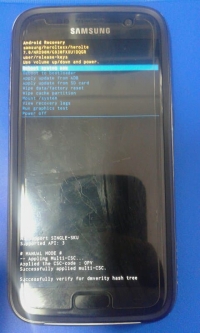

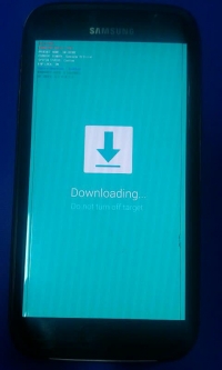

    So the situation looks like this:
    - when I press the VOL- HOME Power buttons it pops up such a window:
    Samsung Galaxy S7: Unauthorized OS Modification, USB Debugging Issue & Software Update Failure
    - like dam VOL + this message appears:
    and at this point nothing is drawn just hanging.
    There, at the top, it says:
    ODIN MODE
    DOWNLOAD SPEED: FAST
    PRODUCT NAME: SM-G930F
    CURRENT BINARY: Samsung Official
    STATUS system: Custom
    FAP LOCK: ON
    Secure Download: Enabled
    VOID WARRANTS: 0 (0x0000)
    AP SWREV B: 1 K: 0 S: 0

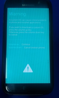

    -a dam VOL + HOME Power pops up such a window:
    How should I check this flag?

    Flags do not have, as you have in download mode to connect under the computer and upload the odinem soft which you have to download, the smart switch will do it yourself, but somewhere doing something wrong.
