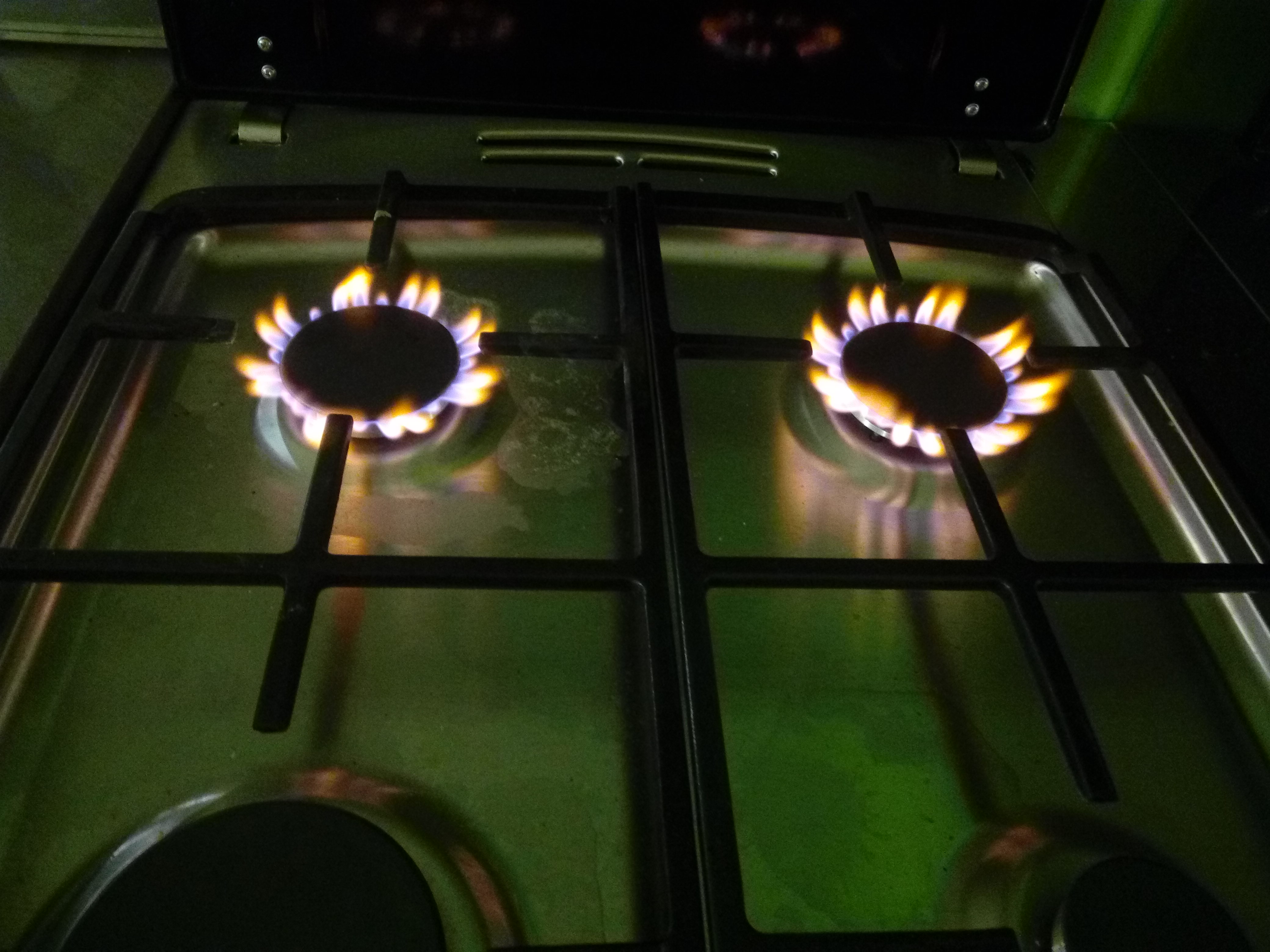

    Hello, is the color of the flames of the burners from the picture correct? After downloading the knob is only the adjustment of the burner saving, I have not seen the air regulation. I am asking for help in the subject, I do not know if it is suitable for regulation or to leave as it is. The natural gas supply, the floor below the stove has a perfect blue sharp flame.
    Where can you find the air regulation knob if it does occur?

    There is no adjustment, the burner construction produces a mix. Maybe the burner covers are already burned out?

    The stove is new. Burners and nozzles clean as a tear. I use 2 months. Are you sure that there is no air regulation in it? It is such an invention as in the picture.

    Now the color is worse. I'm surprised by the max. The lower floor is a cooker from the same company. Structurally the same. The flame is blue.

    Maybe you have mixed up nozzles in the burners? Or buy a new set of nozzles and replace - this is not the expensive event.

    I came up with a certain clue, namely, I use a nebulizer for a child who has a cold. I pour in a solution of water with salt bought in a pharmacy for inhalation. The fact that I use it 8metrow from the stove can testify to the ionized air spreading around the house. In the morning the flame is almost completely blue. I will follow the topic and let me know if the reason is just a nebuliser.

    The fumes of a sodium chloride solution floating in the air, generated by this inhaler. Sodium, as it is known, stains the flame in yellow - orange. :D

    Or you have gas pressure drops in the installation.

    The problem is solved, the reason is a nebulizer for children's inhalations which disperses cold salt mist in the air. To my surprise when I use it, the torch flame turns yellow. In the morning when it is not used, the flame is perfectly blue. Interestingly, the inclusion in the room located at a distance of 8 meters from the stove does not do the trick, air ionization is distributed throughout the apartment. If someone uses a nebulizer, moisturizer, ionizer in the apartment, unfortunately must take into account such an effect is visible for several hours. I hope to help someone with a similar problem, instead of regulating the equipment, analyze the topic.
