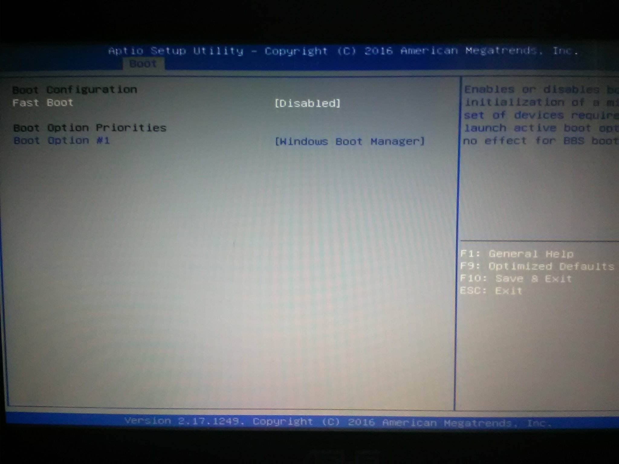

    I created a bootable USB stick with Linux Live USB Creator and the problem is that the notebook doesn't want to boot from it at all, it just starts up as usual "the computer has not been started properly". After entering "UEFI firmware settings", Aptio Setup Utility pops up and this is what the "Boot" tab looks like:
    Asus E200H Notebook: Windows 10 Automatic Repair Loop, Reset & System Restore Issues
    In "Boot Option Priorities" only "Windows Boot Manager" or "Disabled" can be selected.

    Change to legacy boot and set it as a priority, it will start.
