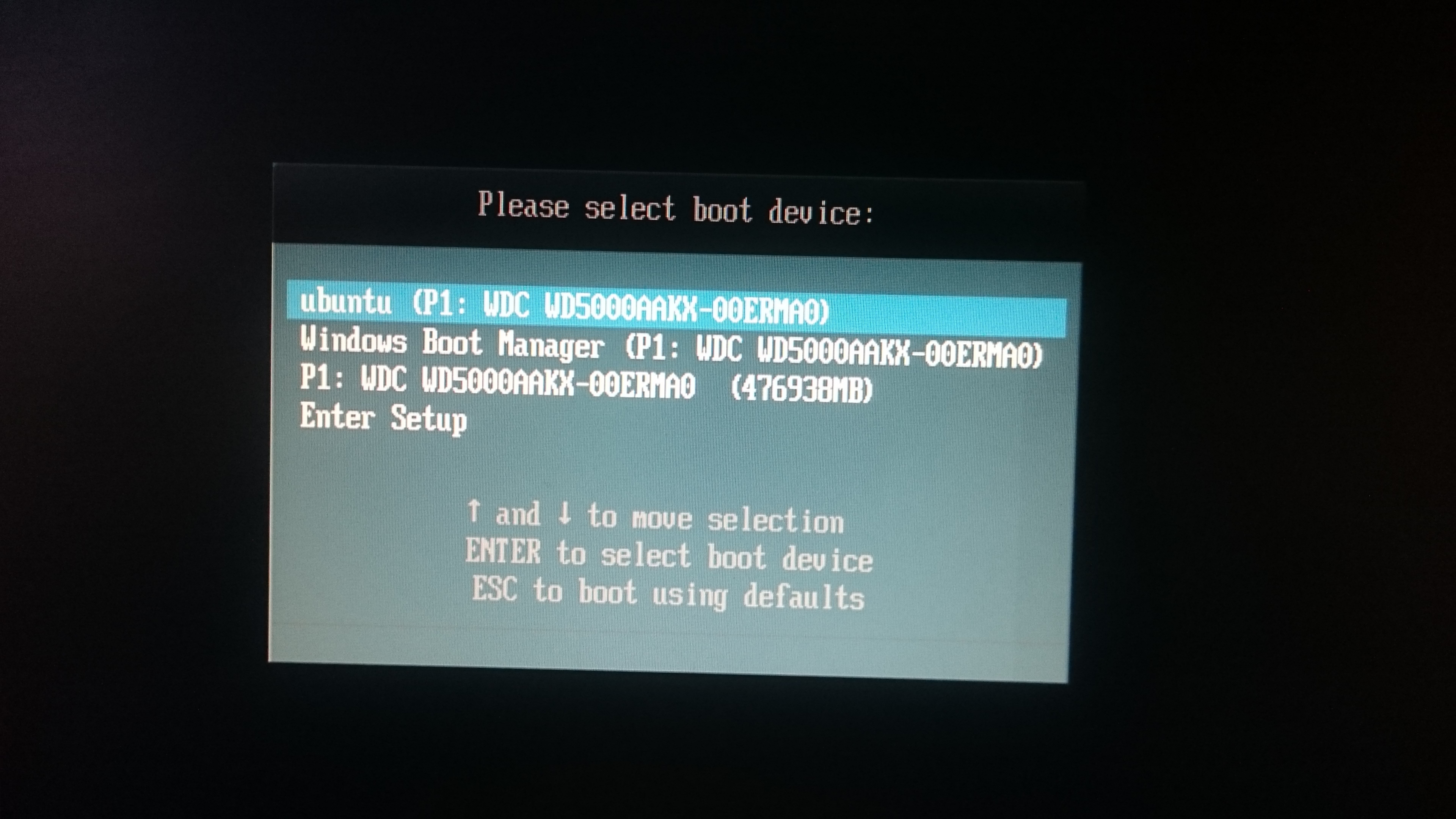

    Blue menu? Upload a screen. When you start your computer you press the F8 key for a while (about 5 seconds).
  • #5 15574951
    papen105
    Posts: 14
    Rate: 22
    My boot menu turns on.
  • #6 15574984
    Hackmsr
    Posts: 757
    Help: 26
    Rate: 80
    And what are your positions there?

    This is the boot manager menu. I mean pressing F8 for a few seconds when the computer starts up. Before starting the system boot.
  • #9 15575006
    papen105
    Posts: 14
    Rate: 22
    That's what turns on then, such a bios

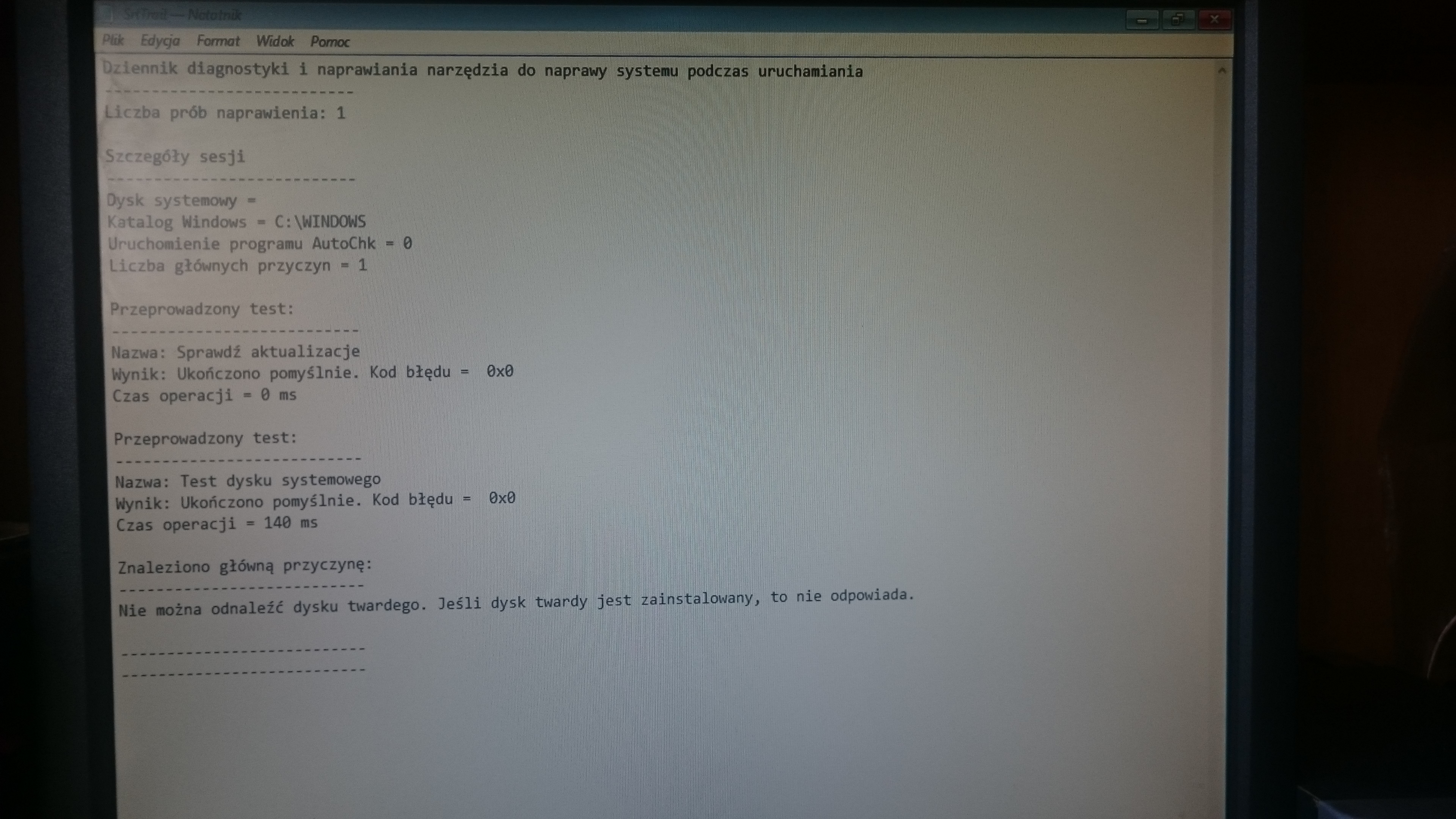

    I have already done it, but there are the same errors as before, so I entered the diagnostics and repair log of the system repair tool during startup via cmd and such a thing popped up Persistent Automatic Repair Loop in Windows 10 - Disk Lock Issue
  • #18 15576091
    Hackmsr
    Posts: 757
    Help: 26
    Rate: 80

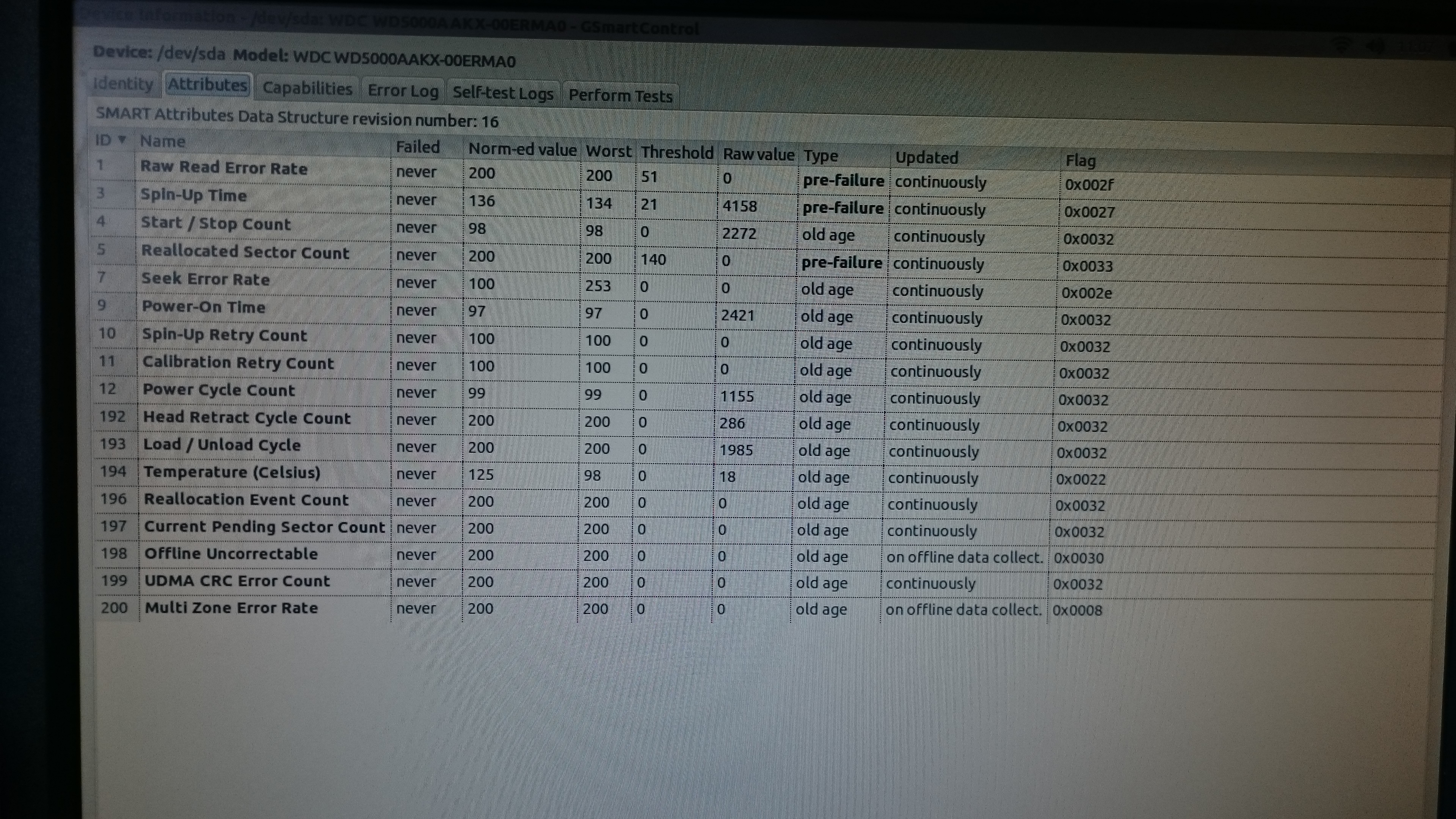

    As far as Windows is telling the truth, there is something wrong with the hard drive. Provide SMART disk. Check the RAM MemTest and provide the hardware specification.
  • #19 15576322
    papen105
    Posts: 14
    Rate: 22
    Specification:
    Intel core i7 3770k 4x3.5 GHz
    4 GB RAM Kingston hyperx
    Intel HD graphics 4000
    Modecom 620 W power supply
    WD5000AAKX-00ERMA0 500GB WDC disk
    ASUS p8z77-v pro motherboard
  • #20 15576372
