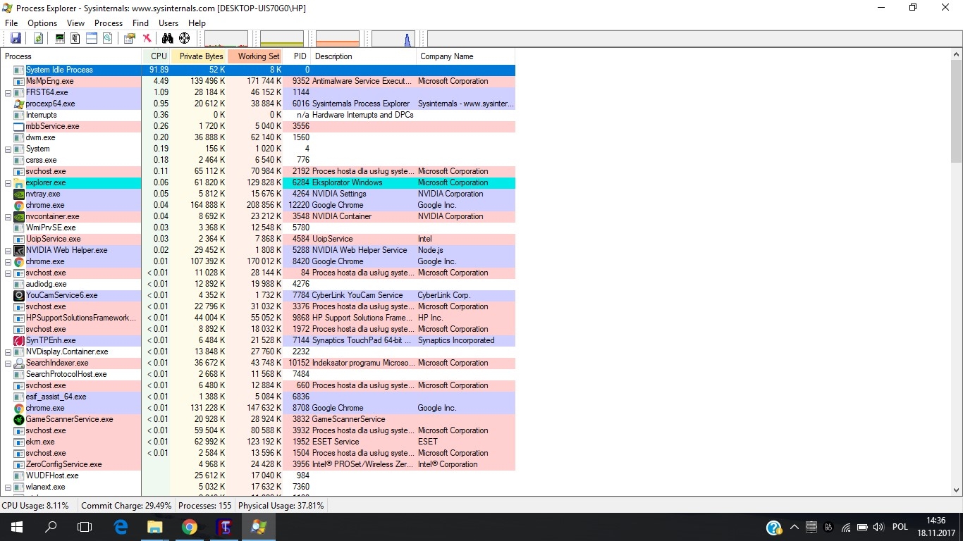

    Witam
    Mam następujący problem po aktualizacji systemu windows 10 komputer strasznie zwolnił a zużycie dysku wzrasta czasem do 100 procent i laptop strasznie się grzeje . Chciałem zrobić format z dysku recovery jednak został on usunięty i nie da się tego zrobić z systemu bios oraz w inny sposób .
    poniżej wklejam log z hijack

    Start by prophylactically administering SMART disk from CrystalDiskInfo.
    Do not paste logs into the content of the post, as it clutters the topic. Add logs as TXT in the attachment, or put them as a spoiler with the code:
    [spoiler]
    treść
    [/spoiler]
    We don't use HijackThis anymore. Now FRST is "on top":
    https://www.bleepingcomputer.com/download/farbar-recovery-scan-tool/
    however, according to I have little chance it's an infection.
    Another "story" that windows is best installed "clean" instead of overlay.
    As for the "silting up", it is probably already depending on the speed of your internet that you can download corrections.
    You have to wait patiently.
    You can post a screen of ProcessExplorer with processes sorted by CPU and disk usage for viewing:
    https://www.elektroda.pl/rtvforum/obrazki.php

    Now wait or send this PE screen.

    The load you mentioned cannot be seen. Has the computer "calmed down"?

    He "calms down" for a while and then he starts freaking out again, stuttering.
  • #10 16832165
    safbot1st
    Posts: 21951
    Help: 2719
    Rate: 1585
    So take a view from PE when he "goes crazy".
  • #11 16832180
    Chudy889
    Posts: 14
    The one above was from that moment.
