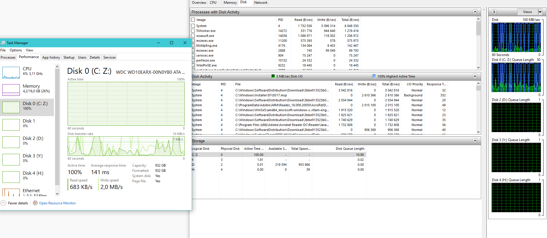

    The problem concerns Windows 10 Pro 64bit (upgrade from win7 pro 64). For some time (2-3 months) while loading * .wav files (several dozen MB) in the editor I experience long delays before the file is loaded. This is not a rule, but it happens often - sometimes it loads files in a split second, sometimes you have to wait up to half a minute, regardless of the file size. Since checking the memory and disks did not show any errors, I decided to reinstall the editor, but unfortunately it did not help. I noticed that the system disk usage is constantly at ~ 100%. Applications run very slowly lately - I waited almost half an hour for the program installer to start today. I thought maybe it was the windows updates so silent, so I turned off the network, but the problem persisted. Anyway, they probably wouldn't silence in constant mode ... Antivirus software has not detected anything suspicious so far, so at the moment I am helpless.
    Please help. In the SMART attachment from disks and sreen from temporary wear.

    You can see that all this updates -> SoftwereDistribution directory.

    But that so? It's really impossible to work efficiently, people in the environment don't have similar problems ... Can you somehow limit it? Earlier such miracles did not work. :( ((
    EDIT: Okay, the updates are over, they are no longer in the resources, disk usage jumps normally and reaches 70%, and the lag problem is still ... So I conclude that maybe it is not updates. The more that the problem exists practically constantly.

    lmrb714 wrote:
    Because checking the memory and disks showed no errors
    It showed wrong.
    Interpreting SMART:
    (2) WDC WD1001FALS-00J7B0
    05 197 197 140 000000000017 Number of sectors allocated
    C4 _55 _55 __0 000000000091 Number of reallocation operations
    C5 200 200 __0 000000000003 Number of unstable sectors (waiting for remapping)
    This disk for replacement (relocated sectors).
    (4) WDC WD5000AZRX-00A8LB0
    01 200 200 _51 000000000052 Number of read errors
    Show MHDD surface scan with visible sector access times =>
    http://www.nirvanowiec.republika.pl/MHDD.html

    With all due respect and gratitude for dealing with my problem for free, but this bad sector disk is basically unused, it is connected in total, but there is no partition on it. In the case of the next one - this is the disk from the archive, encrypted and not used actively, so it also does not affect the operation of the disk (1). Although I was intrigued by these errors, I will try to do this MHDD scan in my free time.

    I have interpreted SMART readings so that you know the condition of the discs.
    Try to disconnect them completely (if you can) and write what effect.

    Unfortunately, no improvement. :( Windows 10 Pro 64bit Performance Issues - Slow .wav File Loading and High Disk Usage
