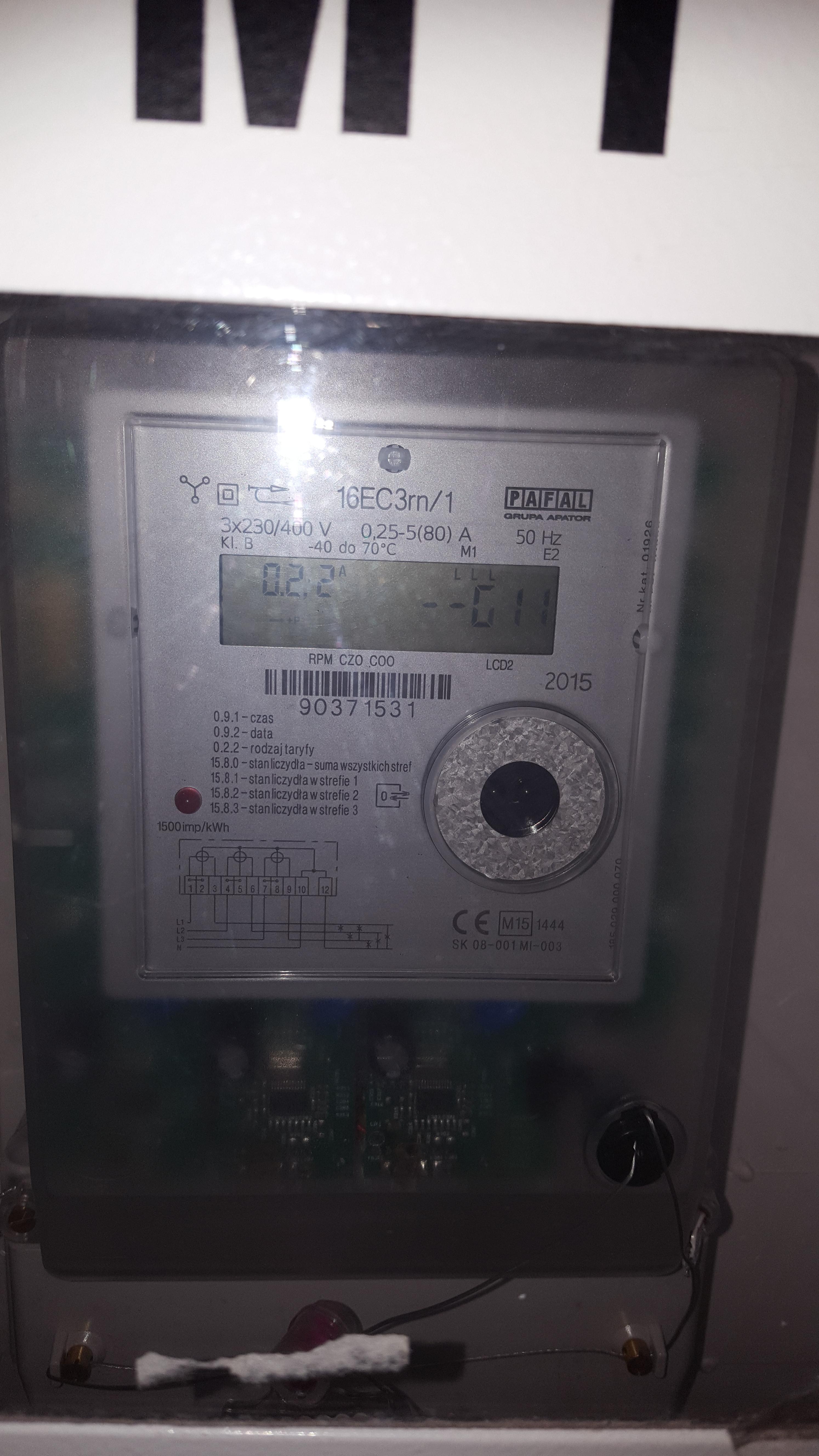

    I bought an apartment some time ago. Maybe the previous owner mentioned something about electricity, but now I don't remember.
    How do I know if I have "strength"? Does something indicate this, for example in the fuse box? The electrician will be here in a few days.

    Give a photo of the meter or switchboard in the apartment.

    This is called a 3-phase installation.
    If you have 3 fuses in the staircase in front of the meter, or one triple fuse, it means that the apartment has a 3-phase installation.
    If you have only one fuse, it means that the premises do not have a 3-phase installation.

    Thanks for the answers. I can't check much because the administration has put a "wardrobe" on the cage and everything is locked. Pre-meter protections not available to me. the main fuse is a "triple" fuse. my counter in the photo. I noticed that each apartment has a different meter.
    And I ask for induction, of course, but out of curiosity, before the electrician watches everything. I prefer to mentally prepare myself for additional expenses in advance ;)

    This is a three-phase meter so you have "strength".

    Oh, that's cool. so I hoped looking at the diagram at the bottom left :)
