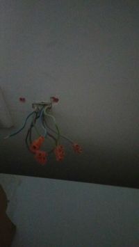

    Good day. I know that there has already been a similar topic, but it is closed. We bought an apartment after renovation and we have no idea if there is strength in the apartment. Cables come out by the oven that supposedly indicate it is there. Is it enough or should we check it somewhere else? I will be very grateful for your help!

    The photo below with a 4-pole RCD indicates that there may be a so-called "strength"
    Nothing could be more wrong :D

    Most electric stoves work in 2 phases, when using 2 "burners" one phase is used after switching on the other 2 phases - check very simply - how many wires protrude from the wall near the stove, if more than 3 is the so-called "force", and you have to be careful with connecting so that by accident all 3 phases do not go to the power supply - I was repairing such an indesit cooker - high power transistors from the welding machine could be selected

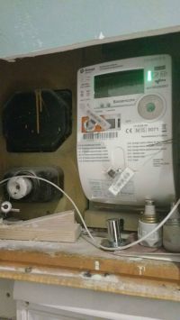

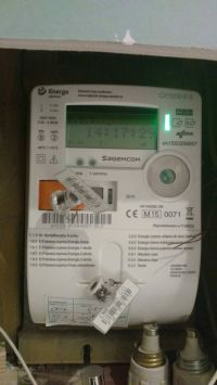

    Verifying Electrical Strength in Newly Renovated Apartment: Practical Guide Verifying Electrical Strength in Newly Renovated Apartment: Practical Guide Verifying Electrical Strength in Newly Renovated Apartment: Practical Guide Verifying Electrical Strength in Newly Renovated Apartment: Practical Guide
    I don't know if that's it - I'm just pasting some photos

    1-phase power supply.

    Sorry, but there is no "strength". As I am writing, my colleague Peter134 is a 1-phase power supply.

    Our main plug burned out recently, it was 32 amps in front of the counter. Is that the point?
    Probably the "main plug" preceding the one in the photo attached by my friend "burned".
    The photo is weak, but the "eye" of the insert looks gray. So 16A -> 3.7kW.
    Anyway, the base and the head support max 25A.
    It is not known what power is in the contract or how much power is currently available.
    But anyway, adding a high-power receiver can be quite backbreaking and a 7.6kW kitchen is not feasible at all without increasing the power and rebuilding the installation.

    Dyta wrote:
    We recently burned this main plug, in front of the counter, it was 32 amps
    While this black BiWts to the left of the meter is a pre-meter protection, the MAX 25A fuse will enter its head, so it is impossible to install 32A.
