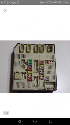

    Hello. I need help fixing the fault, but maybe from the beginning.
    I wanted to replace the bulb with the license plate light and I made a short circuit, as a result of which the plate lighting does not shine, the rear right light, the front right position, Adjusting the lights up and down, and also adjusting the brightness of the backlight and the backlight of the clocks and buttons from the air conditioning. Fuses in the cabin are ok in the engine compartment also ok, unless there are fuses somewhere else. Please give me a hint where to look.

    Fuses on the bottom of the UPC module next to the battery.

    Ok, I found the fuse replaced is ok and by the way, he will praise these fuses as if they were made of gold. Thanks to everyone for your help.

    A colleague wrote to you that in the black box next to the battery under the hood, they are only from the bottom in the module in this box. Are you sure the bulb is ok?

    The bulb is ok. There are no descriptions in the black box, so I ask which fuse is responsible for it. I will be grateful for your help.

    Hello, I have the same problem when replacing the license plate light bulb, I made a short circuit, the same effect as for my friend Marcin. I checked all the fuses in the cabin next to the driver one by one and those in both boxes next to the battery and found nothing. Can it be a relay, please give me a hint

    A blown 10A fuse was responsible for the problem. This is the first red fuse from the bottom left
