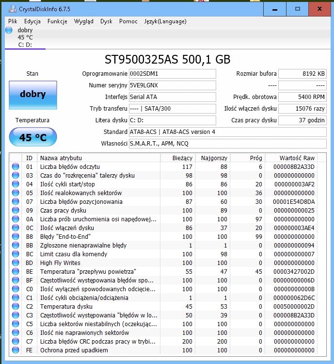

    and the system got up normally, but I put SMART with CrystalDiskInfo - maybe something
    happening with my hdd?

    Unacceptable shocks (BF) and disk not responding to commands (BC) - monitor for growth.
    Besides, ok.
