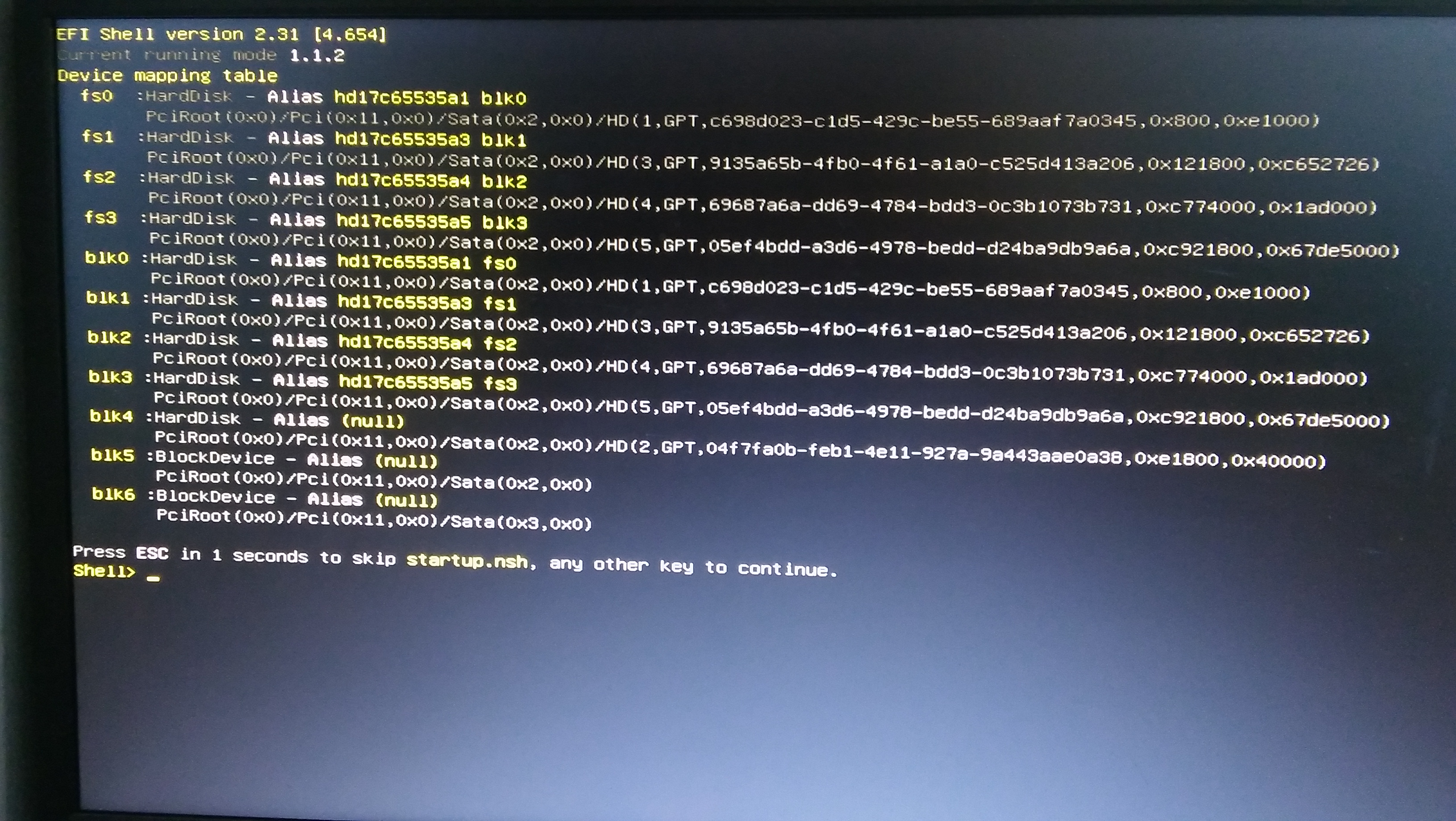

    It could be that until now you had a disk system saved in UEFI system, now you have reinstalled and you can have a LEGACY system. Try to find this option in the boot tab in the motherboard bios and move.

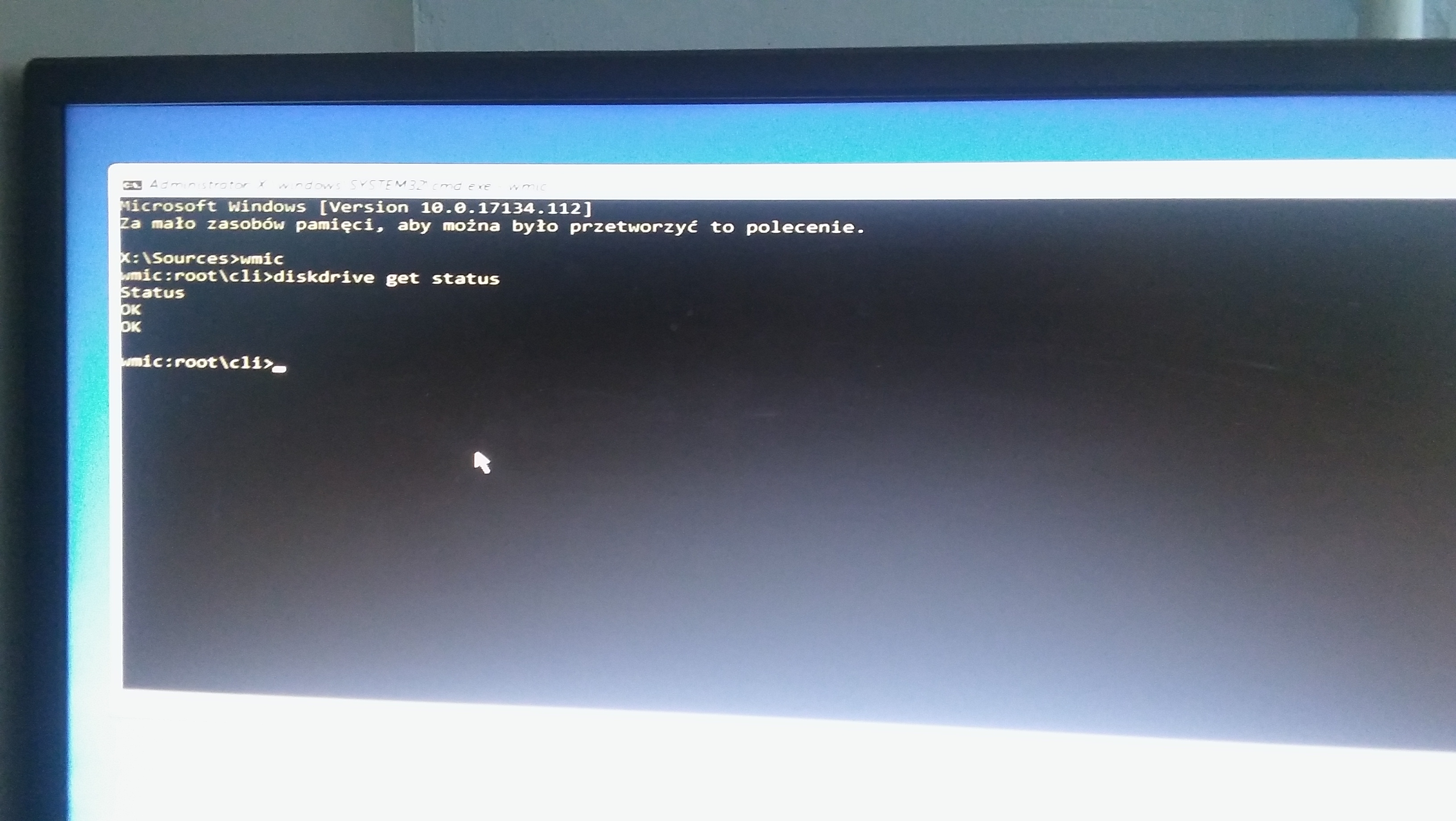

    Drive: Seagate Desktop SSHD 1000 gb GB
    How do I put a Smart disk if nothing but the motherboard logo turns on?
    Added after 13 [minutes]:
    Something like that is also displayed
    EDIT
    Here I made a Smart disk using cmd
    Problem with Windows 10 - The repair program at startup could not fix the ko

    This is not a SMART disk. It is only information that according to automatic checking the status SMART = ok, and we want to see each parameter manually,

    Record the bootable UBCD onto a USB pen and use the tool that suits you best.
    E.g. MHDD
