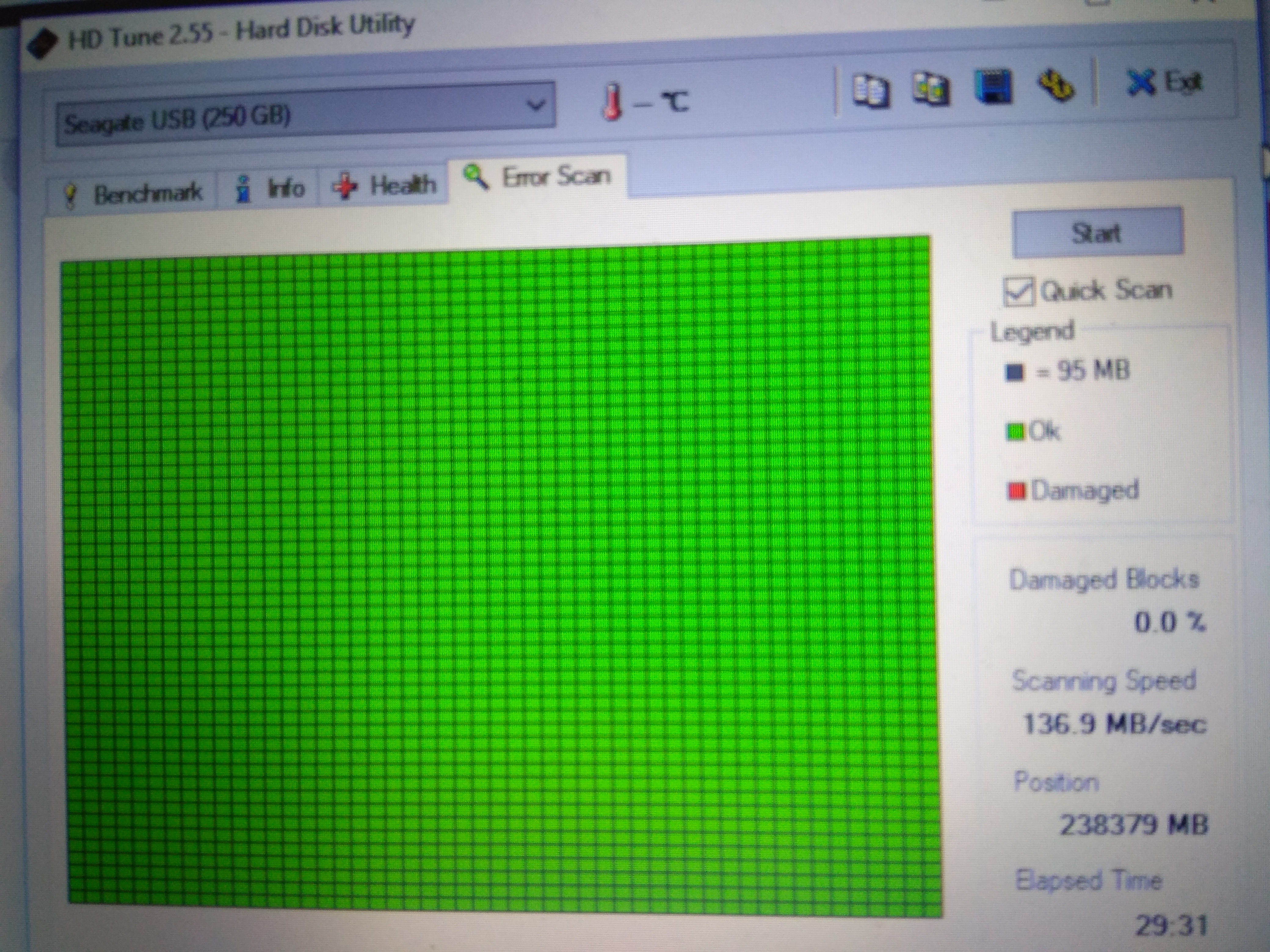

  • #6 16844251
    seba_230
    Posts: 7
    Connected to another computer via an adapter from a removable disk. I have scanned HDDTUNE and all green sectors.

    kokapetyl
    Posts: 13445
    Help: 1787
    Rate: 2101
    Nobody asked about colors.
    You've been asked for a SMART disk, since you have inadvertently used HDTune, then there is the "health" tab
    You have to use it and give the results in the form of a picture to us.
  • #8 16844298
    seba_230
    Posts: 7
    There is nothing on this disk on the Health tab, everything on the laptop disk.
