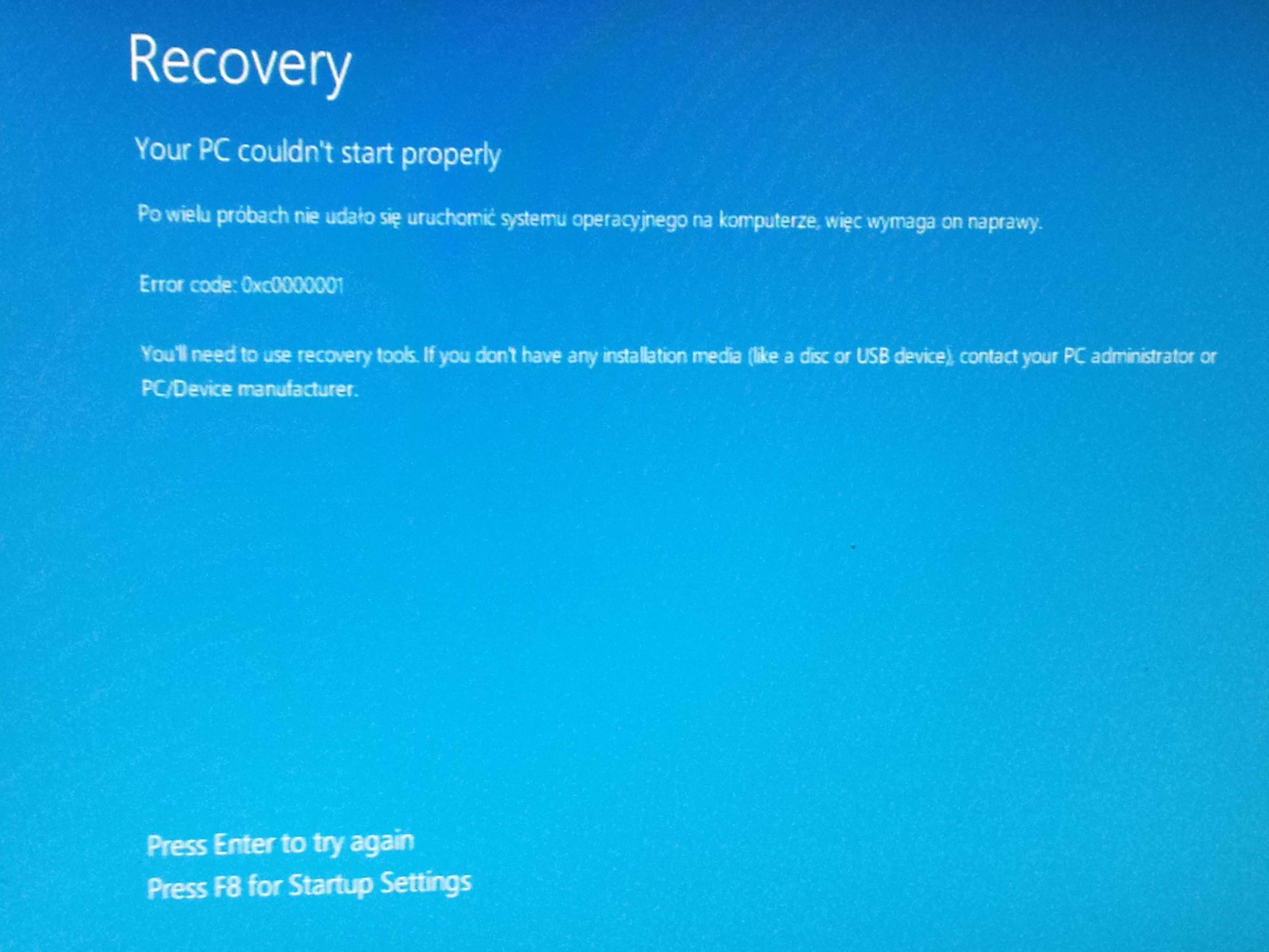

    Recently, I encountered a problem with my computer while it was turned on in the area and turned off the power. The computer turned off, the error 0xc000000f popped up on restart.
    Picture below. After clicking F8 there are several options to choose from, but none has the effect and each time appears the same.
    I will add that I have 2 disks 1SSD for the system and 1HDD for data.
    I managed this problem with a bootable USB stick and the commands bootrec / scanOs and bootrec / RebuildBcd. Unfortunately, after closing the command line and restarting the computer without a flash drive, another error code 0xc0000001 popped up now I don't know what to do about it, please help.

    Hello. Error code 0xc0000001 missing or corrupt winload.uefi.

    Can you fix it or do you need to reinstall the system?

    With this error, it would be best to download Win 10 from Microsoft's site to rip the ISO image to a disk or USB stick and reinstall.

    Reinstall system.
