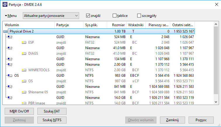

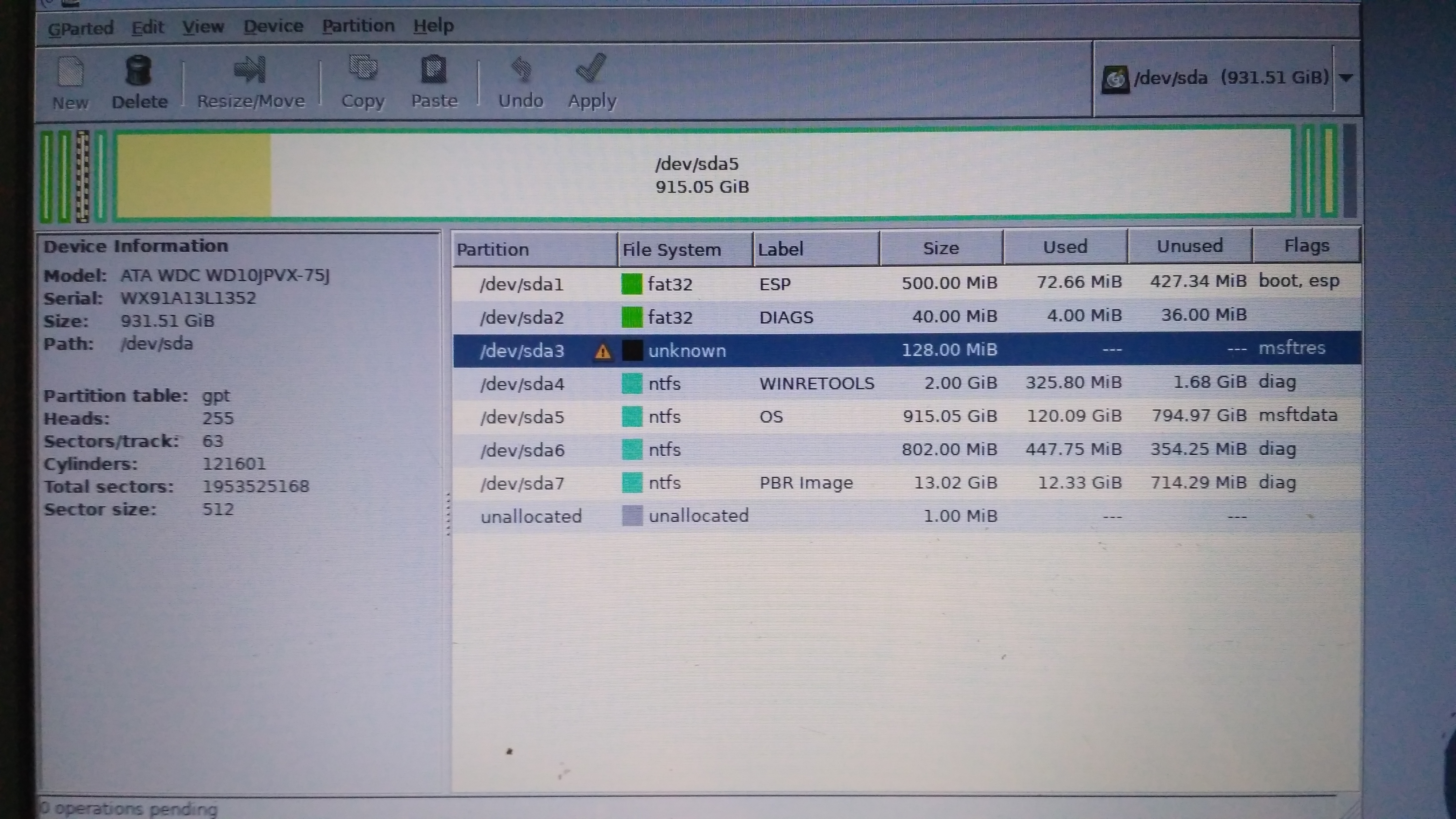

    I have a problem running Windows 10 UEFI GPT. Everything worked until the disk was removed, a copy of the disk was made in the "receipt hard disk manager" program, then a restored copy to disk, from that moment instead of starting windows appears Bluescreen 0xc0000034 (photo). I tried Win 10 automatic recovery from usb and CD (however both started in LEGACY BOOT mode because I couldn't boot in UEFI.) I tried to force booting from specific partitions in this recovery - also to no avail. Using Gparted, I changed the partition flags to active with different settings - no effect. I started the console at Win 10 startup with usb and tried Bootrec / fixmbr || Bootrec / fixboot || Bootrec / rebuildbcd found Windows at the last command but when trying to add it, the error "could not find the requested system device"
    I also tried this: LINK didn't help either.
    I have no more ideas what more I can try. Help me because the matter is quite urgent :(
    Picture below of the Gparted disk view.

    mati211p wrote:
    Copy uploaded to new disk or the same?
    The problem is that the same disk: /
    Therefore, at this point I have to somehow force the disk to boot the current system or, as a last resort, start the Recovery partition, but this is the last resort.

    This effect, probably not what we expected? The disk is still as HardDisk2 and the first partition is the 500 partition mb MB that I can't preview or mount.

    Michalo_007 wrote:
    The disk is still as HardDisk2 and the first partition is the 500mb partition
    (echo sel disk 2 & echo sel part 1 & echo assign letter = S) | diskpart
    tree / a S:
