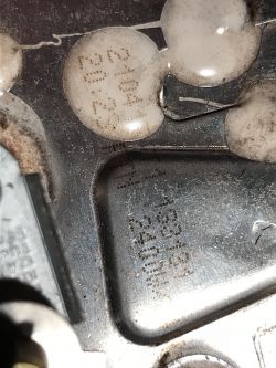

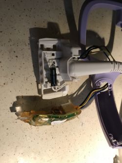

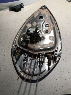

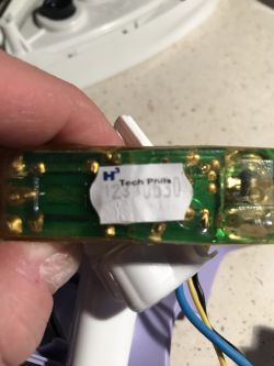

    I have a problem with the iron, namely it does not heat up. After plugging in, only the lamp next to the handle lights up. What could I check to diagnose whether the equipment is suitable for repair or in the trash. A few photos for a glance.

    How about checking the heater and fuse as it is?
    #3 17022750
    Pedros050
    Posts: 17914
    Help: 2471
    Rate: 3926
    Hello. Start by checking the heater for resistance?
  • #4 17022815
    voytekg
    Rate: 14
    I have a transition between the two middle pins. What else could I check and where to look for it?

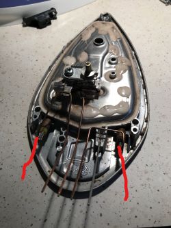

    #5 17022829
    antek124
    Level 32  
    Posts: 1582
    Help: 196
    Rate: 146
    Between the first and third from the left, and skip the thermostat.
    #6 17022869
    Pedros050
    Posts: 17914
    Help: 2471
    Rate: 3926
    I marked where the heater is. Tefal Aquaspeed 5335 Iron Not Heating Up: Troubleshooting & Repair or Replacement?

    I checked the heater resistance, 24.7? Maybe it was this electronic module that fell
    This fact usually ranks first in the category of damage, not for amateurs (unfortunately) ... The heater works for five seconds, etc. well, but in my opinion you will not check the electronics. So judge for yourself how you see it :D

    Well, it turned out that something was blocked in the module, namely two small balls that disconnect the heating if you do not iron. The iron works. Thank you for your help. I consider the topic to be resolved.
