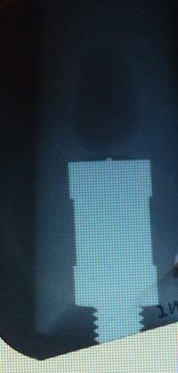

    Adamcyn wrote:
    mich1al92 wrote:
    The previous radio was Kewnwood. I do not know if it was factory
    I am asking because only the factory radio gives voltage to the antenna amplifier - if there is one.
    Connect e.g. a 50 cm rod instead of a whip.
    I once bought an "empty" antenna; below is an x-ray picture.
    Pioneer Radio Reception Issues in Octavia I: Antenna Performance Outside City
    And ride with a rod instead of an antenna? The antenna was bought shortly after the radio, but on my old antenna or an antenna from another car, the radio also received similar "strong" ..
